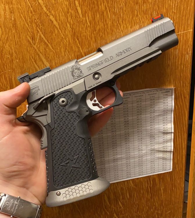

It’s been a while since anything happened with my Hi-Capas. I’m almost tempted to say I’m happy with them.
In reality, of course I’ve got stuff on the way, but UPS is just giving Kyle the run around for now.
To assuage my boredom, I thought I’d try a couple of these. AIP Limcat Mag bumpers. Now my obvious Airsoft Autism can cool it’s jets again that the mags are “correct” - Limcat bottoms and STI trades to go with Limcat slide and STI frame. Got some Infinity ones on the way for my SV mags

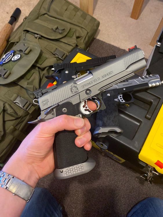

I went back to the van earlier to check my messages in between games and saw! The Battlecat 4.3 is finally happening
Had an awesome game today, my Capas were behaving beautifully. The AW drum mag I bought seems to have a slow leak somewhere, nothing a bit of grease can’t solve
New slide, frame and some 9ball routers enroute. UPS finally let Kyle have his stuff

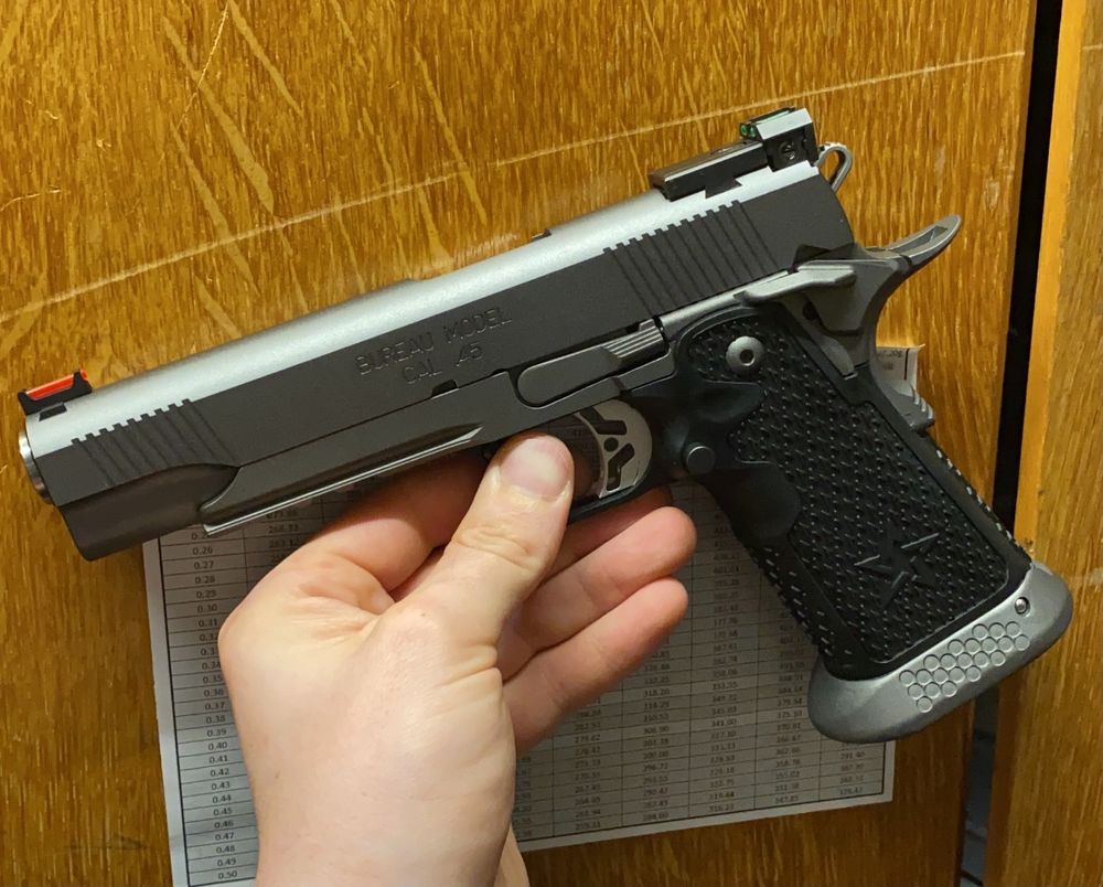

The Novristch, like a beautiful butterfly, has metamorphosed again...

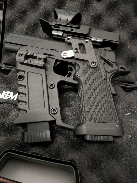

Something a bit different arrived from the states today. It’s a Nova style grip and I think it completes the pistol-formerly-known-as-Novristch nicely!
Whoa you completely evolved your novritsch ssp1 into another hicapa, I only did some modification on my ssp1 hicapa, I make like a kriss vector like ssp1, all exterior modification. Also I bought a combat master slide, still on shipping so far, hope it can fit my ssp1. The kit I use is from dark matter works(https://darkmatterworks.com/product/hica-grip/) team, the scope mount is from 5ku + cmore scope  16233421717154245618705314034074.thumb.jpg.500d07b99c8575f27e6d0e9343a7bb94.jpg
Edited by Marquischan0218
