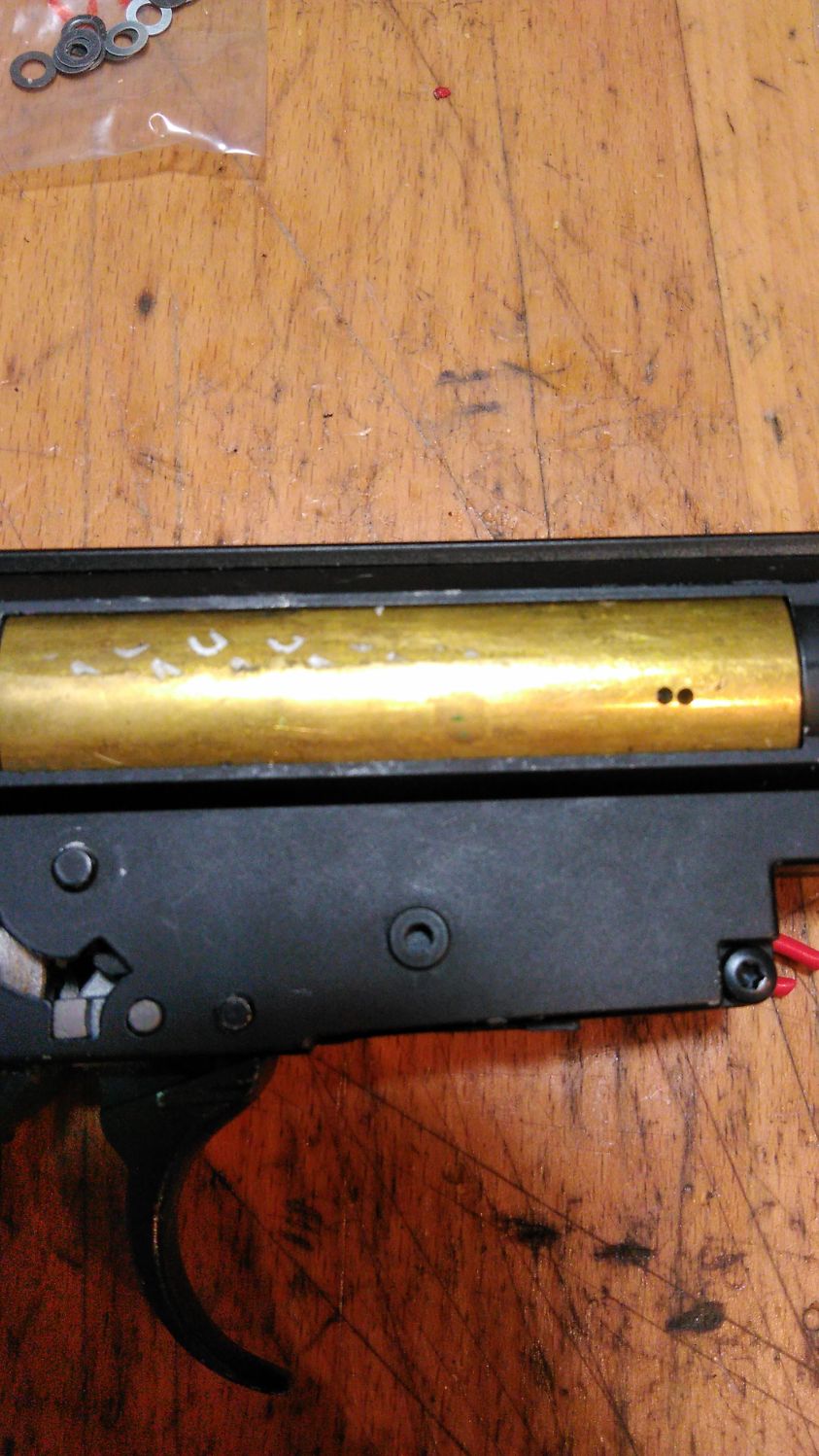

40 minutes ago, Adolf Hamster said:
gun had been "downgraded" by drilling a hole in the cylinder
It's a quick and cheap way to reduce the energy. don't see anything wrong with it (if done properly)

& other gearsets work better in other boxes....
eg: sometimes SHS 13:1's roll really smooth in many boxes
& sometimes the cheaper ZCI/BD/XYZ 13:1's roll smoother
(the bevels in cheapo 13:1's are a bit more miss than hit I'll agree)
my theory is that some boxes have those 3 axle holes set slightly different and in certain instances
some gear sets may allow the 3 gears teeth to engage too deeply and almost bottom out
suffice to say you get more gear noise as they mesh a whisker too deeply
(or at least until they get "run in" a bit)
yeah tell that "if done properly" bit to G&G on their HC05 FH...
NO THAT WAS NOT MY WORK - how it came from G&G
& it was not finished very well - some twat just got a Black & Decker
and went - fuck it, about there roughly should be about right-ish
left the inside as rough as fuck, maybe went over it from outside with round file
but inside was burred a bit, a really bodge indeed
(that is before I did my own bodge up on it)
3 minutes ago, Sitting Duck said:
G&G being G&G
Heh, that is a shit job.
The one I did on both my amoebas was fine though. Still drilled, but I did it very carefully and removed all the burrs on the inside.
Also I used a 3mm bit so the hole is tiny.
Quick and cheap are literally the only positive things about it, totally fucks with your consistency and means you're swinging a strong ass spring for no benefit (at least with short stroking the gun gets snappier)
It'll make the piston slap hard too, the g&g's piston head was gone because of it.
As far as i'm concerned its a way of ruining the gun because of lazyness.
Edit: for clarity i aint talking about porting, theres a good and valid reason for that, i'm talking bout this shit:
It's common practice here, whereas short stroking isn't really used unless the customer asks for it.
Not that I care much about these kind of things as I do 99% of my own repairs (bar a couple of things I just don't have the tools nor the money/space to buy and use these tools).
Moreover, 99% of the people who send their guns to techs are the kind of people who know fuck all about internals and are usually cheapskates who want a job done quick and cheap.
The ports I drilled were placed exactly where a 3/4 cylinder hole would be, so no hard slapping or anything. On the other hand I've seen some pretty awful ports that were drilled literally a cm away from the cylinder head, now THAT is an easy way to destroy a piston/cylinder head.
i've only seen it twice, both cases it was a box with a way strong spring.
needless to say you change the cylinder out to an un-drilled one and install a correct strength spring your accuracy sees a slight (read: massive) improvement, the box in that pic ended up an absolute demon when it was done.
suppose it's a case of what is the gun being used for, if it's just a cqb peice then likely the user is never gonna notice but i'm still not a fan.
installing a weaker spring or short stroking is the much better alternative, less stress on the gun without sacrificing accuracy.
