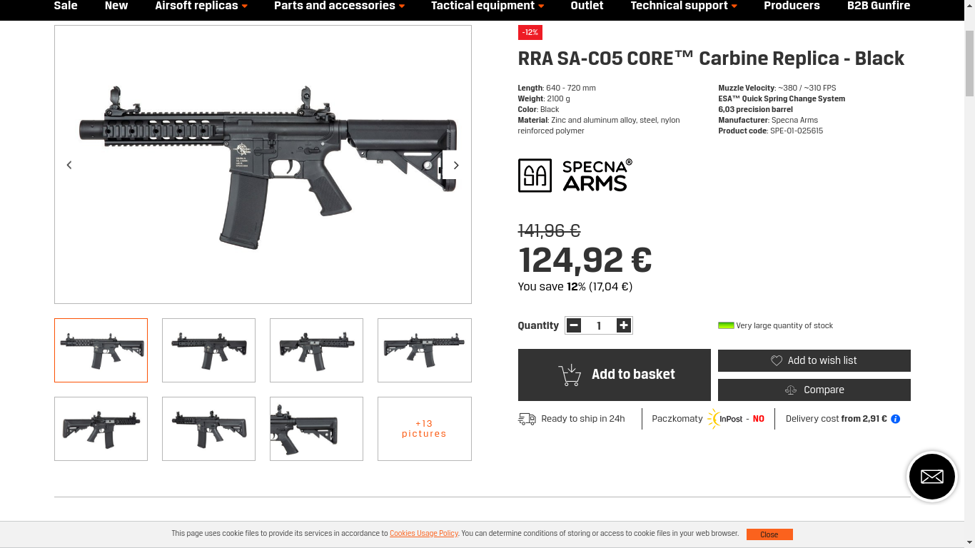

EDIT - maybe the C05 with 12%  off GF-SLADEAIRSOFT-163
comes out at € 124:92 plus GF shipping (and fees like paypal - bastards)
maybe near € 140 but maybe one of cheapest options...540829333_Screenshotfrom2020-10-0814-03-53.thumb.png.649e48dbed90234bd7dfaf8c932bab9d.png
That is about my best option, nice length, suppressor/flash hider looks just right at the end

https://gunfire.com/en/products/rra-sa-c08-core-tm-carbine-replica-full-tan-1152221427.html
This is what I've settled on.
20 grams heavier than the C-05 (2120 vs 2100), €5 more expensive, but has a full length barrel (the c-05 uses the suppressor as a inner barrel cover) and overall I like it more than the 05.
The rail is keymod, but heh, no biggie, i also have this stuck somewhere between china and my shitty customs on my way (in Bologna as I type), which I reckon will bring the overall weight down to sub 2 kilograms at full load (I'm pretty sure the weights listed include the empty magazine and battery) and still fit because it's half an inch shorter than the outer barrel.
