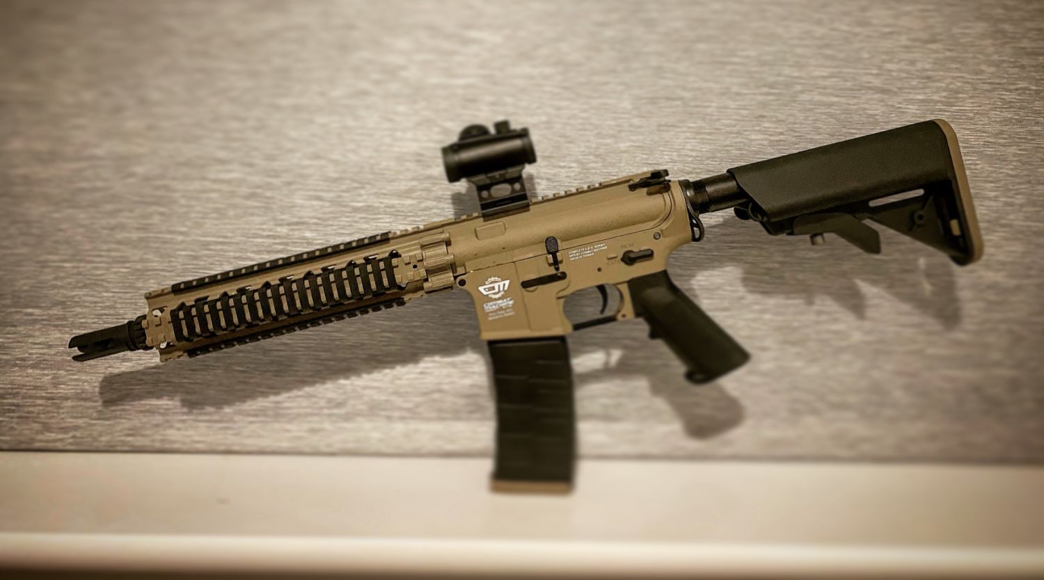

Shenaf Posted August 29, 2020 Posted August 29, 2020 I’m wanting to change my inner barrel from the standard 6.05 to a 6.03 in my G&G CM18 Mod1. The current barrel is 375mm. I’m struggling to find a tight bore at 375mm. Is it worth going bigger and adding a mock suppressor to cover the inner barrel. Thinking like a 450mm. Also looking a r hopping as well, possibly looking at changing the hop up to a Maxx unit. Can anyone offer any advice. Thanks in advance
