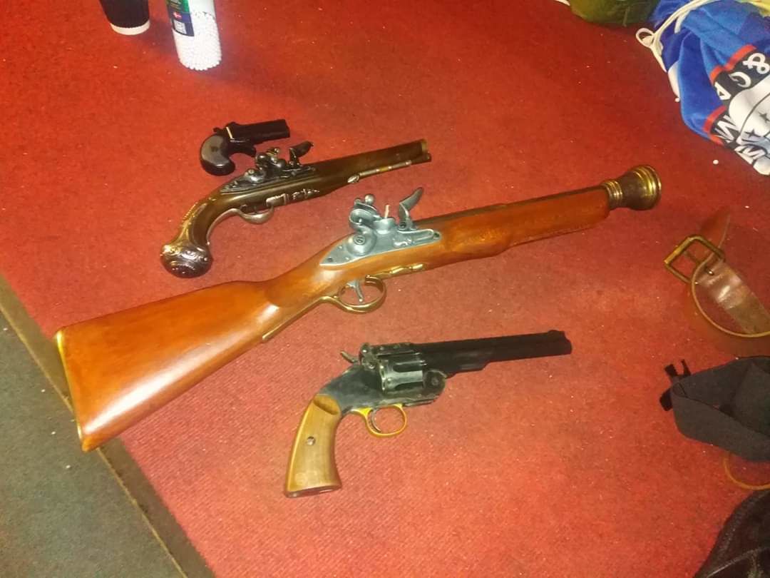

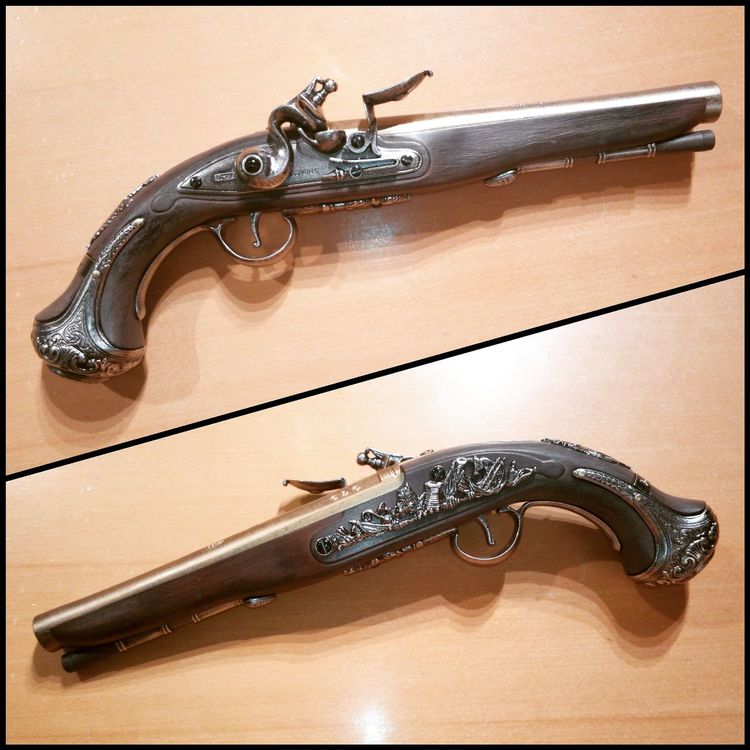

1748 George Washington pistol, a ktw Springer.
1760s type british naval musketoon, a Denix that's been modified. Fires 20mm madbull shells, gone.
1866 Remington derringer, marushin, gone.
1869 S&W model 3, ASG. Low power shells, modified to have a tm vsr barrel, and a maple leaf hop rubber. Shoots very well but really fussy on bbs.
Got the GW. Did a little work on the fake wood and gold on the barrel like the real one. Will have to get my derringers out.
local shop did an interesting martini henry build firing the APS shells.

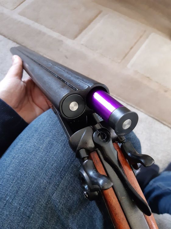

Just got in, this has arrived too.

Battle orders by any chance got one in the mail my self.
No, be careful as the uk ones now have a locked in place barrel, it doesn't split. Hopefully yours isn't a new one its older stock.
Just re looked at the advert shit. I have some machine work to do when it arrives

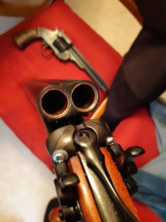

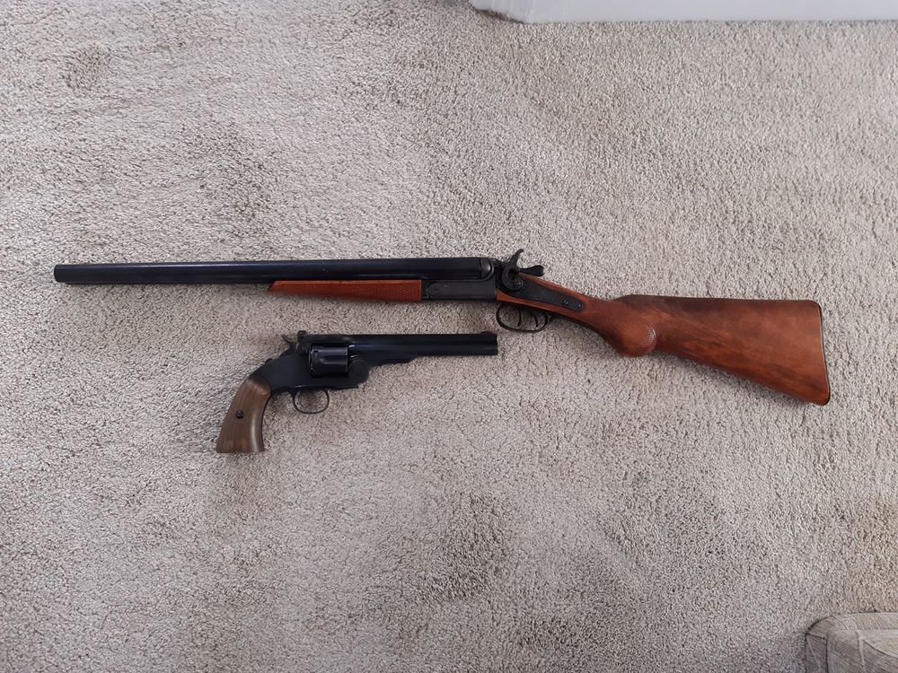

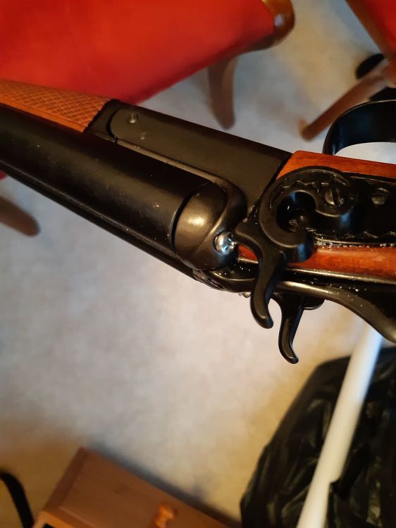

Well I've finished the conversion.
Just some tidying to do now I've fine tuned it a little.
I ended up having to recess 2 bits of 22mm copper into the barrels, they are friction fit, they took lots of careful but forceful tapping. Otherwise the shotgun shells pushed into the barrel when hit by the pin rather than set off.

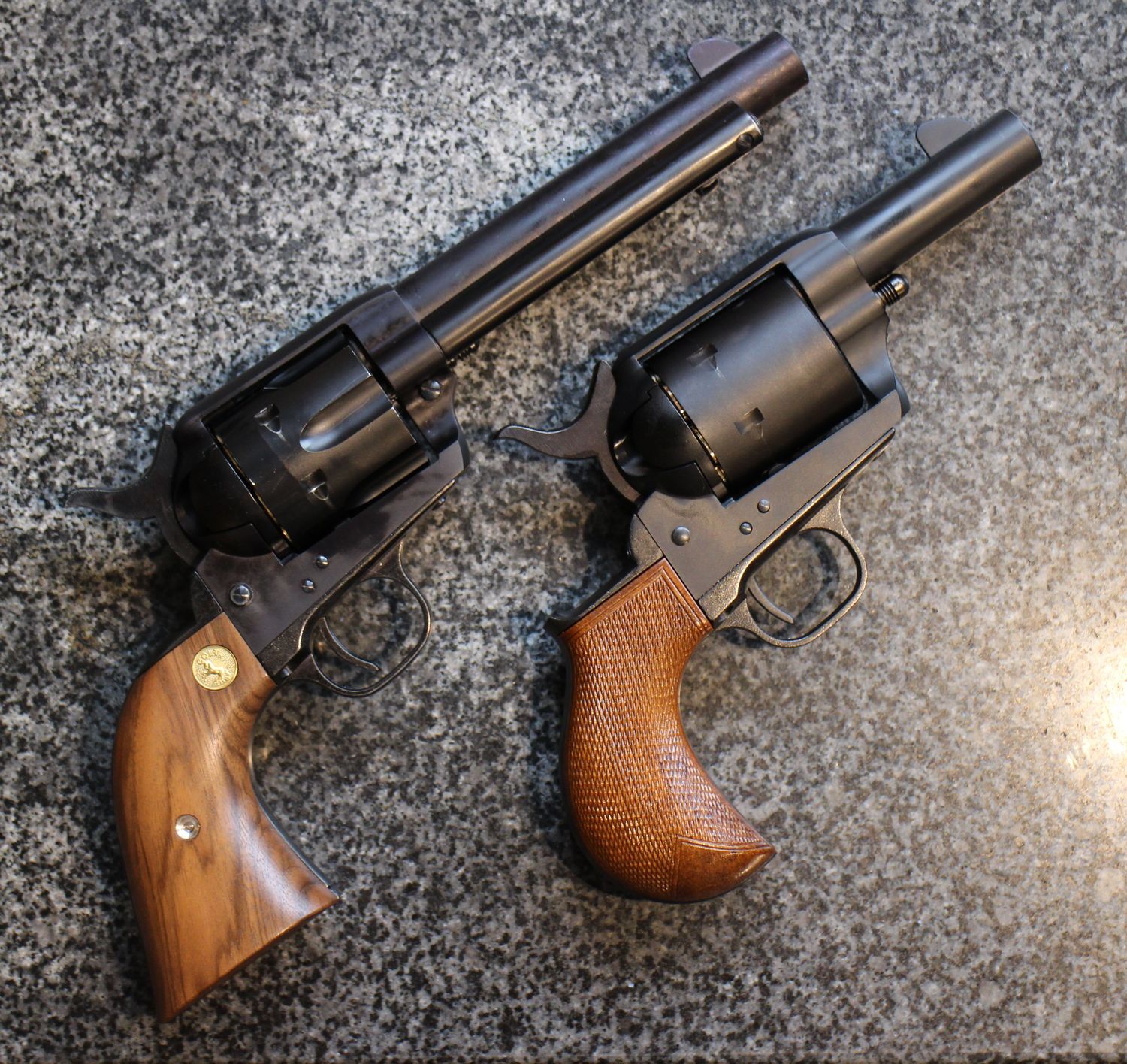

Thats me, Ta bud. There's 7/12 bisley in the classifieds. Not my cup o chai but I'm now tempted that I've got the ones I want. Plus I could tune it up to 500fps as a long range gun. Please buy it before I do.
I'm not keen on the bisley. Wolf Armouries have them new for 170 quid.
I'd ideally like a hws 1858 with the pegasus system. I just want a period revolver carbine. Just because I remember seeing one on a wall as a young kid and thinking it was amazing.
I like the hws new model army too. Not easy to find sadly especially the carbine. You may find it disappointing on the performance front though. Has no hop like the KA SAA.
