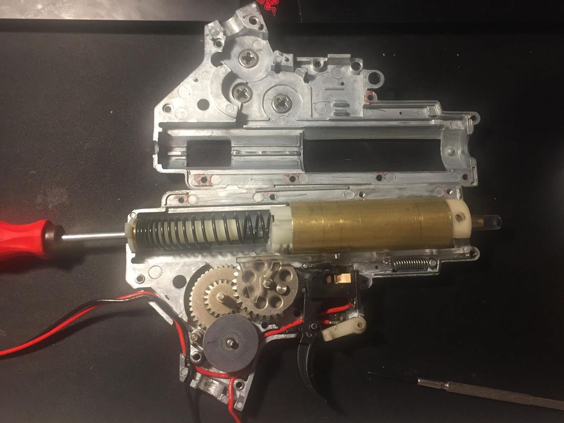

Hi all again, thanks for your replies.
Just a couple of things, yeah the spring is most definitely in and behind the piston! With the spring guide behind that.
@Sitting Duck - it is a shoddy cyma v2 well done! Everything about it you said is bang on, down to the crappy safety screw.
Here is the gearbox as is, straight after opening, the piston has since shot back down, so perhaps it was jammed on what i don't know.
With everything removed but the piston, cylinder and cylinder head and the case closed, the piston slides up and down freely.

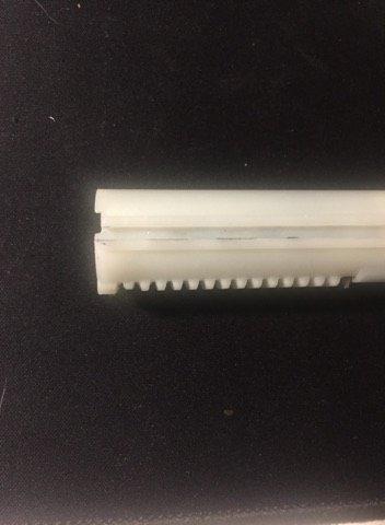

Above is the piston in the same orientation as the gearbox picture
Below is the piston on the reverse side, it does have a few small grind marks, which i noticed looks like it has come from the lower section of the sector gear (that connects with the spur).

I did (and still do) have a lot of trouble with the AR latch as it always pops out and doesn't sit still, but when it's in, it flicks back up as it should.
I have reduced the size of the spring by a coil-length in the past and have searched for a replacement just in case that was the issue, but the website says it has an M120 as stock which must be a load of rubbish as the M120 i bought is far too powerful, looks nothing like the current spring and buckles when released.
could be the spring jamming, i've had that before when changing spring and the spring diameter was just so that when it expanded under compression it jammed inside the piston.

I'm amazed the teeth didn't strip, the piston must have twisted somehow
but play close attention to the actual teeth on piston say 75% along

***** UPDATE ****
JUST HAD A THOUGHT .....
'ere - when you refitted all this together....
Did you drop or did it slip
That tiny tiny metal disc that adjusts motor height on cheapo guns ???
I'm wondering, if the disc slipped off, the motor height dropped
then the box started to wind back the piston a bit without too much stress
then all of a sudden, the strain increases and the motor is too low from a slipped disc
The whirring wasn't the piston stripping, but a low pinion munching up the bevel
THAT could be what was clunking and crunching and jumping - motor height out
coz the tiny disc slipped off and motor dropped about 1.25mm, failing to mesh properly
yeah - more I think about it, that is a possible scenario of how it went pear shape
and sounded/performed real shit
yup the more I think about it, either shims fell off bevel and bevel pinion height changed
disc fell off motor altering motor height
pistol grip/plate not fitted correctly - careful plastic threads strip easy on cheapo guns
somehow the motor height/bevel pinion altered
which it really shouldn't have, but something changed
the bevel/pinion start knocking shit out of each other
(they might be a bit worse for wear now, but not too bad if you just tested briefly)
All that, struggling to cycle gun, it reached 75% retraction, but sector never spun anymore
whilst pinion & bevel start fighting, so the sector or gun never cycles
and THAT is why piston was not released as expected coz motor is no longer turning drive chain
yup - that is my final summing up I reckon says Ace Ventura....
Image result for ace ventura patio door gif
Answer is right there.
No lubrication.
@Sitting Duck is very right about the Piston and the spacers.
The piston and gears need grease. Without it, the friction of the spring pushing the piston upwards on the slides can and does lock up the piston. It only takes the piston been a little slower due to this and you cause the piston to get picked up partway through the next cycle. All of a sudden the piston is rammed as far back as it can possibly travel then gets crushed upwards.
You lube all moving contact points, Even if it's just a light smear. This includes all O-rings, Bearings, and anything that moves at the points where contact is made.
I suspect the piston is now scrap and needs replacing. It may look good but the pre-engagement will have damaged/weakened the piston and it'll be prone to failures and problems. For the sake of a few £ for a new one from AK2M4 it's just not worth putting back in the gearbox. Whilst you are ordering a piston also order some grease!
