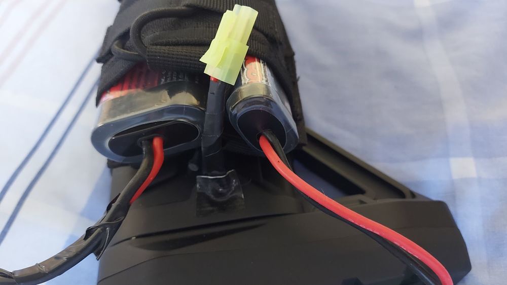

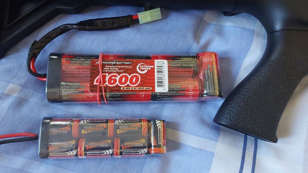

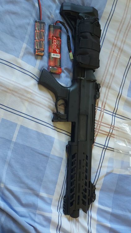

Nuttycapri Posted August 21, 2019 Posted August 21, 2019 My SGR12 says ONLY use a NIMH battery - do NOT use lipo batteries. So I can just squeeze a 1600 NiMH battery in the stock. Asked the owner/technician at my site why this was and he said it was to do with the internals and built in MOSFET. Prolonged use of a lipo battery will damage it. Must admit fully charged I get 1 game out of it before a battery change. I'd call that a design fault ?

Nuttycapri Posted September 15, 2019 Posted September 15, 2019 To clarify from Dealer - do not use lipo, although it will work for a while, eventually it will blow the internal MOSFET. Showed me the manual and an email from manufacturer. The price of a new MOSFET is around the £300 Mark for this model. A 1600 NiMH will fit. So I have 3 in total to last the day. All good brands, no rubbish. So I will stick with what the manufacturer recommends as any damage caused by using a lipo is not covered by warranty.
