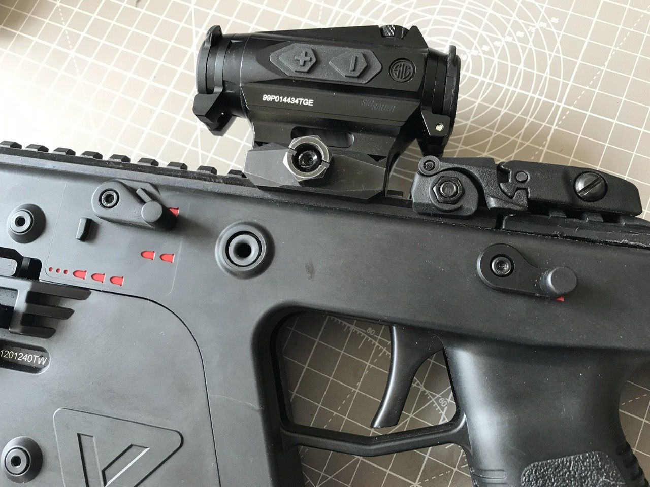

0742C55E-E4A9-4EAE-A69F-95281EF09BA1.thumb.jpeg.45b1f4fe2ec8921d253d38af798c37ae.jpeg60580FCC-0FBC-49FA-8A14-B85754EA365E.thumb.jpeg.3d1202a7b6c950971764bfffaf04af24.jpeg
These two are clones, but I have dulled the text on the UH-1 and sprayed it with mat lacquer so it looks less Chinese lol

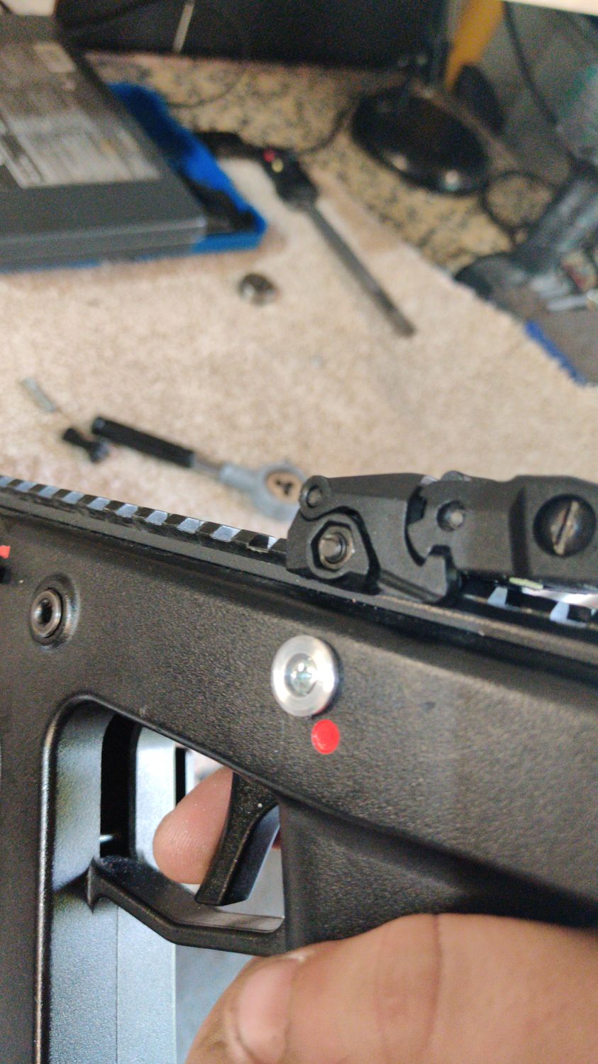

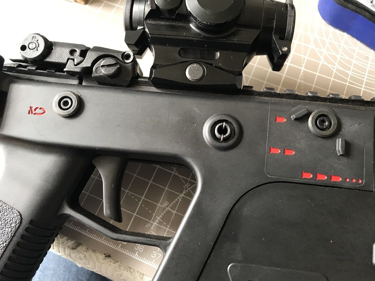

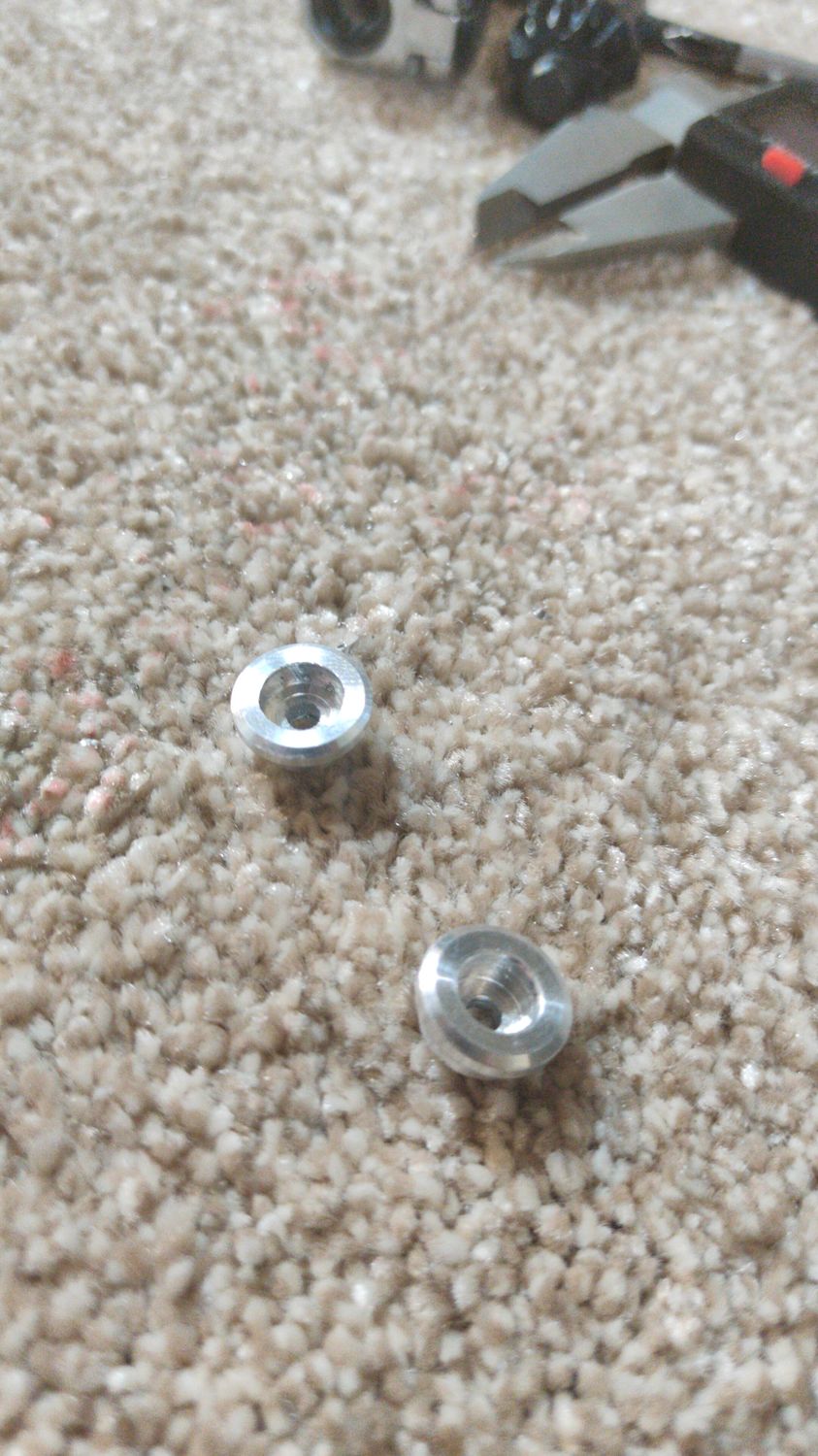

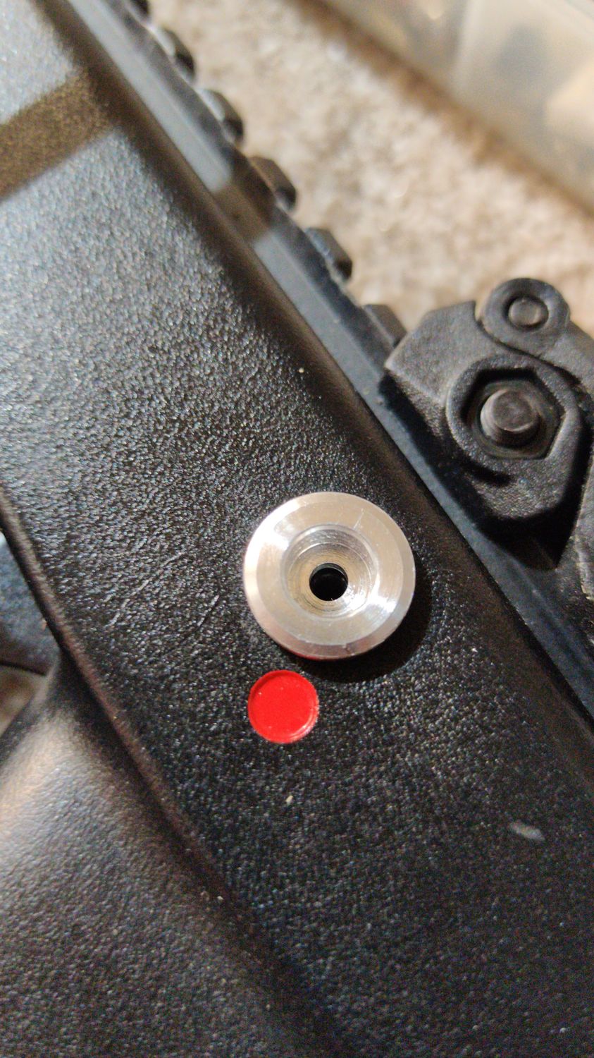

Made up a set of safety deletes for the vector today🙂

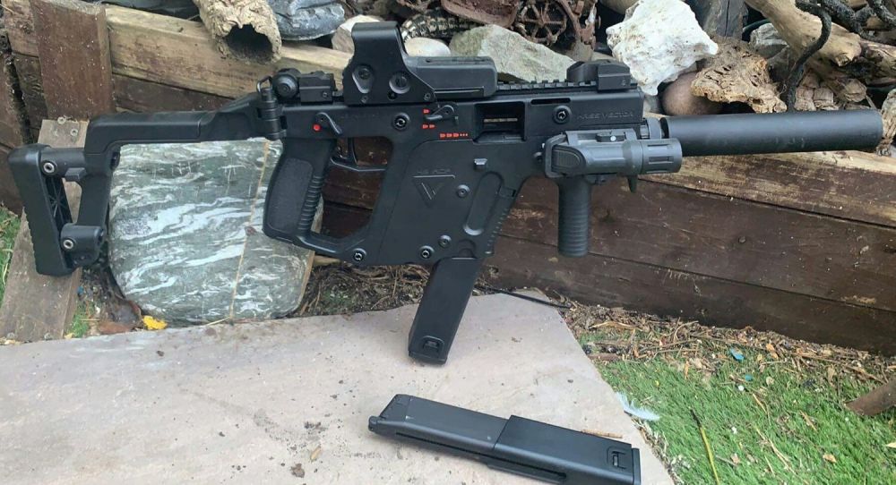

Hi guys. I’ve recently got my hands on a Vector.(finally!!!) It only came with two mags, I’ve been looking  at getting some from Rainbow 8. Does anyone have any experience with these mags? Are they any good? Is there anywhere else worth getting them from?! Thanks in advance! Tom.
Both Rainbow8 and KWA-USA have the mags, genuine KWA, just without trademarks.
Oh, and a pic please 🙃
Awesome, I ordered one from Rainbow 8 a few weeks ago, but I’m away so yet to test it out! Thought I’d ask here before buying more!!😂 here’s the only picture I have so far, I’ll be sure to upload some better ones once I get back and get her set up nicely!!
thanks for your help!!
