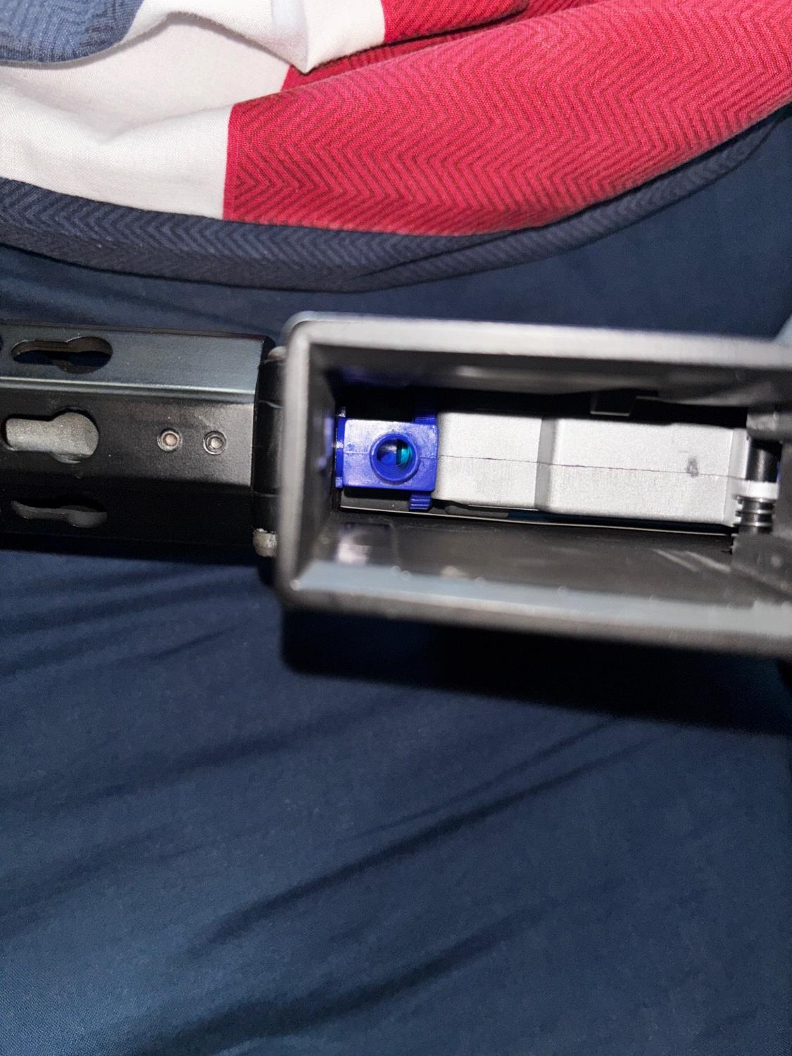

Also i noticed my first shot after loading in mag doesn't fire anything the nozzle seems to be pushing forwards a little bit, could it be the cause of new piston?IMG_1561.thumb.jpeg.45c363f60a68129e6dcf638d34f4d3ff.jpeg

In regards to the air nozzle sticking out is that normal?
Nah, piston has no part in this.
The nozzle resting position is set by the position of the sector gear after a shot, the position of the tappet cam, the dimensions and shape of the delayer if present and the shape of the tappet plate.
All my guns have the nozzle fully forward when in their resting positions, others have it fully retracted, most guns have it somewhere in between.

i see it doesnt really affect functionality so i'll just stick with it
