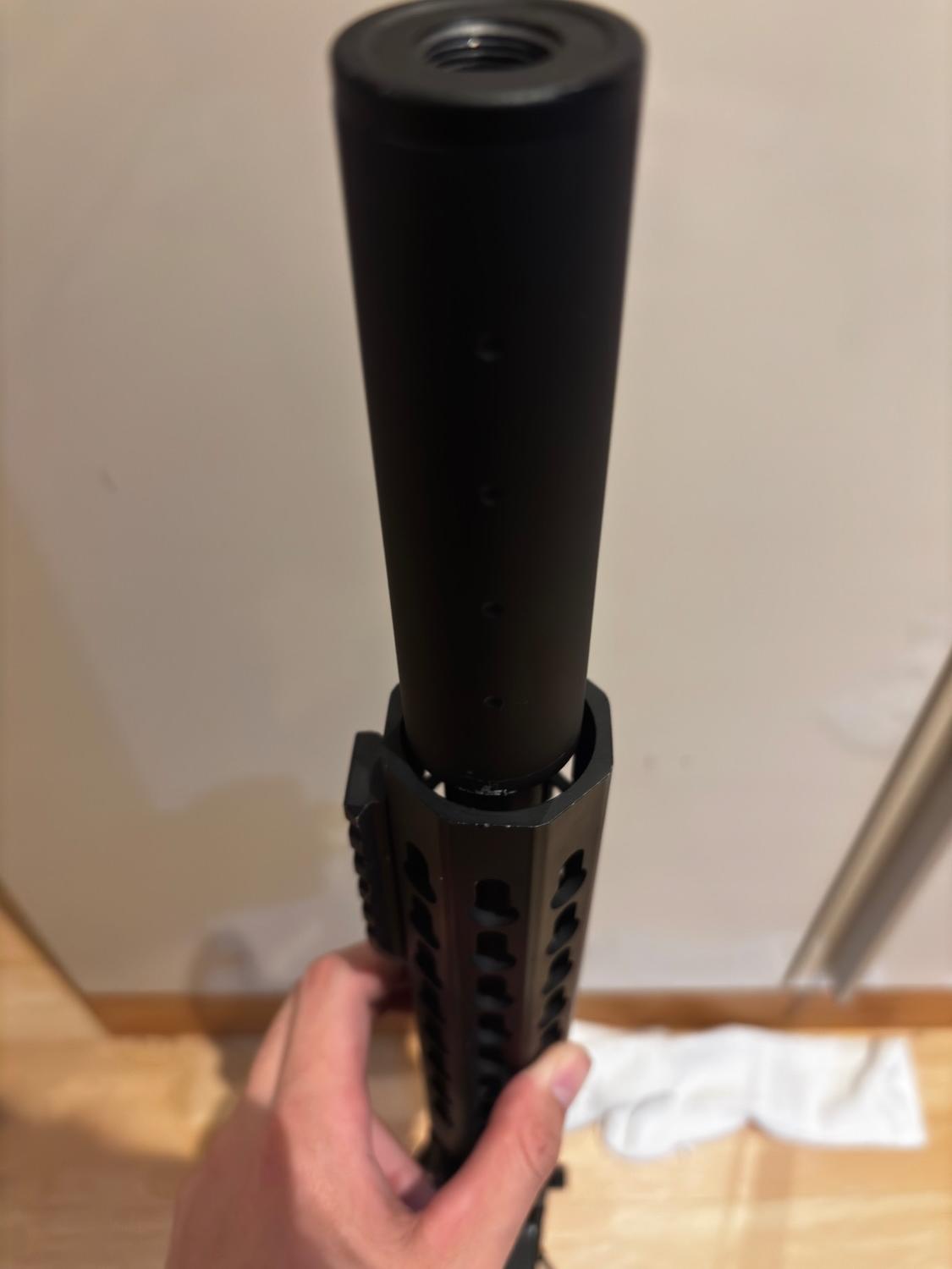

Just got my first gun and shimmed it following tutorials. However after reassembling i notice the outer barrel of the gun isn't sitting in the centre of the handrails, it's not loose or touch the sides, just doesn't sit in the very centre. Was wondering if more experienced guys in here would know if it affects accuracy performance etc?
I'm unclear, did you disassemble the upper / handguard and do anything with the outer barrel?  Or was it already like that?  Do you have a picture of how badly it's off centre?
No, i didn't mess with that part of the gun, i had only taken apart the gear box and rearwards of the gun.
Heres a picture taken from the centre, it might be unclear, but you can kind of see a wider gap on the right than the left, does it really matter? The handguard also wobbles very slightly, unnoticeable when playing.

The problem might be two parts:
1. outer barrel not center / sitting correctly / tightened in the receiver, and/or
2. handguard not center / sitting correctly / tightened in the receiver.
1. To align / center / stablize / rigidify the outer barrel you can shim the insert area (which goes into the receiver) like this:
You want it to feel a little difficult to insert, but once it's in and tightened, it should be very solid.
2. To stablize the handguard I guess you can try tightening the nuts and/or barrel nut to see if it stops wobbling.
If not there are some aftermarket "barrel nut shims" you can put on to tighten it further.
Whether it affects accuracy: yes in a highly controlled environment, but probably will not affect you meaningfully in an actual game.

Barrel not being aligned is pretty common, maybe one of the three handguard retaining grub screws is tighter/looser so it pushes the thing out of alignment.

I seem to only see tiny allen screws on the sides and bottom of handguard, can't see any big bolts that seem to be holding it in would i possibly be on the inside?
Nope, it's only those three grub screws.
Luckily it has anti rotation tabs which effectively lock it in place and prevent loosening.
