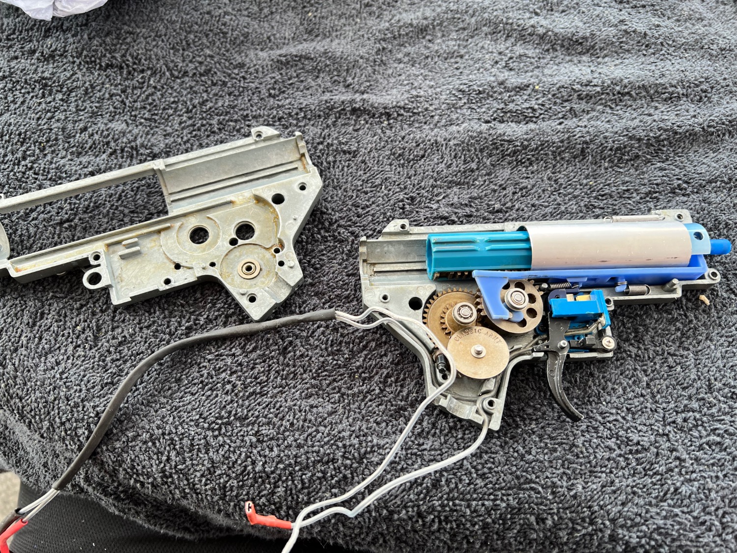

Pollynator_bravo2 Posted August 5 Author Share Posted August 5 3 hours ago, Colin Allen said: The nozzle is not fully engaging with the hop rubber lips. Is the hop unit pushed fully back against the gearbox? If it isn't, use some O rings in front of it to push it back. If it is, try longer nozzles or get a variable nozzle. It’s a weird one as I grabbed the old gear box that came out of it and serviced it fully. When I opened it up the tappet plate looked different. It has a moon shape on the tail end and there is a delay chip however the nozzle is shorter than what I had in the eon gb. When I fitted it all back together (with a clean inner barrel and bucking) I got 335 fps and 1.28j (no hop applied) 🤦♂️🤷🏻♂️ I guess this is an easier problem to fix the the latter lol images are of the gb that came with the gun when I brought it 2nd hand Link to comment Share on other sites More sharing options...
Colin Allen Posted August 5 Share Posted August 5 51 minutes ago, Pollynator_bravo2 said: It’s a weird one as I grabbed the old gear box that came out of it and serviced it fully. When I opened it up the tappet plate looked different. It has a moon shape on the tail end and there is a delay chip however the nozzle is shorter than what I had in the eon gb. When I fitted it all back together (with a clean inner barrel and bucking) I got 335 fps and 1.28j (no hop applied) 🤦♂️🤷🏻♂️ I guess this is an easier problem to fix the the latter lol images are of the gb that came with the gun when I brought it 2nd hand That seems to be the best way forward. I have never seen a tappet plate like that before. Link to comment Share on other sites More sharing options...

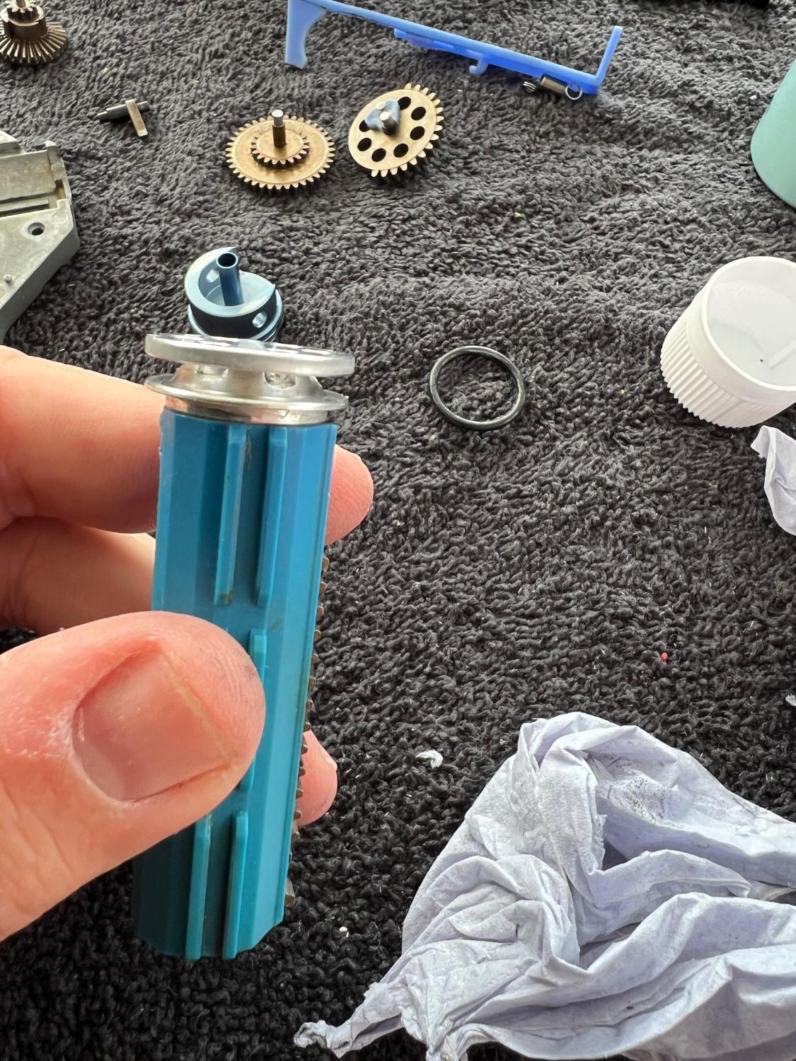

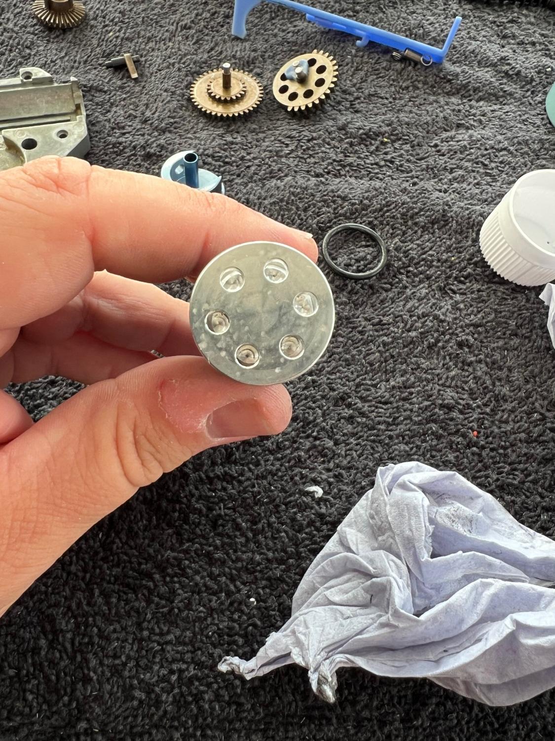

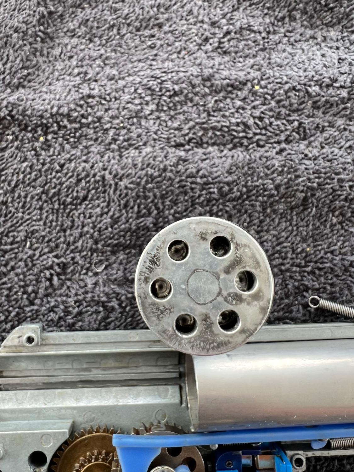

Supporters Lozart Posted August 6 Supporters Share Posted August 6 13 hours ago, Pollynator_bravo2 said: It’s a weird one as I grabbed the old gear box that came out of it and serviced it fully. When I opened it up the tappet plate looked different. It has a moon shape on the tail end and there is a delay chip however the nozzle is shorter than what I had in the eon gb. When I fitted it all back together (with a clean inner barrel and bucking) I got 335 fps and 1.28j (no hop applied) 🤦♂️🤷🏻♂️ I guess this is an easier problem to fix the the latter lol images are of the gb that came with the gun when I brought it 2nd hand Wow, that is OLD! The different design of tappet plate would certainly account for what you're seeing. The fix will still be a longer nozzle though as you can't get tappet plates like that any more. ak2m4 and Colin Allen 2 Link to comment Share on other sites More sharing options...
ak2m4 Posted August 6 Share Posted August 6 3 minutes ago, Lozart said: Wow, that is OLD! Jurassic Army. Look at the size of the vent holes in the piston head. Length of the cylinder head shaft looks quite long as well. Looks all nice and clean, cheap to fix up and run Lozart and Colin Allen 2 Link to comment Share on other sites More sharing options...
Supporters Lozart Posted August 6 Supporters Share Posted August 6 3 minutes ago, ak2m4 said: Jurassic Army. Look at the size of the vent holes in the piston head. Length of the cylinder head shaft looks quite long as well. Looks all nice and clean, cheap to fix up and run I was just thinking that, it's in bloody good nick for its age! Link to comment Share on other sites More sharing options...
Colin Allen Posted August 6 Share Posted August 6 1 hour ago, Lozart said: Wow, that is OLD! The different design of tappet plate would certainly account for what you're seeing. The fix will still be a longer nozzle though as you can't get tappet plates like that any more. He could try fitting a standard tappet plate and seeing how that goes; it might still need a different nozzle. Lozart 1 Link to comment Share on other sites More sharing options...

Pollynator_bravo2 Posted August 7 Author Share Posted August 7 On 06/08/2024 at 10:38, Lozart said: Absolutely, other than being drier than a nuns fanny it seems to be in pretty good nick. That was before being cleaned and lubed up. Was wetter than Gemma Collins mouth in greggs On 06/08/2024 at 12:59, Colin Allen said: It is surprising how good some gearboxes look after a long period. I opened up the lad’s blowback G&G AKM on Sunday to deal with a low power issue, after it had not been opened for many years. Apart from a worn piston head O ring, it was pretty much perfect. it was still a bugger to do due to the stupid pneumatic blowback system. What’s the correct O ring size for the piston and cylinder head ? Rogerborg and Lozart 2 Link to comment Share on other sites More sharing options...
Colin Allen Posted August 7 Share Posted August 7 (edited) 1 hour ago, Pollynator_bravo2 said: What’s the correct O ring size for the piston and cylinder head ? Cylinder head is generally 22mm OD, 1.5mm cross section. Piston head is generally 24mm OD, 2.4mm cross section AK2M4 sells some slightly larger piston head O rings for slightly larger cylinders; they are 24mm OD, 2.7mm cross section. Edited August 7 by Colin Allen ak2m4, Pollynator_bravo2, Dan Robinson and 1 other 2 2 Link to comment Share on other sites More sharing options...
