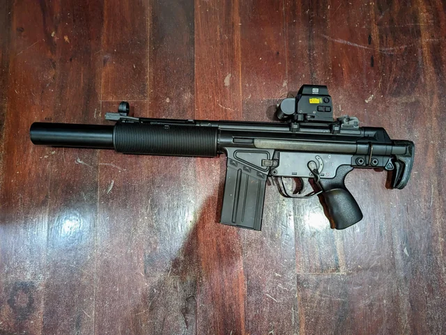

Looking to convert my TM MC51 to having the MP5 style SD front. Does anyone have any idea on whether TM MP5 AEG parts would be compatible to complete this, or if not what other parts could potentially fit?

(Picture for reference)

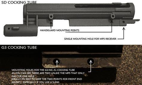

There's a couple of ways of doing it, and there used to be a good guide here but it seems to be down at the moment.
I have saved some pictures though.
Or you can do it the lazy way below
@Hatchet you gem, thank you!

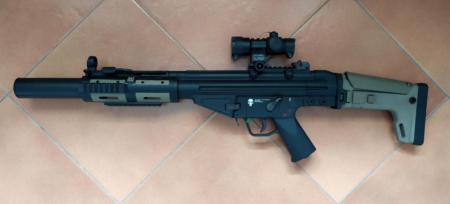

My brother! I have done the same thing to my Marui and G&G MC51, I followed this guide: https://www.gtapex.com/08/airsoft_g3sbs.html
@Hatchet has already provided you the pictures contained in my link, but I think you'll find useful information as well. AND the link itself, which at the moment is working.
Here a picture of my second iteration of the conversion:
1330530618_WhatsAppImage2024-05-07at11_43_57.thumb.jpeg.2364e7f4423d919d52b8cb404dc2c29d.jpeg
