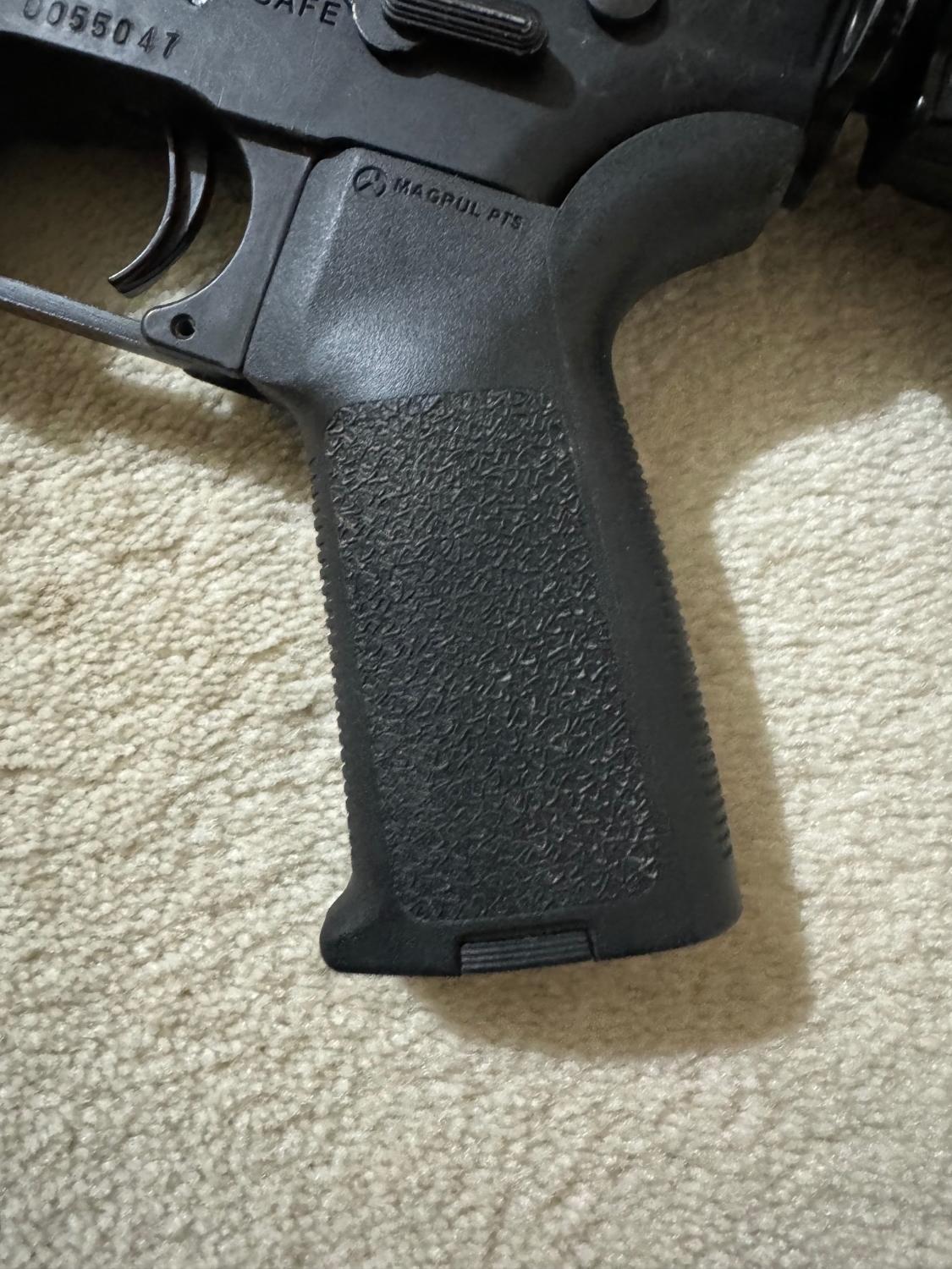

Colin Allen Posted March 5, 2024 Posted March 5, 2024 3 hours ago, ak2m4 said: @Colin Allen Are you fitting it to a SCAR ? It is in an M4.
ak2m4 Posted March 5, 2024 Posted March 5, 2024 10 minutes ago, Colin Allen said: It is in an M4. Ahh right, has it got a different style of grip? Could I trouble you to post a pic of it please?
ak2m4 Posted March 5, 2024 Posted March 5, 2024 Factory just sent the stats over to me, not had a real chance to go through them yet: Pseudotectonic 1
Colin Allen Posted March 5, 2024 Posted March 5, 2024 3 hours ago, ak2m4 said: Ahh right, has it got a different style of grip? Could I trouble you to post a pic of it please? It is a PTS grip.
ak2m4 Posted March 5, 2024 Posted March 5, 2024 @Colin Allen thanks, i've got a epg-c one here I'll give it a test. Also have one of those from an old g+p magpul so i'll try it out.

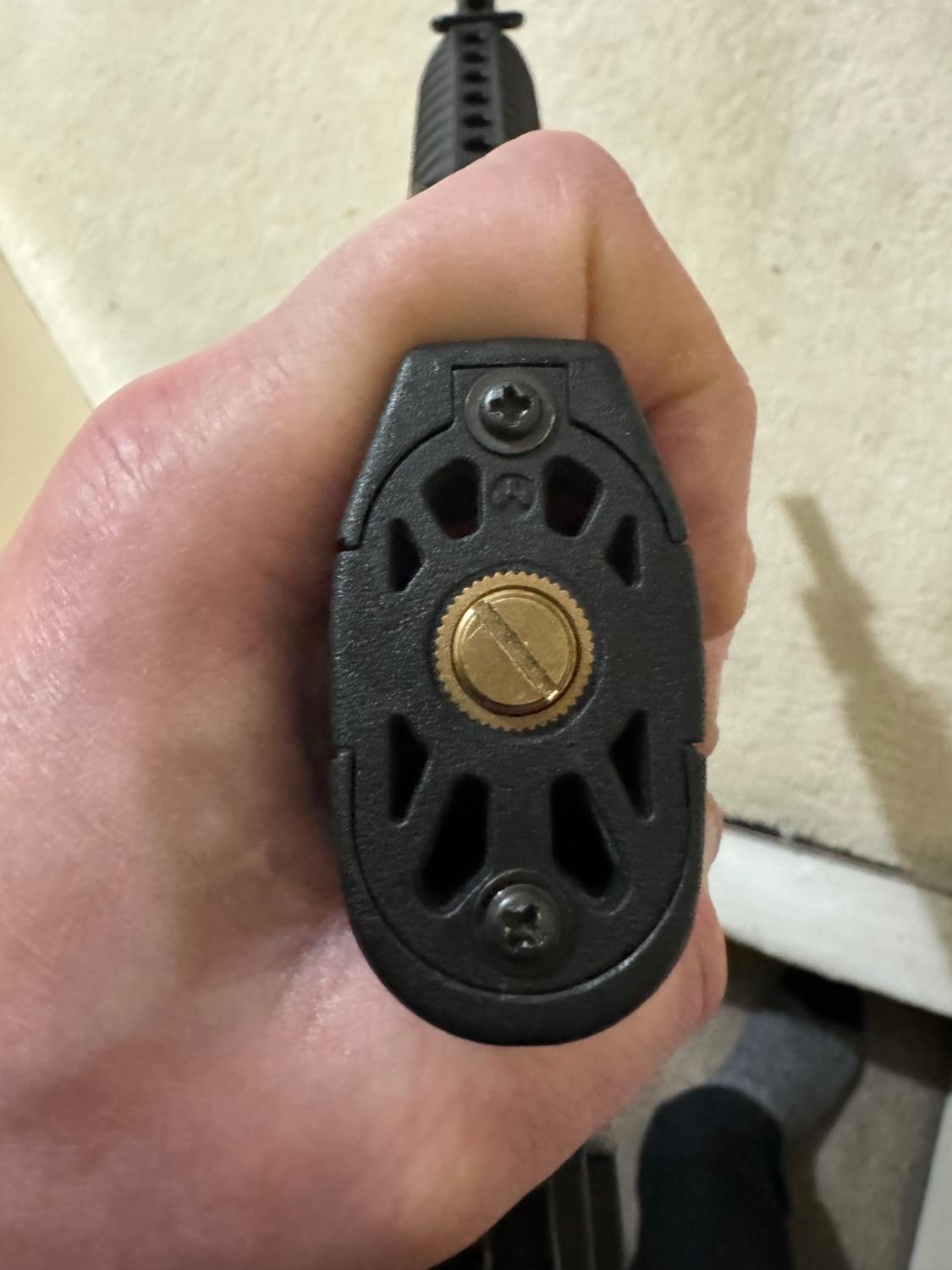

Fatboy40 Posted March 5, 2024 Author Posted March 5, 2024 @Colin Allen It's subtlety different from yours but I'm going to get one of these next pay day... https://www.ptssyndicate.com/product-page/pts-ep-series-enhanced-polymer-m4-grip-epg-for-aeg-erg-olive-drab ... as the base plate online looks like it may not foul up on the motors end bell, but we'll see (either way it's nicer than that on my DE M908A, as long as it doesn't put the motor at an unusual angle).

Supporters Lozart Posted March 5, 2024 Supporters Posted March 5, 2024 5 hours ago, Colin Allen said: It is a PTS grip. That's the same as mine except black! 5 hours ago, Fatboy40 said: @Colin Allen It's subtlety different from yours but I'm going to get one of these next pay day... https://www.ptssyndicate.com/product-page/pts-ep-series-enhanced-polymer-m4-grip-epg-for-aeg-erg-olive-drab ... as the base plate online looks like it may not foul up on the motors end bell, but we'll see (either way it's nicer than that on my DE M908A, as long as it doesn't put the motor at an unusual angle). I've just had a look at one of my spare EPG-C grips, the flanges either side of the height adjuster may still need cutting down a bit, the end bearing on the XT motor is shallower than a regular motor, plus you don't have all the empty space around it where the tabs mount on a brushed motor. Plus they do usually put the motor a touch too steep for me. Not so bad that it shags the motor but not the best meshing! ak2m4 1

dlusted Posted March 11, 2024 Posted March 11, 2024 (edited) Mine arrived, and I've gone to install it in the ARP9 and it's a similar issue with the baseplate. Seems that G&G needs adding to the list for modification I need to square off due to it being shaped to hold the brushed motor in. Need to give it to someone who's got a grinder to do it and I'll revert back when its tested Edited March 11, 2024 by dlusted ak2m4 1
dlusted Posted March 12, 2024 Posted March 12, 2024 I've done the modification. Motor can now be adjusted. Hole in gearbox a little tight for the tower compared to the stock G&G motor tower, nothing a quick dermel grind won't sort though. Super happy with the motor, a lot more snappy compared to the G&G. My Titan 3000mAh battery I had zero issues. Will be even better when I redo the gearbox with new gears and shim. I'm not a Tech as only just started Airsoft so my opinion may be invalid, I'm just an eager hobbiest Looking forward to using the other parts I've ordered from @ak2m4 to aftermarket my ARP9. Lozart and ak2m4 1 1
