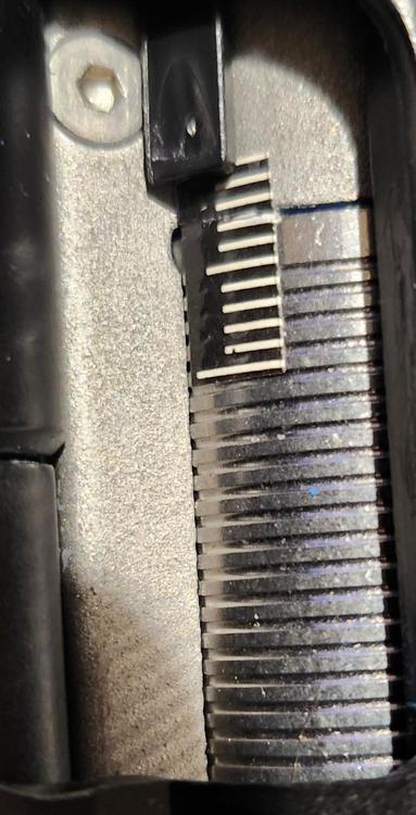

The bearings are 3x8x3 and I had to widen the channel in the selector plate at the top in this pic to take some pressure off the plate so it moves without much effort. Even with 2.5mm ones in the plate rubbed
Bearings are from ak2m4, run nicely with thier 7 balls. Obviously better than 6...

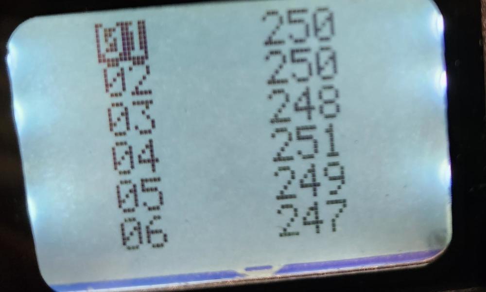

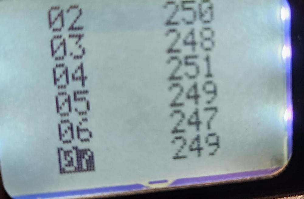

Ok, so I went with M105 spring from xt. Very consistent at 1.18 and 1.19J on .25 with hop off.
I could only find .4g bbs but they gave me 1.17 and 1.18J.
I still have to hop it so this is the peak energy and hop will scrub some off.

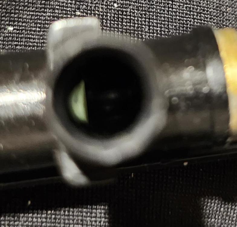

20240221_180055.thumb.jpg.39f02ae58915689c8481cf76ae84ba02.jpgI'm not convinced it's feeding quite right, it seems to but the hop rubber pokes back further than I think it should
Edited by Sewdhull
Maple Leaf?
