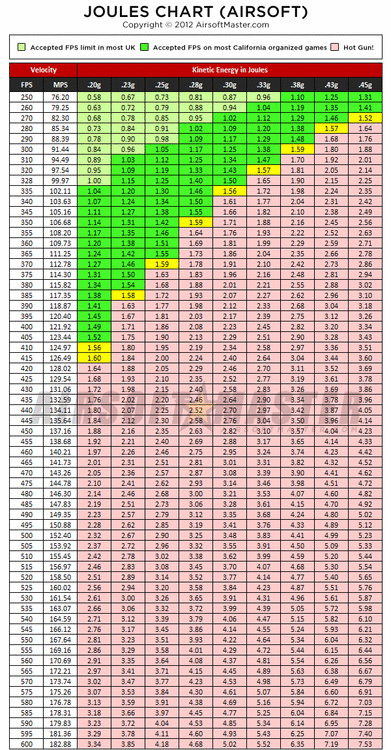

That's correct. Here's a handy chart to show what the muzzle energy is for different weight bbs at different fps limitsairsoft-fps-chart.thumb.gif.1dac32d26362aafc5224d6c36cf7126d.gif
