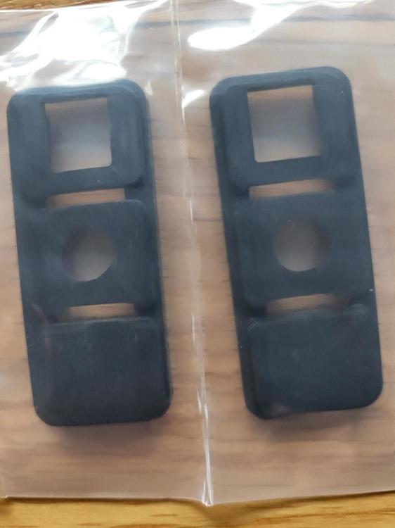

CrackCommandoUnit1972 Posted July 14, 2023 Posted July 14, 2023 Some rubber gaskets for my leaking mag. Hope this will finally solve it. RostokMcSpoons and Nick G 2
RostokMcSpoons Posted July 14, 2023 Author Posted July 14, 2023 4 minutes ago, CrackCommandoUnit1972 said: Some rubber gaskets for my leaking mag. Hope this will finally solve it. Good luck! Where did you get them from?
CrackCommandoUnit1972 Posted July 14, 2023 Posted July 14, 2023 4 minutes ago, RostokMcSpoons said: Good luck! Where did you get them from? I go them from https://kicbbgun.com.tw/en/index.php They have loads of VFC parts so if you need something, they might have it. RostokMcSpoons 1

CrackCommandoUnit1972 Posted July 15, 2023 Posted July 15, 2023 It cost me $15 USD, the postage was $6.89 but it was litterally two bits of very light rubber. RostokMcSpoons 1
RostokMcSpoons Posted July 15, 2023 Author Posted July 15, 2023 1 hour ago, CrackCommandoUnit1972 said: It cost me $15 USD, the postage was $6.89 but it was litterally two bits of very light rubber. That's very reasonable, I'll just do an order with the pin and a spare hop rubber then ?
CrackCommandoUnit1972 Posted July 25, 2023 Posted July 25, 2023 I finally got round to fixing my leaking mag with the gaskets I bought and voila, no more leaking mag. I got a night game coming up next week so an extra mag means less mucking around in the dark. RostokMcSpoons and Nick G 2

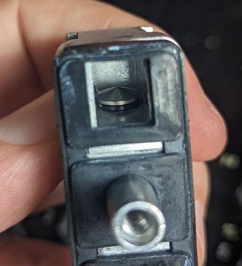

RostokMcSpoons Posted September 23, 2023 Author Posted September 23, 2023 (edited) Bah humbug. I'm having problems with one of my gas mags. I had broken the fill valve by over-tightening it. Luckily Fire Support sell compatible Guarder valves at two for a tenner (which makes the fiver postage feel a bit steep, but hey ho) Anyway, I've just fitted that and tried out the mag again. It's leaking 'bigly' I've narrowed the problem down to two options: 1) I'm an idiot or 2) I'm definitely an idiot It's not the gentle leak of bad gasket or o-ring, it's the 'whoosh' of something missing entirely, or installed incorrectly. I've watched the YT video about servicing this particular magazine, and I seem to have everything in place though. The one area that seemed most likely is the knocker valve. If it's screwed in tightly it seems like the o-ring is exposed and it might not block the gas escaping. Not screwing it fully in didn't help though. I've also tested filling it with it without the spring + follower and top cover in place. The gas comes out of both the top gas hole and seemingly also the BB stack... which can't be right - it must be the gasket...? Any thoughts as to how I've fecked it up are most welcome! A - the BB stack, gas seemed to vent from here, but surely it was actually coming from 'B' C - the main gas route, also venting whether the knocker valve is screwed tightly in, or wound out (as per second pic) Closeup with it screwed completely in... o-ring visible, is it only the hidden / lower side that needs to block the gas? Assorted pics of the valve screwed out, then in... Edited September 23, 2023 by RostokMcSpoons
CrackCommandoUnit1972 Posted September 24, 2023 Posted September 24, 2023 I don't wanna take my mags apart again to have a look as they are all working perfectly at the moment. All your pics seem fine and everything is where it should be. However, and it's hard to tell, but the top of the gasket here doesn't look right. Is it fitting snuggly? When I was having my leaks its was to do with the gasket being very slightly deformed. The leaks I experienced went from a very slight leak to a major pissing of gas as the more I fiddled with the mag, the more I was making the gasket worse. Once I got my new gakests, I smeared all the rubber parts with silicon grease like this - https://www.godive.net/products/silicone-grease/ - and it worked perfectly. Are getting you leaks from the mags from the same place where I bought my leaking mags. RostokMcSpoons 1
RostokMcSpoons Posted September 25, 2023 Author Posted September 25, 2023 Thanks @CrackCommandoUnit1972, I think the gasket in the pic was quite loose on the valve, but seemed to be correctly positioned when assembled. I'll take it all apart and check for any damage, evidence of it being nipped when in position. And check the gaskets again too. I had another mag that I thought had lost its ability to hold gas yesterday at my skirmish. Luckily it turned out it hadn't quite seated properly - a 'sturdier' approach to getting it in the mag well was all it needed. However, all of this is making me think I'll just take advantage of my existing HPA equipment (that doesn't get used, because of my Tippmann issues), get an Airtac adaptor and side-step most of these glitches! I talked to a couple of people running with them on their gats yesterday, and they seemed very pleased with them. So... I can order the new M4 adapter from Airtac for £130, I'll have to sacrifice components from one gas mag to complete it, and then I need to buy a regulator for my air tank. I need some advice on that, I'll start a thread in the HPA section.
