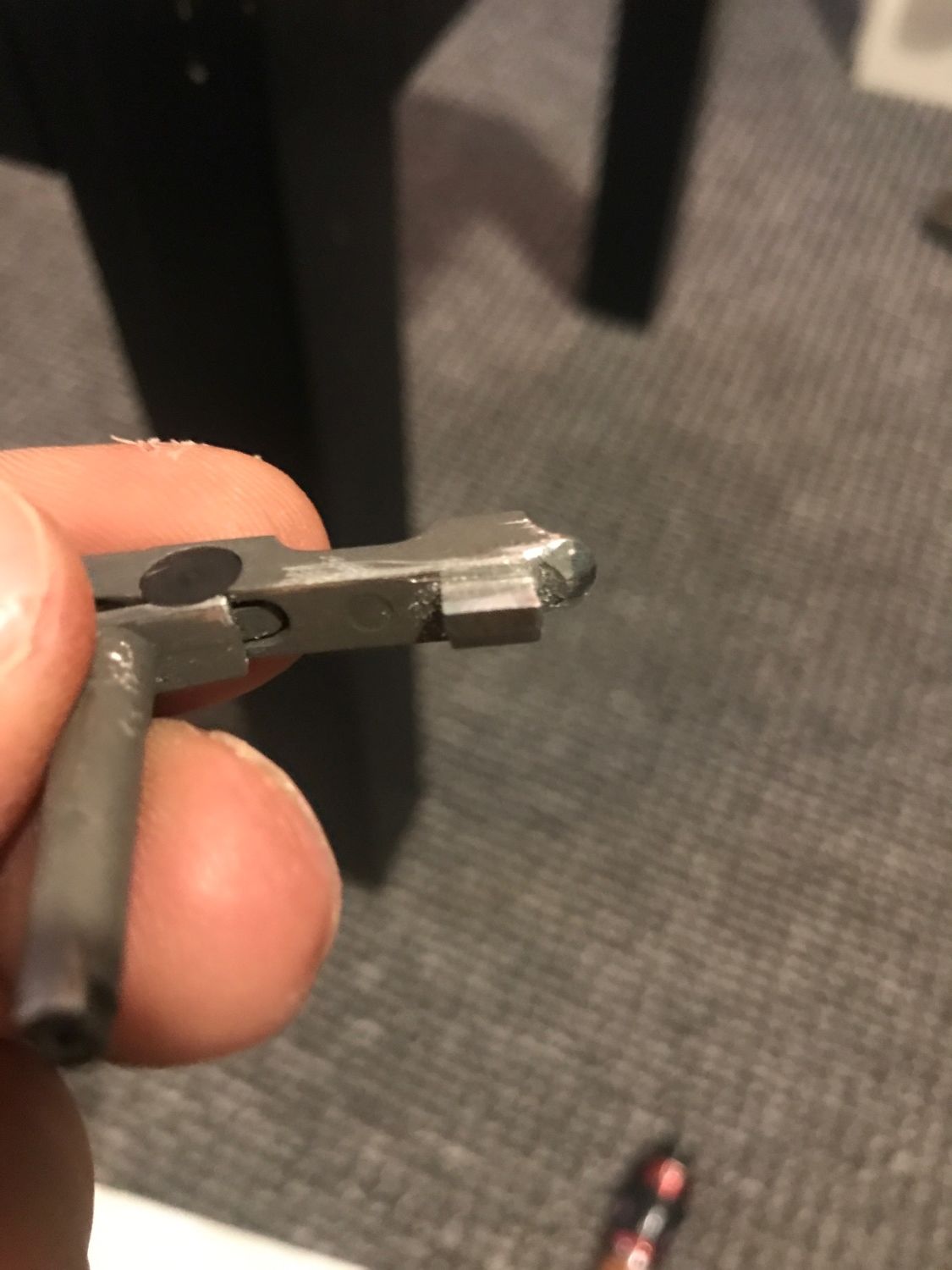

SBoardley Posted December 30, 2021 Posted December 30, 2021 Sweet. Glad you sorted it. As far a barrel goes, do you have an outer barrel that you can swap out to see if it makes a difference? Also…. You could try a G&p mag release, these have more material on the upper of the tab which, if you do have a gap between the base of the hop and the magazine, will pull the mag higher…pic is of me fitting one to an ics but doing the opposite ie removing material… Paul72 1

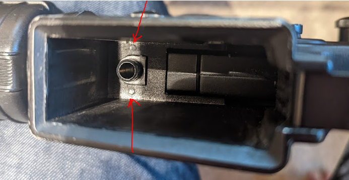

SBoardley Posted December 30, 2021 Posted December 30, 2021 Yeah. I had heat a knife and alter the position of the mag indent to get these to work… see pic also check out @Rogerborgtech post which is kind of relevant to your issues Paul72, Tactical Pith Helmet and RostokMcSpoons 2 1
