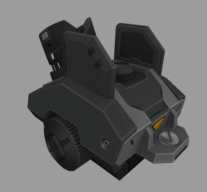

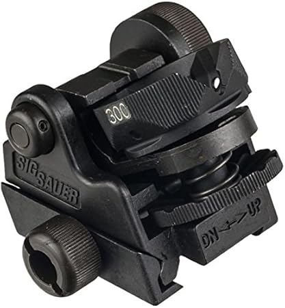

In this game this used to be an MP5A3 but it was then converted into an MP5K which explains why it looks the way it does. If I can achieve this look it might be a decent little shooter. I'll also 3D print the rails and custom sights. The rear sight resembles a Sig Sauer Diopter sight thats set up like a HK Diopter
Amazon.com : Sig Sauer Rotary Diopter Rear Sight - 1511663-R : Sports &  Outdoors
image.png.7e536ba83efbd205e8df798c4ac20312.pngimage.png.ba19cd43487227d09321a64abb3105ac.png
The design of this sight kinda seems nonsensical but I'll find out soon enough when I get it printed.
