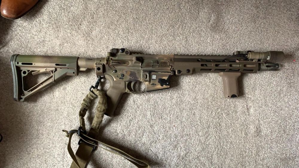

After taking delivery and a bit of playing around tarting up my first PTW, I already want a 2nd one...
Truth is though my budget has been blown this month so, unless I can find a bargain, I’m looking to potentially build a swappable upper to quick convert this to a CQB. Now, I’m new to PTWs and this one is FCC with Systema parts so, I’m a little unsure of compatibility.
Any idea of UK places where I can find the right parts (upper receiver, cqb length inner/outer barrel, short RIS & suppressor) please.
Spec below:
FCC upper/lower with Knights logo engraved, Cerakoted DarkEarth
FCC 16inch convertible outer barrel , Varanas SPR precision barrel
FCC Cylinder 330 FPS +Systema hop up
