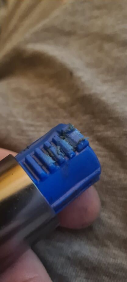

Misery Posted January 17, 2021 Posted January 17, 2021 Well my cyma's piston has crapped itself,any recomendations on a upgrade piston? also thinking of replacing the gears shimming etc as im assuming the issue has been the gears been able to move and jump cause it to do that,i dont mind throwing a little bit of money at it as i dont have much invested in it so have a rough budget of bout £70 for upgrades/replacement parts once i have the mechanics all sorted will move onto cosmetics
Supporters Sitting Duck Posted January 17, 2021 Supporters Posted January 17, 2021 That is "likely" PME Premature Engagement gun cycling too fast, sector attempts to engage the piston before it has fully returned and crunches into the rack on the 3rd/4th tooth etc... Plastic teeth being weaker start to strip, it happens once or twice, it gets worse = f*cked If this happens on a full metal rack piston then metal gears/rack tear themselves off (something has to give/fail in the end) It can also happen with a jammed BB, so the newbie mistake is to keep firing on auto to clear it even mag out - full auto - CRUNCH The jammed BB has plugged the compression like a syringe and this slows the piston's return = PME or something just failed, pear shape tits up and crunch - stuff happens but usually that looks like possible PME likely cycling too quick or jammed BB or both Change piston to metal rack Cyma, buy new o-ring could buy new cylinder head, but 7 or 8 wraps of ptfe works well if done neatly leave the gears, maybe buy a SHS HT motor but NOT a high speed motor that'll do for internals clean barrel, use decent bb's - really makes a difference & prevents jams from egg shaped bb's (or big seams on cheapo bb's causing jams in tbb/bucking) if you want zci hop, maple leaf bucking & red nub barrel should be a half decent tight bore one

Supporters Adolf Hamster Posted January 17, 2021 Supporters Posted January 17, 2021 Going from your other thread you're running that thing on 11.1v In which case i reckon @Sitting Duck is spot on about the pme but i'm wondering if this is a weak spring as the culprit. ive seen a cyma eat a piston like that was fresh out the box, 11.1v but a half-assed "fps downgrade" by the shop with it spitting out 0.5j had the piston chewed up bad within 30 minutes (weak spring means it doesnt have to be spinning as fast for pme to be an issue so the stock motor on a hefty battery was fast enough) When you get the new piston in might be worth checking the fps. If you get very consistent (ie each shot doesnt change much in fps) but low readings then that might be your culprit. Dont know how confident you are with tinkering but there's a few tips and tricks for dissassembly/gearbox checks here: You dont need to go ham with trying to change things like aoe/shimming etc just yet, Just keep the shims in the positions they were originally. but at least that should let you know what to expect so you dont end up with a spring guide pinging its way into the aether the moment you pop it open. Of course this is assuming the gearbox is all stock and this isnt as simple as the previous owner dropping a spicy motor in there.

Davegolf Posted January 17, 2021 Posted January 17, 2021 @miserydrift I would fit a similar plastic / metal teeth combo piston, BECAUSE if shit hits the fan, like it has for you, the damage is limited to just a new piston. If you run full metal teeth piston and what has happened to you happens again, you can break SO MUCH MORE! Soz @Sitting Duck ? On a budget get this piston and spring; https://www.ak2m4.co.uk/internal-parts/pistons/rocket-3-tooth-piston https://www.ak2m4.co.uk/internal-parts/springs/aols-aeg-spring-m100 If you want a stronger piston that is still a great fail safe, then get one of these; https://www.fire-support.co.uk/product/ics-reinforced-upgrade-pom-piston-set

Supporters Sitting Duck Posted January 17, 2021 Supporters Posted January 17, 2021 Seems like the hop might have caused a BB to jam than actual speed which resulted im PME piston shredding he can't post atm so is posting in updates bit maybe lips or hop on way too much - well what ever Another piston to be careful is the 3 & 7 tooth dark grey ones from TWG they are a bit shit also had one just rip the rip initial pickup tooth right out https://www.taiwangun.com/piston/reinforced-piston-with-seven-steel-teeth?from=listing&campaign-id=19 Hard as fuck - like nails that plastic, like brittle hard as fuck plastic had some 3 & 7 tooth versions... I think the pick up tooth is way too large/deep and kicks the sector as it returns had one of those just crack the pickup right out was a long time ago - but knowing what I know now I could carefully file the massive pickup down a smidge and keep checking shit in top half of box as I often do yet my gut feeling is just a tad ultra hard & brittle plastic/polymer but another piston I tried and thought nah fuck it I got a few pink OEM ACM 7 tooth pistons - they're fucking ace as well as some pink full metal rack pistons about 3 years ago from GF for a few quid - they were fucking awesome & didn't bind in boxes like SHS did wish I could find them but reckon they are long gone from production would be like finding a fixed stubby M4 stock - like rocking horse shit or hens teeth nah - tried 3 part metal/plastic pistons and only one of them was any good and that one is no longer in production it seems - just my luck so tend to stick with metal racks myself - but to each their own here are the OEM ACM pistons that I love... the 50/50 rack is at back - shiny surface but these are damn good pistons - that don't bind like SHS's need a bit of work/cleaning up but fits the bill when a SHS binds if anybody sees these around they are pretty good pistons imho (probably seen them in some of my build posts) I'll use a SHS metal rack in a G&G as it don't bind Try a Cyma metal rack in others but if the G&G is too tight, the Cyma is a tad loose (bit too much plat left/right & up/down as piston moves back/forth) Then one of these pistons are usually chosen as they are in between a tight SHS & sometimes smidge too loose Cyma yup they are/were damn good 'uns where as the SHS & TWG grey 50/50 pistons - not such a wise investment Something similar to those pink 50/50 pistons is this... https://www.taiwangun.com/piston/reinforced-piston-with-seven-steel-teeth-bw?from=listing&campaign-id=19 Often I didn't need them or out of stock to add to a previous order BUT if anybody is doing a TWG order at some point & might need a 50/50 piston well I reckon they could be worth a gamble on buying a couple of them That was about the only piston I saw like my 50/50 ones I've used/rated hasn't got the full complete intact rails but nigh on might need to check the initial pick up tooth isn't too high (in some boxes rubbing on sector's toothless area, very fine file) extra material on 2nd/3rd tooth surrounding area - bit of work removing chunky pickup tooth, won't need much to even partial correct AoE etc... (yes often shit needs a bit of tweaking, glue the rack etc...) if it is like my pink ones, they shouldn't bind in most boxes but not too much play/slack either - just the right fit to glide without binding End of the day, it's a case of checking & getting whatever shit you got to hand all operating smoothly & efficiently etc...
Supporters Adolf Hamster Posted January 17, 2021 Supporters Posted January 17, 2021 ahh yes, see the status update. so my spring theory was wrong. you win this time duck
Supporters Sitting Duck Posted January 17, 2021 Supporters Posted January 17, 2021 Didn't win anything - just guesswork but we've all broke shit lots of times in many different ways THIS is my favourite of favourite pic that sums up diagnosing shitty bastid toy gun issues.... poor OP won a fucked piston & lost his posting ability whilst having to wade through all my crap instead - ouch that's gotta hurt
Davegolf Posted January 17, 2021 Posted January 17, 2021 Yes this is most common fail, basically pneumatic lock “Seems like the hop might have caused a BB to jam than actual speed which resulted im PME piston shredding” One of the reasons 6.00 / 6.01 barrels are daft too. Dirty jam.
