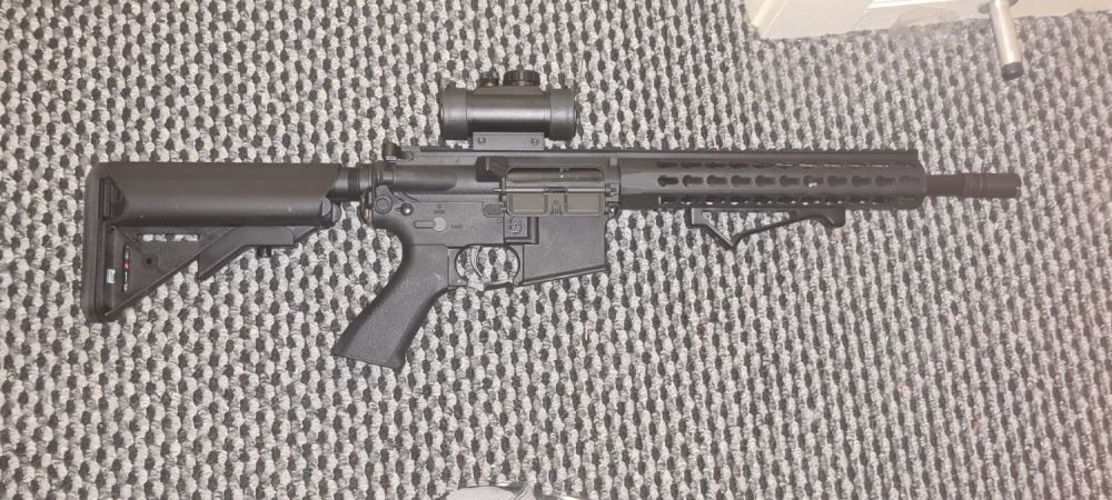

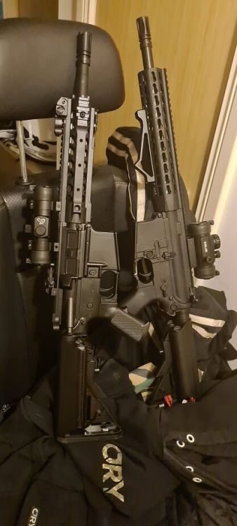

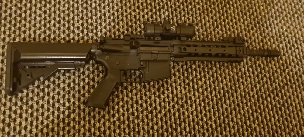

as the per the title hello new to airsoft literally managed to pick myself of a steal of a deal on 2 2nd hand cyma's for me and my step son to start using as soon as the rona buggers off! will be using the cm.621 for myself and let the boy use the cm516,came with 3 hicap mags 6 mids 2 stick 3s lipo's for the 621 and 3 crane nihms for the 516 both guns have come with a red/green dot sight,loads of bbs,a excortek chrono a vest gun bag and few other extra's
