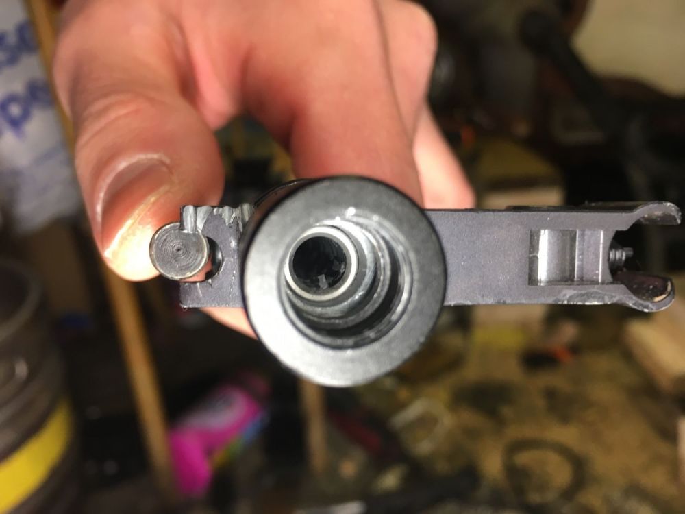

Janis Posted December 27, 2020 Author Posted December 27, 2020 So inner barrel is badly scored.its hard to make photo but its full of stuff as far as u can see in. is there a problem with gun ir its just matter of giving it a good clean after every game?

Supporters Adolf Hamster Posted December 27, 2020 Supporters Posted December 27, 2020 5 hours ago, Janis said: So inner barrel is badly scored.its hard to make photo but its full of stuff as far as u can see in. is there a problem with gun ir its just matter of giving it a good clean after every game? Is that just white powder on the surface? If it is then thats bb residue, in part down the choice of ammo. Getting into the habit of cleaning the barrel before every game is worthwhile, one of the best "upgrades" you can do in terms of cost/difficulty to performance ratio

Janis Posted December 28, 2020 Author Posted December 28, 2020 Yes its residue of pellets by looks of it.will get some surgical spirit tomorrow and cleane it.newer knew it can go that bad.thats why i jojn forum cos u can learn a lot of wee things here.
Supporters Adolf Hamster Posted December 28, 2020 Supporters Posted December 28, 2020 44 minutes ago, Janis said: Yes its residue of pellets by looks of it.will get some surgical spirit tomorrow and cleane it.newer knew it can go that bad.thats why i jojn forum cos u can learn a lot of wee things here. small strip of microfibre and one of them plastic cleaning rods most guns come with works very well. some folk use silicon, some use isopropyl, and i sit right in the middle and use nothing
Janis Posted December 29, 2020 Author Posted December 29, 2020 Took inner barrel off yesterday.give it a good clean.looks like its weebit scored inside also no brand printed on it so must be cheaper stuff. put it all back together and same thing.4 bbs go straight ish and 5th pulls on left. any ideas?thinking of getting new good quality inner barrel and new hop.coud it be anything else before i start buying this?also what woud be good brand for inner barrel and new hop and hop rubber? anything else shoud be changed along with this?
