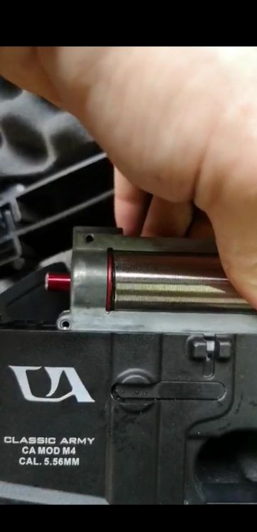

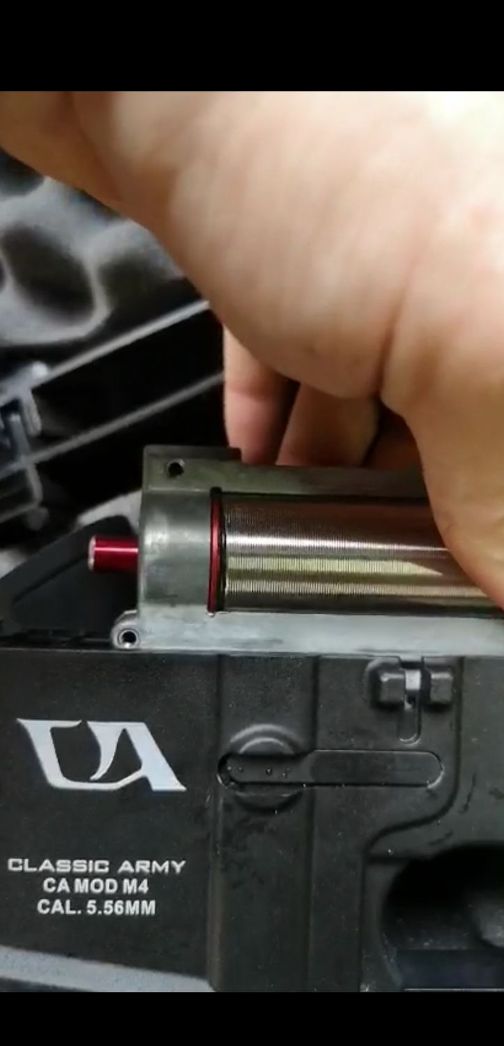

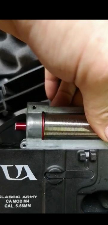

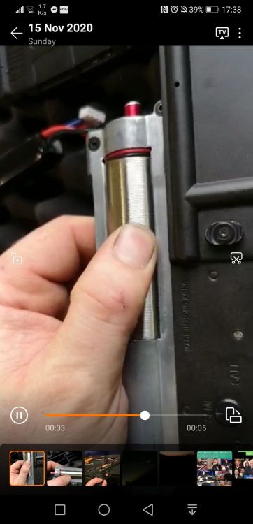

Welshd1k Posted November 15, 2020 Posted November 15, 2020 Biught a gun off this site advertised 35ros 330fps Arrived Friday test fired in garden shot nice and straight Took it to my local. Cqb site and outdoor site today chronod 220fps 54rps! Spoke to the seller said spring must be worn asked around found somone with a new 100 spring and then got the on site tech to install the spring on tear down discovered the air cylinder wasn't sealing on the cylinder head and appears to be cut on the squiff (or has bashed it self like it??) The pistol nozzle has been filed down?? And no barrel spring on the hop unit Spoke to seller had no reply. What would people's advice be on this situation Is there anytbing I could have done to cause this in 1 magazine of. 28s with the battery provided with the gun (also puffed up) Second used gun I've been "had with now" maby I should just spend 160 on a new gun?? VID-20201115-WA0000.mp4 VID-20201115-WA0004.mp4
Asomodai Posted November 15, 2020 Posted November 15, 2020 That looks pretty "Bodged to get it working enough" to me. I mean replacing the air seal stuff isn't the end of the world. But the seller should be paying for this stuff or offering a refund.
Supporters Sitting Duck Posted November 15, 2020 Supporters Posted November 15, 2020 YES - buy a new gun is that gearbox an APS QC v2 with a hairline crack start to show above cylinder head ??? The first clip/pic seems to show the startings of a small crack appearing to me though it could be a casting defect APS boxes are known to crack if pushed though wtf is an APS doing in a Classic Army M4 what happened to original box how old is this gun (for real, not just 9 months old bollox) sorry you had a bad purchase (didn't buy it from a bloke in Ireland by chance ???) had dealings with a fine tech seller there many years ago... did the bloke put sawdust in the box to quieten down the gear shimming ???
Welshd1k Posted November 15, 2020 Author Posted November 15, 2020 It was sold as fully working off this site I was happy with how it sounded it shot straight but no distance was gutted when it chronod so low but the rps was mental Only thing I see may be a issue is if the gearbox has taken damage from the cylinder smashing around What would be a acceptable price to pay to get this rectified as I ain't too keen on pulling a box appart with the shims etx 1 minute ago, Sitting Duck said: sorry you had a bad purchase (didn't buy it from a bloke in Ireland by chance ???) Not sure what the box is and no was from
ak2m4 Posted November 15, 2020 Posted November 15, 2020 £25 - £30 for 1 hour tech work, plus parts cost. New cylinder head, new nozzle plus what else is wrong so £50 - £60 min. You won't really know till someone open's it up. Also as @Sitting Duck says could be a gearbox replacement as well, add another £25 on for that. How much did you pay in total?

Welshd1k Posted November 15, 2020 Author Posted November 15, 2020 It is a m160. Motor very strong and torquey I'll get more picturesin regards to the air cylinder and box what should I be looking to retrieve financially for it? So g box 25 ish Cylinder 10andnthen tech timso 60 70? Or just a full refund Paid goods (learnt with the last gun)

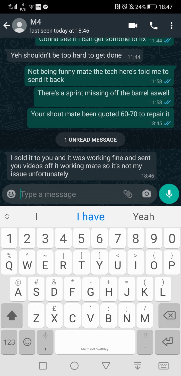

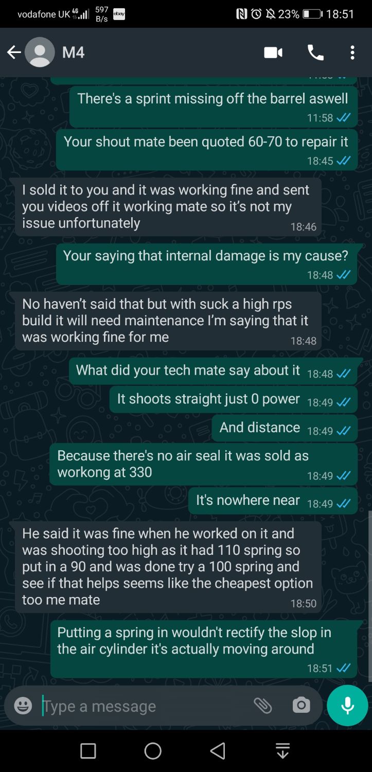

Welshd1k Posted November 15, 2020 Author Posted November 15, 2020 And this is the reply I get he sent a video of it shooting tracers in the night so it's my issue the internals are broken
Supporters Sitting Duck Posted November 15, 2020 Supporters Posted November 15, 2020 was the gun shooting tracers in the dark the SAME GUN he sold you though ??? and just coz BB's come out doesn't mean it ain't near fucked
Welshd1k Posted November 15, 2020 Author Posted November 15, 2020 I must attract all the time wasters/people that like to mug people off first my predator with a siezed gearbox now this

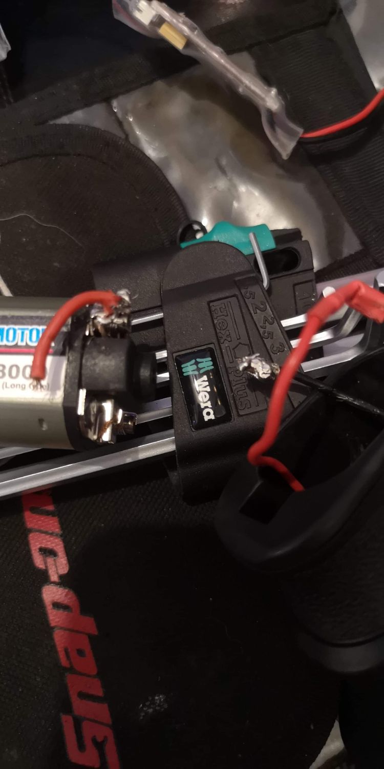

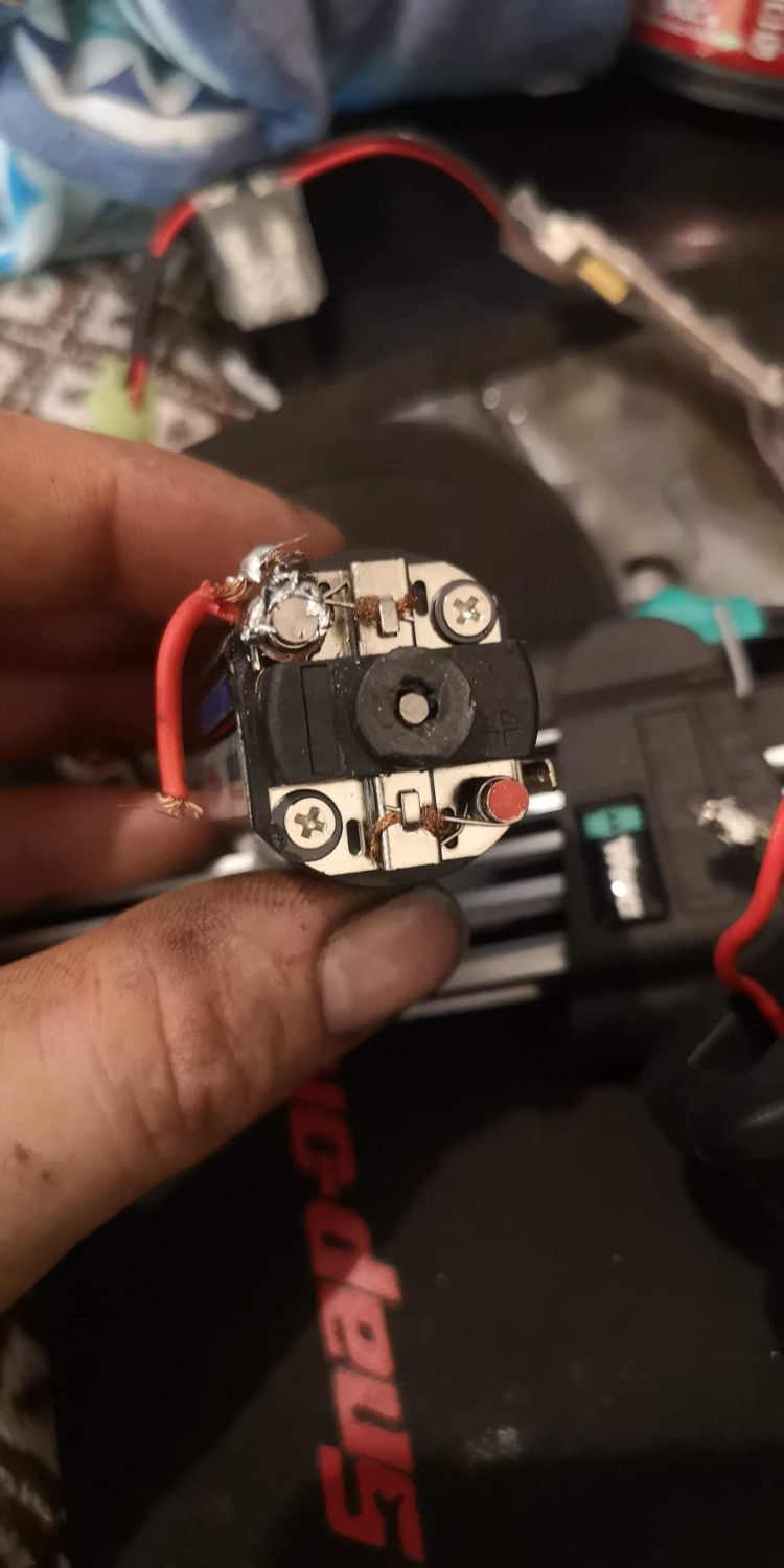

Welshd1k Posted November 15, 2020 Author Posted November 15, 2020 The air nozzle (aftermarket one) was jammed solid and wouldn't move and motor wires had been bodged
Supporters Sitting Duck Posted November 15, 2020 Supporters Posted November 15, 2020 how do you jam a nozzle - even tappet plate should fly freely as ETU has no convential trigger trolley shuttling below it must have been assembled by Stevie Wonder & Ray Charles maybe aftermarket nozzle was way too loose on G&G tappet and got borked in use ??? wires chewed up - well by motor they can get chewed and tbh on ETU they should run both the motor wires down back and just have the ETU signal wire/cable by motor entry point on v2 box
Welshd1k Posted November 15, 2020 Author Posted November 15, 2020 The nozzle was stupidly tight to pull off thinking wrong lube dried out? I'll find the video now received_330809044855208.mp4 Had 0 luck
Supporters Sitting Duck Posted November 15, 2020 Supporters Posted November 15, 2020 I'd thought the Predator would have had the 25k Orange Ifrit motor than the shit grey 18k ferrite motor but the standard of work & craftmanship leaves me lost for words...
Supporters Sitting Duck Posted November 15, 2020 Supporters Posted November 15, 2020 yup - I see the fragile ETU mosfet unit just behind the welded motor I'm guessing the red/posi 2.8mm connector snapped off or broke at the bend so little Timmy thought he would get his mate to weld the wire back on (rather than fit new connector) I'll guess he didn't want to fuck up the better motor that was in Predator so then used cheap shitty motor from say a Combat Machine Raider or something I'd lay money there is nice unwelded Ifrit motor kept back by seller... Green nozzle - fuck knows where from, maybe some cheap unbranded OEM thingy, that was perhaps a bit to snug in G&G hop unit - even some red SHS nozzles can be a tiny bit snug in a brand new G&G hop unit... (Other times they move smoothly - maybe minor variations in batches or if they have been "run in" or any minor burr polished out after a few thousand rounds) I'll guess the nozzle is a bit snug & where the box was refitted, the stock tightened up, tilted box upwards slightly at front. Which then caused the nozzle to rub more at top of hop unit inside - thus the nozzle doesn't fly back n forth smoothly but snags instead Wanker tech, not for making these errors - we have all had grief and we are still dropping the ball at times with shitty toy guns But they are a WANKER for palming it off onto others Than fix the fucking thing properly If they did it correctly, they probably would keep it But nope fuck up the "upgrades" (semi wanker) Couldn't or couldn't be arsed to fix it (lazy wanker) Then offload it onto somebody else (fucking wanker)
