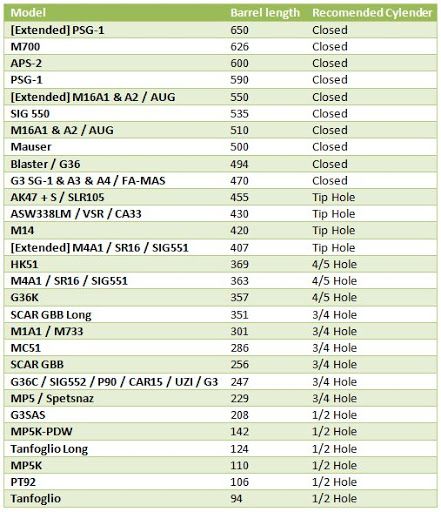

THE FNG Posted August 4, 2020 Posted August 4, 2020 Noob question. I've recently acquired a tm high cycle aug in a trade and I love it to bits. I'm considering using it on my next skirmish (some time away) and I was hoping to bump the fps a little as they shoot 260-270 stock. I wasnt going to touch the gearbox as they have been designed specifically for low torque motors and low power springs I was going switch the inner barrel; I bwive they come 260mm stock and I was thinking of adding a 300+ tbb. I've viewed the cylinder volume chart online but I'm rubbish at tech work. I beleive the high cycle has a 3/4 hole. If I have interpreted the chart correctly I could install up to 350mm inner barrel. Am I right in believing this, are there any other variables I need to consider and would anyone roughly be able to guess at what length I would be in danger of shooting over 350 fps? I appreciate this may be a "how long is a piece of string" question! I'm not aiming for 350, more like 300 to 320 just so the hits are felt. Chart for reference.
Skara Posted August 4, 2020 Posted August 4, 2020 I'd just get a tighter barrel, same length but 6.03/6.01 in diametre, the stock one is 6.08. That way you'll get a nice boost in energy output without risking going over the 1.13J limit for full auto. Just keep in mind that it'll most likely creep if you use some heavier weights like 0.28/0.30s, but I'm pretty sure it'll never get to the legal limit.

Supporters Rogerborg Posted August 4, 2020 Supporters Posted August 4, 2020 2 hours ago, Adolf Hamster said: Cant say ive ever really noticed much meaningful velocity change in aeg's just from mucking about with barrels I have, but it's not an exact science. Before: CYMA M4 with an 280mm sloppy-bore, an M100 spring and stock piston and nozzle and cylinder ported for that barrel = 330fps. Aft4er: A shorter 229mm ZCI 6.02mm, ZCI rotary hop and maple leaf rubber = 374fps. Oops, I've had to throw in an M90 spring to get it down to 340fps. I did stretch the piston o-ring and grease inside the cylinder, but otherwise it was all outside the gearbox. I really didn't expect that, but that's what I saw. Could be the barrel, could be a better seal at the hop rubber, but either way, quite the jump in energy. However, swapping the stock barrel on a JG G36 for a 6.02mm 247mm ZCI and a maple leaf rubber added only a little energy, so... not an exact science. What I would suggest is improve the stuff outside the gearbox first, then then piston air seal, then finally change the spring to match.
Supporters Adolf Hamster Posted August 4, 2020 Supporters Posted August 4, 2020 9 minutes ago, Rogerborg said: Could be the barrel, could be a better seal at the hop rubber, but either way, quite the jump in energy. See my feeling there is a nozzle-hop airseal improvement in that example much moreso than simply the barrel diameter. See we should be changing only one thing at a time when tinkering, but lets face it aint nobody got time for that....

Supporters Rogerborg Posted August 5, 2020 Supporters Posted August 5, 2020 On 04/08/2020 at 20:12, Adolf Hamster said: See my feeling there is a nozzle-hop airseal improvement in that example much moreso than simply the barrel diameter. You might very well be right, I've got no hard evidence, because... On 04/08/2020 at 20:12, Adolf Hamster said: See we should be changing only one thing at a time when tinkering, but lets face it aint nobody got time for that.... That, really. What I would suggest is that if you are going to change the barrel, do that first as it's about the easiest thing to do, then it's a fixed point and you can work backwards from there.
