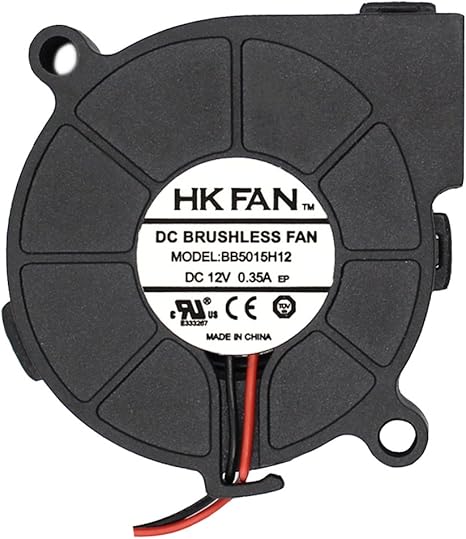

Supporters Rogerborg Posted July 23, 2020 Supporters Posted July 23, 2020 6 hours ago, Lollingsgrad said: I've already had at them with a knife! Then it would be a bit cheeky to return them. Quote I'm looking forward to the fan project though I think it's going to work out well. Got a 5cm blower fan that I'm going to install in a rear vent, then I'll attach a hose tail to the exhaust on the blower, a y-splitter on the front of the helmet, then pipe it so it should all be hidden under the helmet One of these? Yup, works a treat, I've put one on my lid running off small 7.4v 300mAh lipos that just tuck up inside it. I tried a 3.7v 18650 battery but it didn't spin it up quite fast enough, so I'd suggest 7.4V, or you could use a step up regulator like this. If it's attached directly to the lid, you will hear a fair bit of noise, but you only need to run it as necessary, not all the time - I would recommend fitting a switch. I didn't bother with a splitter, just ran a single piece of (initially) soft silicone tubing from around back, through the helmet shell behind the ear, and running around under the brow of the helmet. However, silicone tubing is so soft and squishy that it's a sod to cut holes in it, you have to snip out wedges, and I wasn't happy with the result. So I replaced the section inside the helmet with clear 5mm ID / 8mm OD aquarium tube which you can drill holes into. Two holes above either eye seems OK, although I may drill another on the side furthest from the blower. Just be aware that your helmet brow will likely be in front of your goggles, so you'll have to point your tubing / holes at an angle backwards towards you, not just straight down.

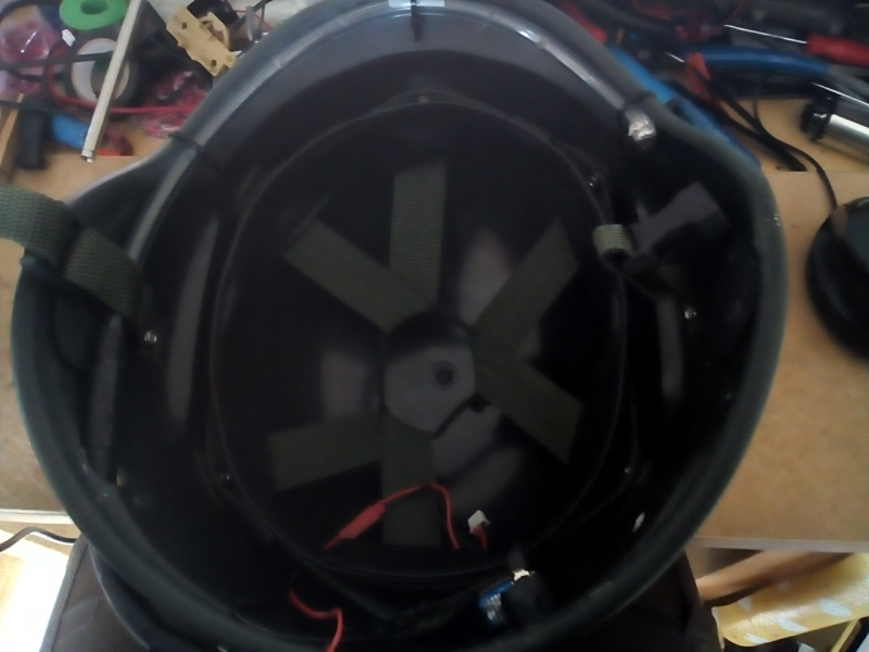

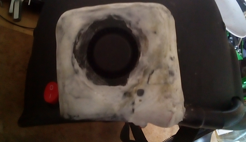

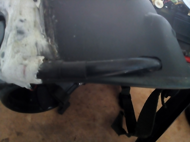

Supporters Rogerborg Posted July 24, 2020 Supporters Posted July 24, 2020 8 hours ago, Lollingsgrad said: What did you use to connect the fan to the hose Stepped down sections of plastic hose. I had a piece of 12mm ID to hand and heated it in hot water until I could stretch and re-shape it to match the fan outlet, then hot-glued it in place. It then steps down a smaller section, which steps down to a length of flexible silicone hose, with the joins being covered with heat-shrink. This is it in situ, boxed in with EVA foam and still being filled and sanded to neaten it up. The perspective makes it look much bigger than it really is! This is my 40K Imperial Guard impression lid, so it's actually meant to have a box on the back - might as well use it for something. Entering the shell behind the ear. If you were to angle the fan outlet down, you could run tubing under the shell rather than drilling through it. And then switching from silicone back to PVC for the section under the brim. You can't really make out the holes, but they're facing backwards more than downwards. A 9V battery should work well, I just happened to have these small 7.4V lipos spare so I've tucked one up above the switch. I've done a steam test on my i-Forces, completely steaming them over a kettle then running the fan and they clear in a few seconds. Bit more smoothing and paint and we're good to go.
