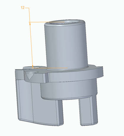

Supporters Adolf Hamster Posted July 13, 2020 Supporters Posted July 13, 2020 ok so i had a look at the f2000 gas plug. the dimensions to check for the hole are 10.5mm diameter by 12mm deep: solid edge has a nasty habit of exporting .stl files with the units in inches, so some re-scaling may be necessary.F2000 gas plug.stl F2000_gas_plug.stl
PopRocket123 Posted July 13, 2020 Author Posted July 13, 2020 That's perfect thanks. I'll let you know how I get on with that this evening. This'll really complete the front end
PopRocket123 Posted July 13, 2020 Author Posted July 13, 2020 8 hours ago, Adolf Hamster said: ok so i had a look at the f2000 gas plug. the dimensions to check for the hole are 10.5mm diameter by 12mm deep: solid edge has a nasty habit of exporting .stl files with the units in inches, so some re-scaling may be necessary.F2000 gas plug.stl F2000_gas_plug.stl 3.97 MB · 0 downloads Just checked this out and it's a perfect size. I guess FN reuse parts between guns
Supporters Adolf Hamster Posted July 13, 2020 Supporters Posted July 13, 2020 27 minutes ago, PopRocket123 said: Just checked this out and it's a perfect size. I guess FN reuse parts between guns guess it would make sense given it's just a gas plug. that stl file work ok?
PopRocket123 Posted July 13, 2020 Author Posted July 13, 2020 36 minutes ago, Adolf Hamster said: guess it would make sense given it's just a gas plug. that stl file work ok? Yep loaded no problem. I've send it off to get printed out with the rail extension
