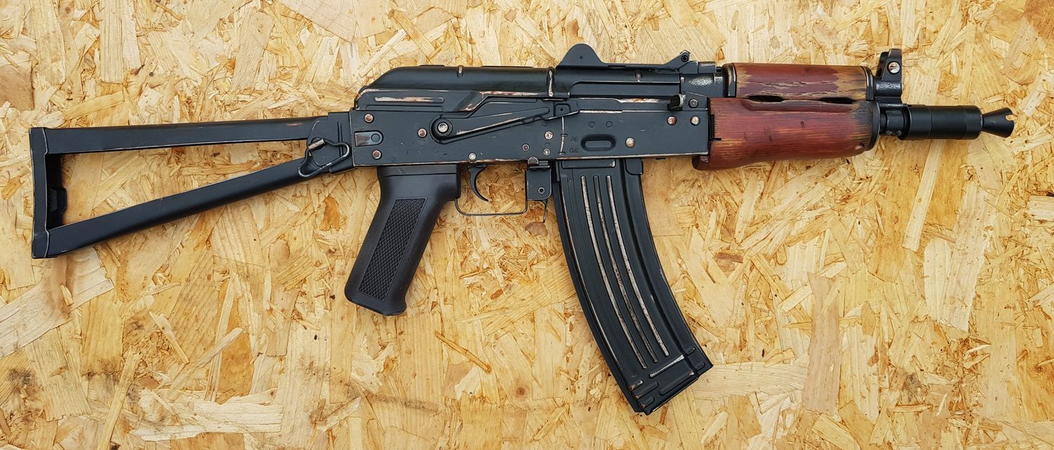

- Got a Cyma CM.045 (AKS-74U)
- Run 7.4V 1200Mah LiPos that fits nicely in the gas tube and only protrudes an inch or so into the receiver

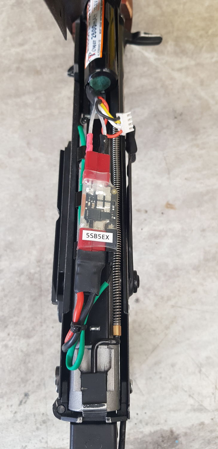

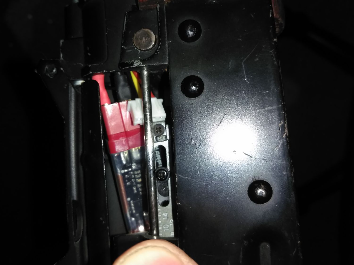

I dont use a warfet in my aksu, but it's a very similar config to how your describing.
I'll fish the warfet out of the f2000 and i'll see if it fits
Edit: yes it does;
Edit: yes it does;
Nice one - Thanks!
This is a NanoHARD mosfet with a 11.1v Li-Ion in the gas tube as far as it will go ?
Carefully measured out the new motor wires and laid it out on the gearbox shell to make sure. Leads on the battery were shortened a bit too as I was swapping them to Deans anyway.
NanoHard had all the features I wanted but the WarFet looks really good. Gun is a loaner / Milsim OPFOR / messing about so it does the job. Snappy even on a 7.4v and active brake works well. Nice to know the trigger contacts won't burn out either!

3 hours ago, RonLancs said:
Hey man, could you please kindly send a few pics of the set up of this gearbox? I just want to get an idea of how to wire it and keep it neat. This looks like what I’m looking for.
The two signal wires exit the gearbox in the same place as the old trigger wires (front LH side) and go straight up the left hand side of the gearbox shell to the top of the shell and under the cable keeper bit of the gearbox top cover thing and to the MOSFET. They are covered in green heatshrink in the photo below as they are quite thin gauge.
Motor-to-Deans wires fit exactly the same as the old ones. They are the ones to the rear next to the 5585EX sticker. I went for thicker gauge silicone wire and measured them up carefully before adding the spade connectors and male Deans plug.
If I get time I'll strip it down to get photos but it is a bit of a ball ache TBH.
