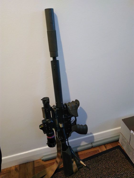

Supporters Adolf Hamster Posted May 19, 2020 Author Supporters Posted May 19, 2020 2 hours ago, Davegolf said: You building a HPA DMR or somthing then? built basically i've been obsessed with range and accuracy almost since starting this game, and my m4 has evolved over the years to the point where it's the focus of this project (basically so i can justify not being quite so zealous about doing the same as my other gats) given we're at a flat 1j limit it's sort of a "battle dmr", insofar as whilst it's a short barrel and could absolutely be at home in a speedsoft arena and can still use full auto (because why the hell not) i mostly use it in the dmr role. at this point it's not really about practicality so much as seeing what's actually possible.
Davegolf Posted May 19, 2020 Posted May 19, 2020 So you are trying to get the most effective range from 328fps? Whats the full spec on it? Diminishing returns ?
Supporters Adolf Hamster Posted May 19, 2020 Author Supporters Posted May 19, 2020 1 hour ago, Davegolf said: So you are trying to get the most effective range from 328fps? Whats the full spec on it? Diminishing returns ? well, 1j, it's a bit under 328fps when you're lobbing .48's currently it's running a gen3 fusion engine with low flow poppet, MAXX hopup chamber (with tracer which i'm looking forward to having a go with), using the standard MAXX R-nub and maple leaf macaron 40° (i think, might be 50) with the aforementioned PDI 6.01 barrel. rest of the shell is tightened down, homemade carbon free float handguard that has the double whammy of being cool but annoying purists who hate the missing gas block/tube. i do like the balance, got it to the point the centre of gravity is slap bang in the magwell. oh yes and a big can because why not have it silent diminishing returns pretty much sums it up, i passed the barrier of worthwhile investment a loooong time ago

Supporters Adolf Hamster Posted May 20, 2020 Author Supporters Posted May 20, 2020 4 hours ago, Davegolf said: What is your effective range / target size at 60M? Years ago when all the R hop hype started I gave it a good few goes and - like you by the sounds of it - found it a PITA, consistency crap and a general waste of life. Fast forward and I revisited it with an engineering approach, install is a breeze, results are amazing. Ive tried a few approaches to rhopping, tbh i still reckon the ml macaron gives the same contact patch. Also here's a pic of the heresy i'm using:
