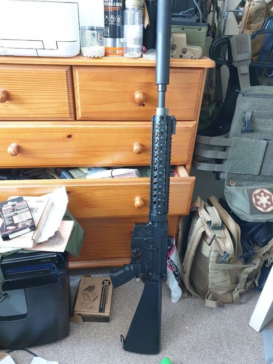

@RonLancs I've finally finished (or so I thought) my MK12 build
Just chrono'd it and with the M120 spring it's hitting about 480FPS on 0.2's! Set to hop something heavier it's still doing 450+ so I'm thinking that an M110 should be plenty (aiming for 420).
I'm about to pull it apart again though because the shimming sounds like crap but build list so far:
E&C M4 receiver
E&C V2 gearbox & interior gubbins
SLD 18:1 gears (about to get swapped for some ZCI advanced ones)
Ultimate Infinity CNC U-18000 motor
Maxx ME Pro hop unit
Maple Leaf Macaron 60 deg hop rubber
CYMA outer barrel
363mm ZCI inner barrel
Z-Parts MK12 suppressor (had to have the MK12 outer barrel machined to accept the thread as the cover it has is a dummy!)
Aster Basic V2 mosfet

Nice man. That’s what I’m looking for.. Haha, waiting for a sale to go through and I’m ordering B-06.
Where’s that rail from man?
Had to get it from Evike in the end. The one I originally got is from the CYMA "MK12" front end but it has the top rail cutout for the M110 style layout they use on the CM072 (I still have it and it's for sale if you're interested).
Could it be attached to the B-06?
Absolutely. Come with all the buts you'd need. My base build is an E&C receiver so it's the same OEM as the original Specna Arms series anyway!
You may need some barrel shims to get it lined up spot on but they're a fiver a pack!
The rail has been on and off a few times during the build process but it's never been out of the house let alone skirmished!
