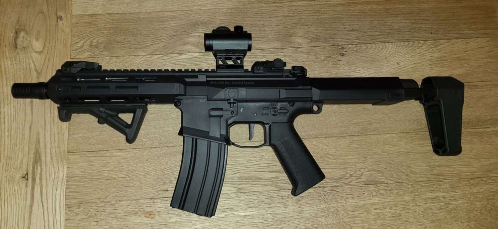

Not had a test fire yet, but I think the magnifier is too much.  Pretty impressed with build.
