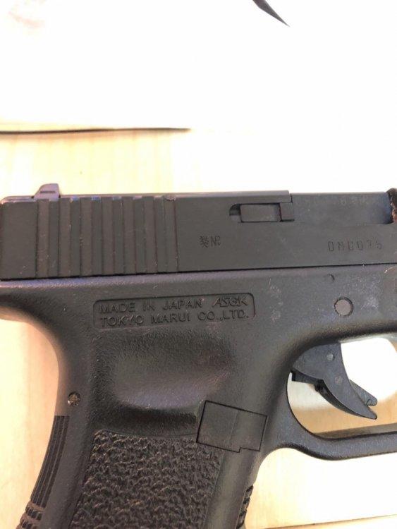

Skara Posted February 24, 2020 Author Posted February 24, 2020 Gun is a genuine TM, completely stock. The only picture I have atm. More will follow tonight, and tomorrow morning I'll post the videos.
Guest Posted February 24, 2020 Posted February 24, 2020 31 minutes ago, Skara said: Gun is a genuine TM, completely stock. The only picture I have atm. More will follow tonight, and tomorrow morning I'll post the videos. Nice, what’s the brown crap by the ejection port?
Skara Posted February 24, 2020 Author Posted February 24, 2020 13 minutes ago, rocketdogbert said: Nice, what’s the brown crap by the ejection port? No clue. I'll check it later, hoping it's not shit.

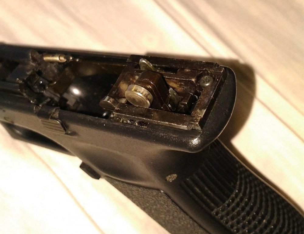

Skara Posted February 24, 2020 Author Posted February 24, 2020 Nozzle being a bitch TM trigger KWA G19 Trigger for comparison @rocketdogbert that brown stuff seems to be just sand/dirt.
Guest Posted February 24, 2020 Posted February 24, 2020 Yeah, trigger is not right, otherwise nozzle is fine Most likely the trigger bar is worn/bent, but it might be the sear
Skara Posted February 24, 2020 Author Posted February 24, 2020 Just now, rocketdogbert said: Yeah, trigger is not right, otherwise nozzle is fine What could it be? Do I have to disassemble it? I've seen a couple of disassembly videos and the amount of tiny parts is scary.
Guest Posted February 24, 2020 Posted February 24, 2020 Yes you will, yes it’s fiddly lol Ive done dozens and dozens, I can do it in about five minutes take down and re-assembly
Skara Posted February 24, 2020 Author Posted February 24, 2020 Fuck. Me. Just the trigger unit, right? I think I can do it tomorrow during lunch break. So you confirm the nozzle is 100% fine? I have also done the hot water thing to the mag and it seems to have fixed the leak.
Guest Posted February 24, 2020 Posted February 24, 2020 No, you need to look at the end of the trigger bar and the hammer unit. You may not even need to replace the sear if it’s only the trigger bar that’s bent

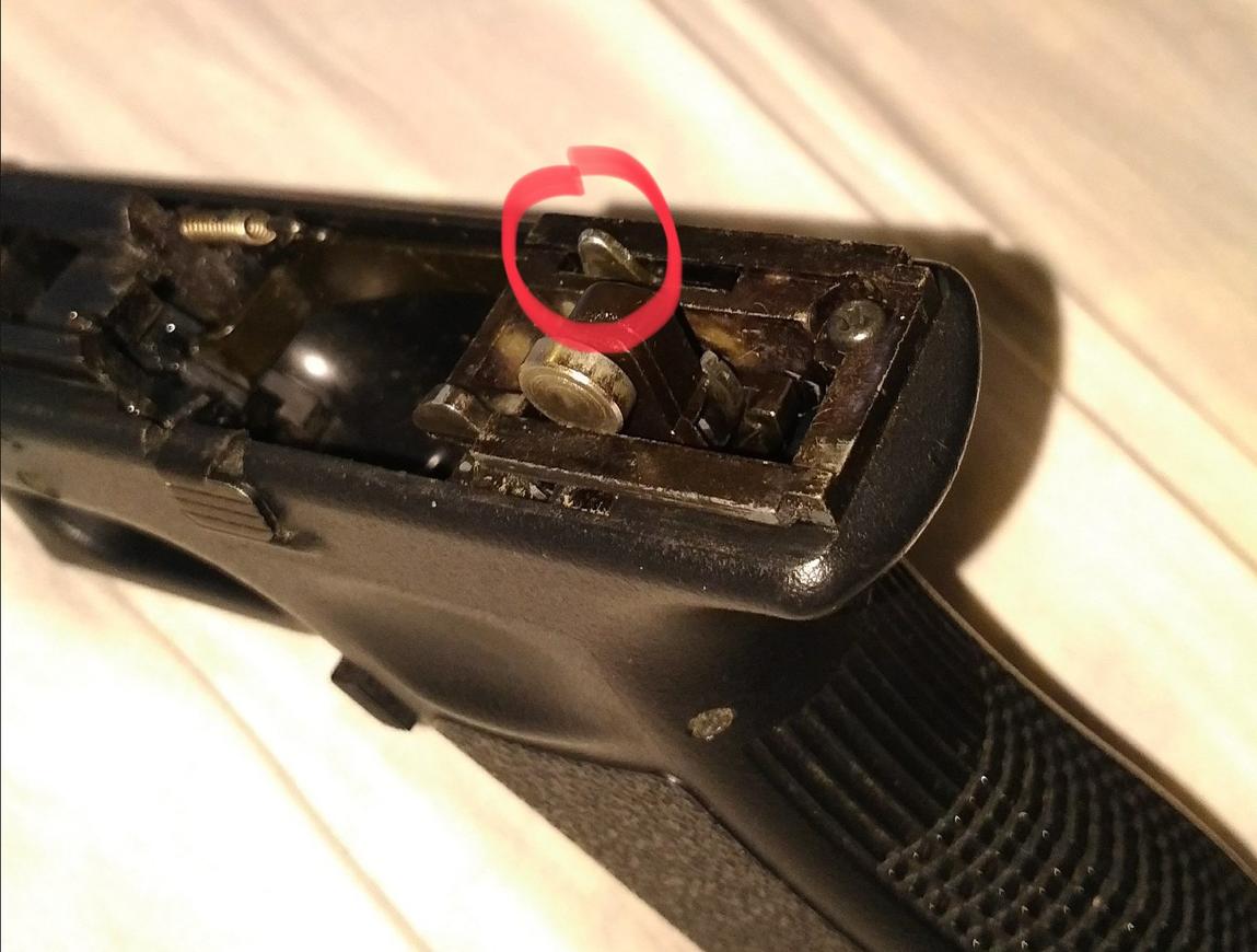

Skara Posted February 24, 2020 Author Posted February 24, 2020 There are 2 bars, the right one is linked to the trigger and is slightly bent to the left. The left one is slightly bent to the right. It's almost unnoticeable though. Safe to assume they should be perfectly straight, right? Sorry for the dumb questions but GBBs are new to me
Guest Posted February 24, 2020 Posted February 24, 2020 This is the tip of the trigger bar, you’ll need to disassemble the gun to get it out. If you manually push down the hammer until it locks into place, then pull the trigger, the hammer should fly up every time. You need to push down the trigger bar tip to reset the sear before you can lock the hammer down again
