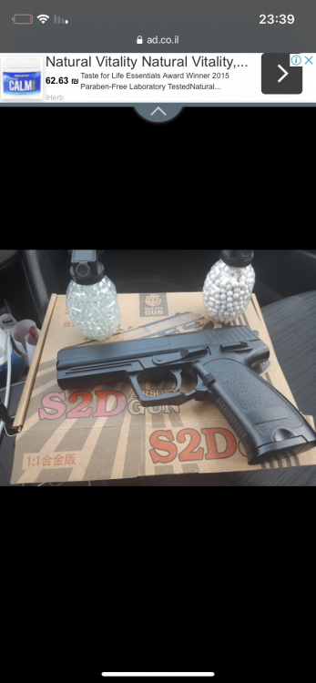

Hey, I’m about To get a new Airsoft pistol named s2 it’s a full metal spring powered Chinese Airsoft from red pig company, the pistol is about to come with glass bbs , my question is can I use glass bbs with this gun or would it damage it?
i would also like to get some beginners tips about how to maintain my gun to keep him working as long as I can even though it’s a cheap one.
thanks

So first of all , no I’m not from the Uk. I intend Only to shoot targets , it ain’t meant for games , also it is a spring powered so it’ll be a bit difficult..
my worry is that I’ll use the glass bbs and damage my gun unintentionally , even though the one who sold it to me said that he’s always selling the glass bbs and had no complains , but i preferred to ask here to get another answer..
Btw if you have some websites that I can buy quality plastic bbs from there it’ll be great(shipping abroad option needed)
thanks

I highly doubt the bbs supplied with that actually will be glass. Its a relatively inexpensive spring usp usually sold under the HFC brand. Also not full metal although the internal has metal parts and the gun is a reasonable weight for a springer. The hop as standard will lift 0.12g 15-20m and fairly inaccurately I would add. I have one myself, the hop can be modified to lift heavier but it's not straight forward for someone who doesn't know what they are doing. I highly doubt glass bbs would be supplied with such a gun. More likely clear plastic and likely to be very poor quality. From other low grade 0.12g clear plastic bbs I've seen. Usually bad seem lines. And if they are glass certainly wont harm it provided they ar well formed but maybe heavy for it. If you are expecting to bulls eye womp rats I would reconsider your options.
nb: Scratch that its not an hfc, just a very similar shape in the molding. After zooming in it looks to have molded controls including the normal hk mag release and have a conventional button mag release added instead. If its a zink molded china made springer lord knows what it could be like hop wise. They can be quite crappy quality internally and break quickly. Colour me intrigued I like an obscure springer.
