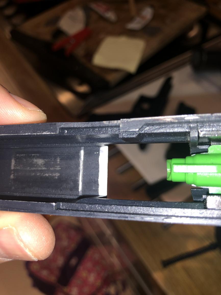

What needs to be filed on the WE's slide?
I’ll try and take a picture later.
If you file a shallow ramp on the inside of the slide at the front edge of the ejection port the slide cycle is much smoother as is the barrel tilt. The smoothness of the cycle has an impact on gas efficiency and accuracy.
obviously if you go too far you will ruin the slide. Also if you do it badly (I.e the ramp is uneven) then you can do more harm than good.
Here you can see the slope I filed into the underside of the slide at the front edge of the ejection port. Make sure the slope is even and don’t file too far or you will ruin the slide. If done properly there should still be a step of about a tenth of a mm if material at the front of the ejection port. If done well it will be invisible from the outside of the pistol.
I strongly recommend anyone attempting this do the filing by hand rather than trying to use a multi tool.
I have a WE Gen 3 G17 as my sidearm and it is a workhorse of a pistol. I might give the above mod a go and see if it makes a difference.
