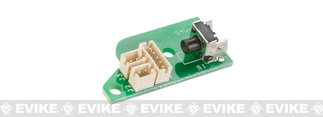

If your playing mostly Semi ( and mostly semi auto spamming) then i would recommend the Polarstar Fusion Engine for that, the JACK (and other JACK like clones which replace the cylinder assembly) are ok but not as good.
You're gonna ask why so ill give you my two cents and explain this as best as i can, from here on end i will refer to the Fusion Engine as FE and the JACK as JACK but this will include any HPA kit which replace the cylinder assembly such as the Redline N7, Wolverine et al.
It all really boils down to one thing, the trigger switch on the trigger board.
See the below picture which is for a Polarstar JACK, the trigger switch is indicated by the "S1", the actual switch is the white rod coming out of the switch on the left hand side of it just below the "J2" letters.
polarstar-68290_1200x1200.jpg?v=15200423
Now see the Trigger board for the FE, the trigger switch is again indicated by the "S1" and the actual trigger is the black rod poking out.
So whats the difference?
Well its how the switches feel, see the JACKs switch does not give a tactile feel when you pull the trigger. When you pull the trigger it hits the white rod, as the rod goes in somewhere between the top and bottom of its travel is the "FIRE" Command, keep it pressed and it will either do full auto (when in full auto) or just fire the one shot (in semi). Getting it back to reset requires you allow the trigger to fully disengage before you can loose off the next shot. Like i said hard to explain but much easier to notice when you have two guns and compare them side by side.
The FE on the other hand has a "clicky" tactile feel when the "FIRE" command is given, its very similar to hitting a mouse button, the fast you pull the trigger, the faster it can shoot. I have managed to obtain about 12RPS using semi only on my M4.
Also its much easier to mod the FEs body to make any trigger a speedy one. If you look at the photo below you will notice that my trigger in the HPA lower is already quite far back when compared the AEG lower which has a TITAN in it. Just pulling it a millimetre will actuate the FE switch and fire the gun.
