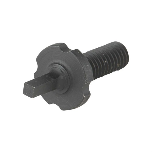

AshOnSnow Posted October 26, 2017 Posted October 26, 2017 If it's a a standard M4 front sight, you need an adjustment tool. They should be easier to get a hold of than they actually are, especially with so many people using M4s for Airsoft. Airsoft places don't seem to stock them (probably because nobody bothers adjusting their sights much for something as inaccurate as Airsoft), so you'll need to get it from a gunsmith (who also don't tend to stock them since even among shooters, people in the U.K. aren't generally a target market for AR15s), or online from somewhere like brownells. Probably get them off eBay too. https://www.brownells.co.uk/AR-15-A2-Front-Sight-Tool-4-Prong-DPMS-749000641 The front sight post is fixed with a screw, and should look like this: https://www.brownells.co.uk/WebRoot/MediaDefinition/userdocs/skus/l_231000128_1_l.jpg The four prongs on the wrench fit into the 4 grooves on the post. You need these prongs to push down a locking pin which is set on a spring and prevents the sight from turning.
