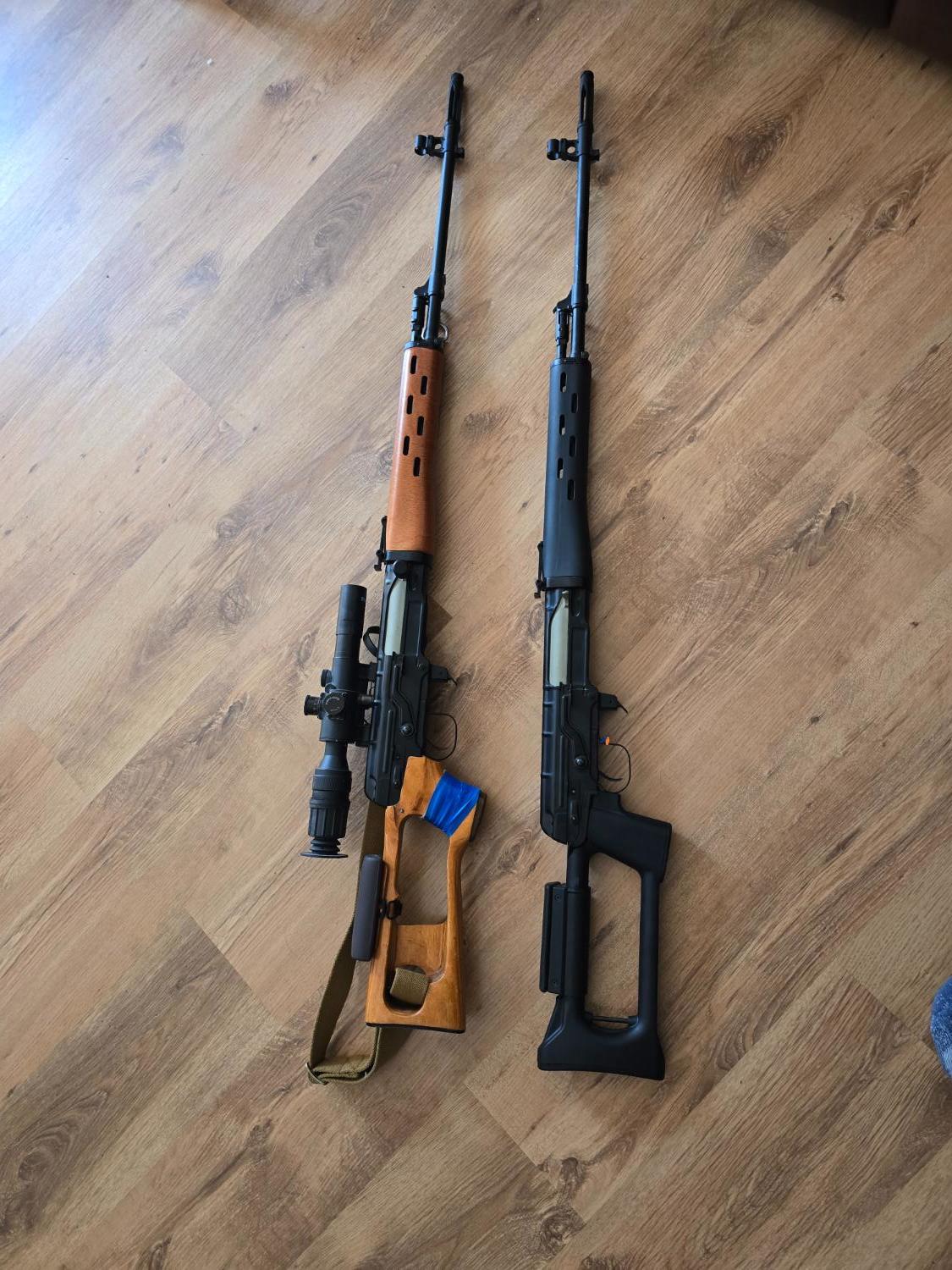

This is how it currently is.
Not used it in a while though, I have to say.
I find DMRs to be kind of awkward, I'm likely to use either a bolt action or a normal AEG more often, I should remedy this in the new year!
I primarily LMG, but the SVD is just beautiful! (As is yours!) I did quite enjoy the more laid back approach to being a DMR though

Well, I have finally found the cause. After putting the stock piston back into my replica it was still all over the place. Fast forward a few days and I buy a lovely replacement from @strykerles
For shits and giggles I figured I’d try the hop up from his (Which was consistent with nearly every shot) and my old wooden furnitured SVD was also consistent! Huzzah!
2 hours ago, ButcherBill said:
Just as well you noticed the cracked piston before you threw it out.
Wood ones being retired anyway, stocks getting really wobbly due to poor securing points. Only used it once ? it’ll be a place holder until I can afford a real sword or LCT
