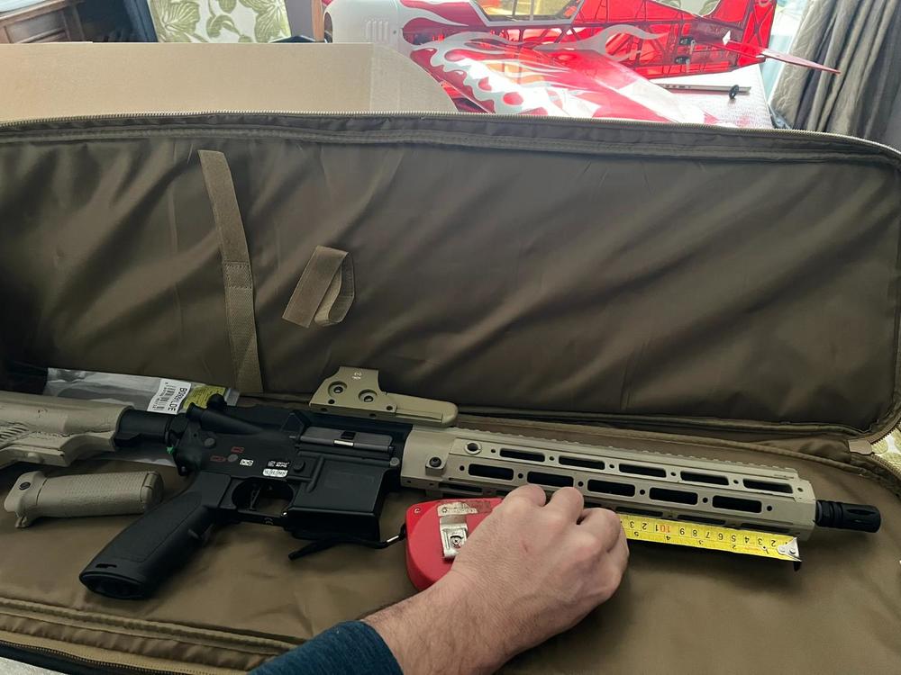

Usual story, old man joins his kids for some airsoft and finds that he actually enjoys running around like hips are easily replaced and knees just miraculously repair themselves. A few days later he buys something he is completely ignorant of but looks awesome and is apparently "decent."

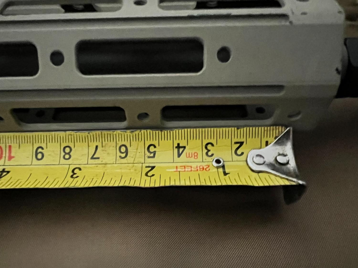

Picked up a Specna Arms SA-H22 Edge 2.0, which is a great gun but is teaching me a painful lesson about the sizing on rails. Have had shops tell me it is M-LOK / MOE whilst others have said they do not know what it is> Apparently it is Specna's RAHG system according to forums and Reddits.
I have no idea. Just a foregrip would be nice!
Is there anyone out there that has gone through this? I am even open to the idea of buying a whole new handguard if it makes the problem go away - if you can recommend one - PLEASE DO!

Ah yes, magic knees.
That rail is indeed a copy of the Remington RAHG. There's also ones that are a copy of the Geiselle one that isn't M-Lok either. There are little rail sections that screw onto the holes between the slots or you could change it to an M-Lok rail. Depends how spendy you want to get really.
https://www.davescustomairsoft.co.uk/h-series-rahg-rail-black
TM’s suffer the same spacing affliction
I got round it by cutting off one of the “nubs” on a MOE m-lock stubby foregrip, and then used the one m-lock and one of the threaded holes in the handguard to secure it. Solid!

Ares Honeybadger seems to be the same, nothing I had would fit but I couldn't be bothered buying rails for it at the time, luckily it came with a bottom rail.

Thanks all - super helpful.
I am off to a semi-local shop at the weekend for a consultation on a fix/solution and how to move forward.
Regarding how spendy I want to get, I am eyes open on how the hobby grabs you. In my opinion, it is not a case of what gun do I want to buy. It is a case of which one I want first! Lesson learned on the rails though.
Problem: too many conflicting rail mount solutions.
Solution: add another rail mount solution.
Well, it is a solid choice of gun, and making do is half the fun of airsoft.  Given that Dave's seems to be drop shipping those rails, I'd be looking at eBay / AliExpress for cheap rail section that specify dimensions, and seeing if they match up to the holes that you have.  A bit of drilling and bodging (or gluing) should see you right.
Nice PA Addiction in the background.
I would just buy the RAHG rail sections from Daves Custom Airsoft - I'm not sure it's worth the hassle of replacing the whole rail.
