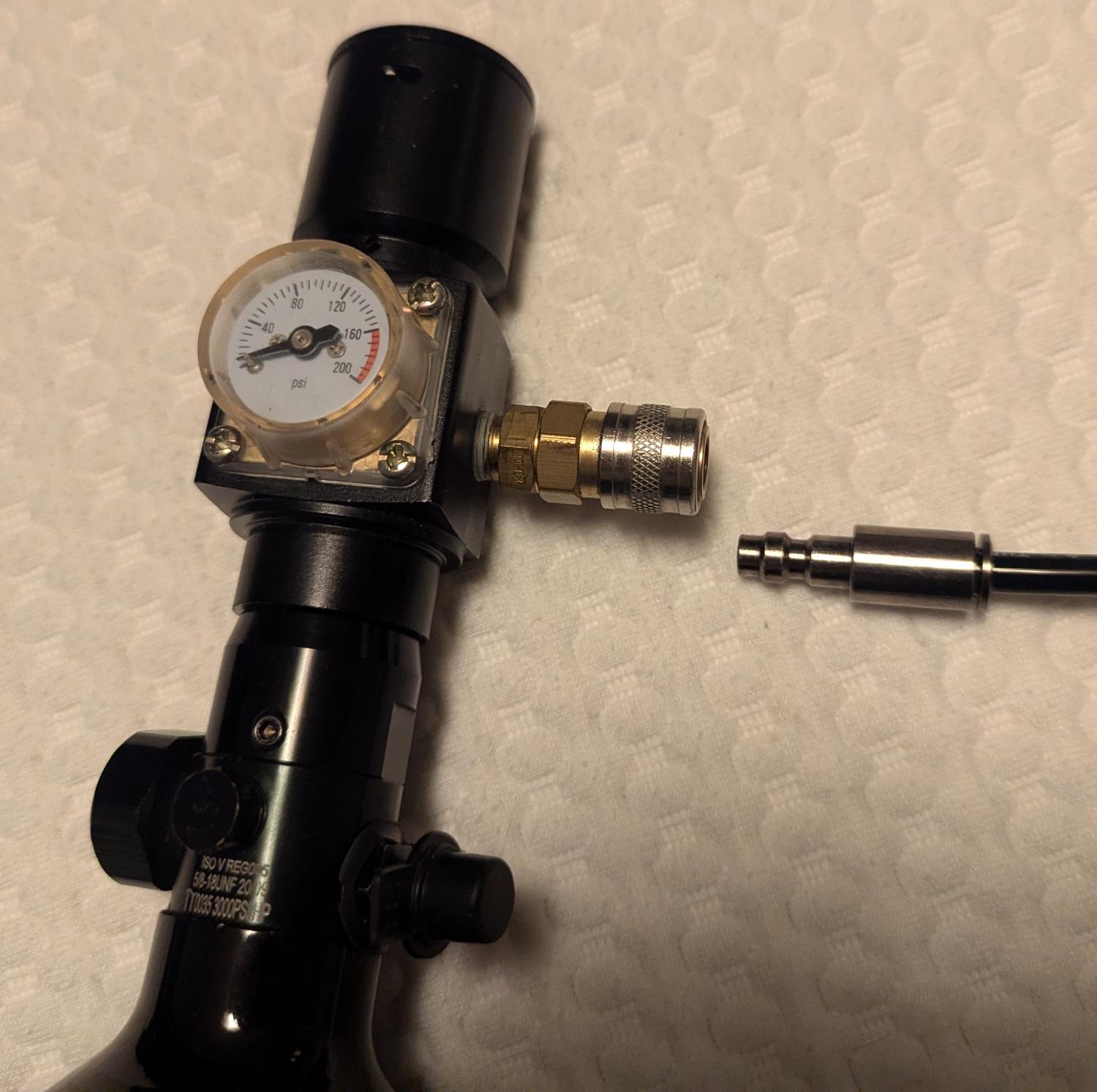

The fitting on the right is the tail coming off the magazine adapter... I presume I'll be aiming for about 80psi into the gat, so a 200psi line would be fine.
I have a proper chunky metal line coming off my own scuba tank, so don't need another whip line...  I think!
Watching YT vidz (which of course I should have done earlier) looks like a simple line with quick disconnects on each end will do just fine.  I perhaps need a key for the pressure regulator, though I can turn it just with my thumb pressing down on it so far... Not sure if that'll be the same once it's pressurised, so best get one?

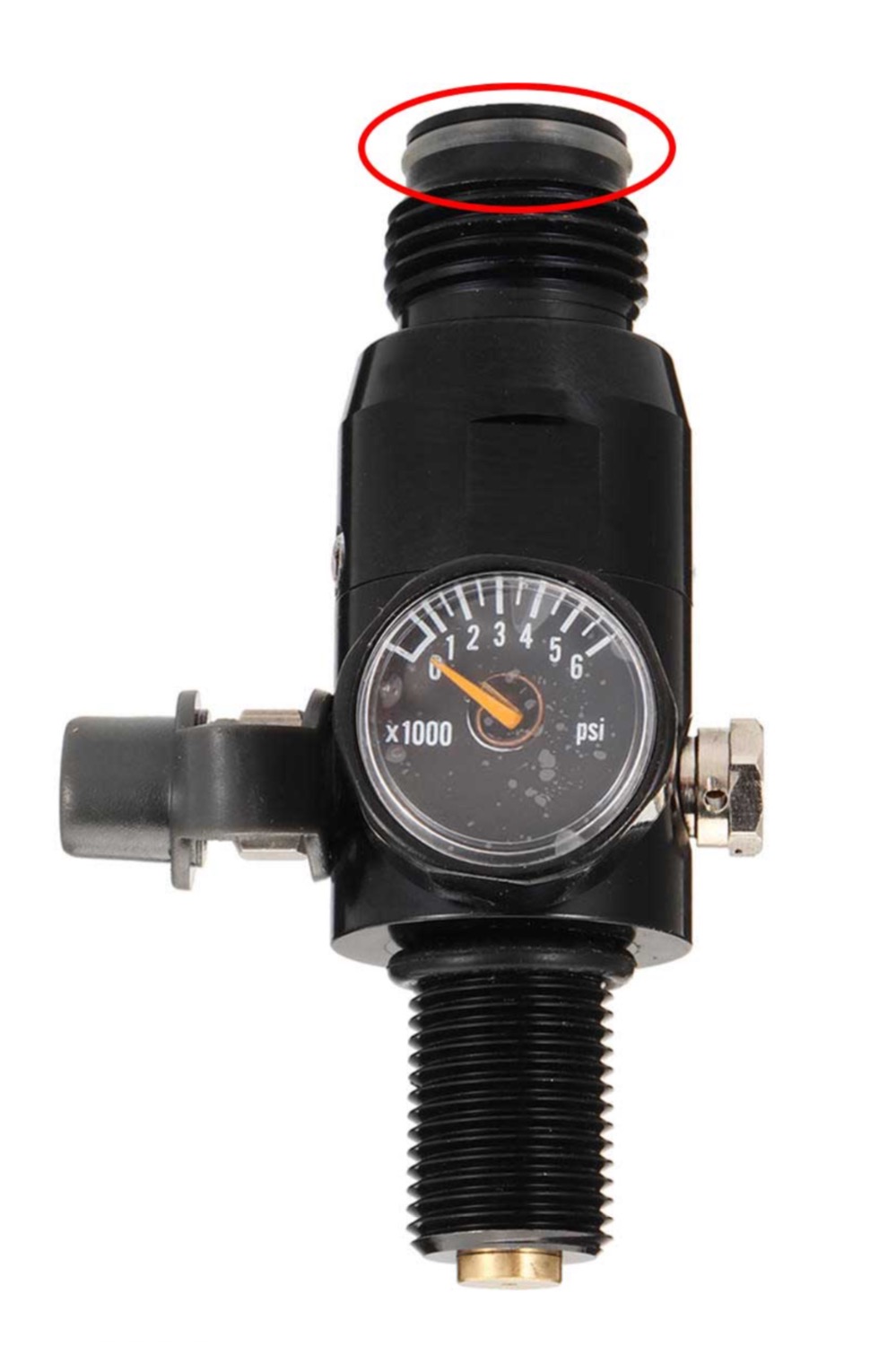

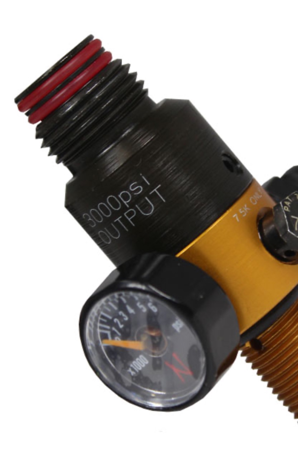

The ‘standard’ bottle o-ring would sit further down, which in paintball would be the top of the cylinders bonnet,
(as per the images below) whereas your problem o-ring is further up and as discovered a little smaller
