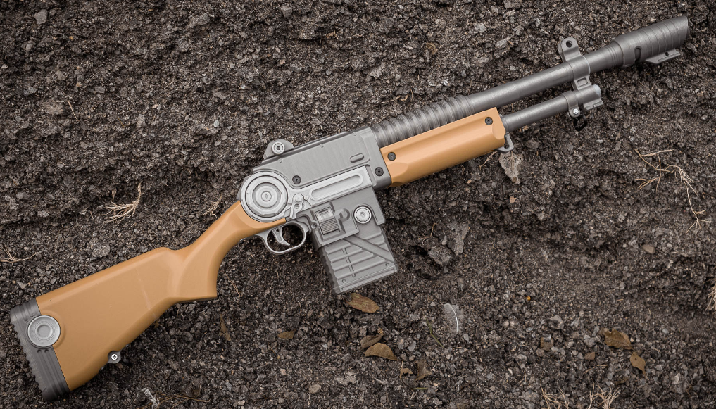

I found this really cool cosplay probs on cults. They are optimised for 3D printing and just look great. But that's it. They don't shoot. I want to change that.
I could just buy any airsoft take it apart, measure the parts, modify the files, print them. Done. But then all the time I spend on redesign wouldn't benefit anyone else. And that's a waste.

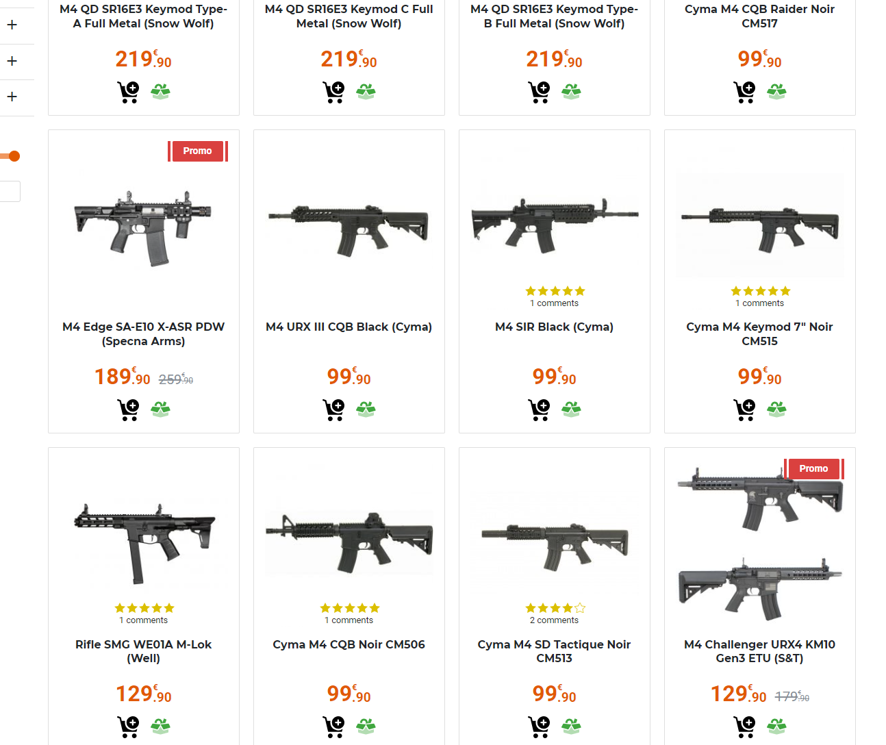

So, I'm looking for an airsoft gun that is international available (there must be some big brands that ship everywhere), cheap (I want to keep the entry barrier low) and preferably available in different power levels.
It doesn't need to be a full gun, just the interior would be enough. And if there is one that can be bought with different power output (0,5J up to whatever is legal) but with the same mechanical dimensions, it would be perfect.

While I always like to see the effort people put in to the more obscure  airsoft builds, looking at those two pictured, can't help but notice the similarities between a Scar H & an 870 style shotgun ?.
Would it not be more practical to make dress up kits for recognised guns, after all the big names such as TM have done the hard work & are readily available, body kits that dress up the available guns, maybe 2 part clam shell style that wrap the bodies, retaining the strength (& financial value) of the model within.

To adujst the files, so I can fit the internals of a air soft gun inside is a lot simpler than adjusting them so I can fit a whole gun in them. And it's always going to look better if you have a complete redesign instead of a some bits glued to a existing gun.
And it's gonna be fun to make it. I'm neither into airsoft nor cosplay. The fun part for me is making it work.
If I ever start working on a Bolter, it's probably ok, just to hide a full gun in it, because it's so large. But with the Lasgun, I don't want to make it too large.

The Lucius pattern is basically a sci-fi BAR.
Entry level, easy to adjust, cheap - Sounds like a standard M4. Also matches the magazine profile with the 20 round VN style mags (Again, cheap)

CYMA would be the default choice to use for development as they're an actual OEM and should (there's that word again) be consistent across the range, from their cheapest plastic CM.5xx guns, up to the metal receivers with trick gearboxes and electronics.  However, there are many (many, many) other affordable options: Specna Arms, Lancer Tactical, Double Eagle, all of which have quick change springs (which the cheapest CYMAs don't) and any of which ought to be workable with perhaps some slight modification to the dimensions, either before printing or with some filing or filling afterwards.

However, as adjustable power is a (sensible) goal, as an end user I'd be more likely to choose something with a quick change spring system as a base.  Since half the base gun is going to be discarded anyway, a Specna Arms SA-F03 FLEX (for example) would do fine.  It's really down to local prices and availability where you are - I mention Specna Arms as those are cheap and readily available in the UK, but it really won't matter what you get as long as it's TM / CYMA compatible.

For the emperor! That's really cool. I'll send you the link as soon as the files are ready. At first I need to buy a M4. The CYMA are 100€, the Specna Arms 175€. So the choice is simple. I found a "Double Bell M4" for 55€. According to the description it has a V2 Gearbox and can take any TM compatible magazine. So it's also compatible to CYMA/TM? 55€ sound a lot better than 100€, especially considering I'm going to take it apart anyway
Hmm. It's cheap because it has a plastic gearbox, and is running at under half the power of a typical metal gearbox AEG, which likely means a light spring and a cheap motor.  However, as you only need it to get the dimensions right then it should do the job. It even sounds like it has a modern rotary hop unit rather than the older dial style - both types of unit are interchangeable, and taking TM mags is a good sign.
One consideration is that even the cheapest CYMAs come with a basic NiMh battery and charger, which will let you test the shooting performance. The Double Bell does not, so you'd have to spend extra on a battery and charger, which will push the price up by a surprising amount.

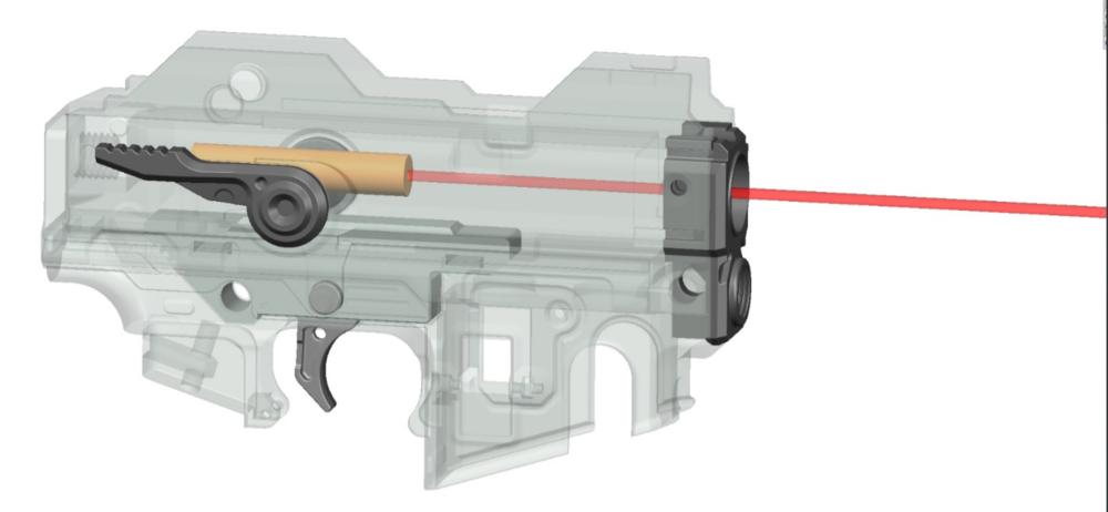

The very first step is done:
I got the CAD files for the laspistol and will now modify it to hold a cheap laserpointer. This is a very first test on how hard/easy it is to modify STEP files, print them, test them etc.
Once that's done @Rogerborg will be able to built his most favorite cat toy ? and I will move on and start working on the lasgun.
