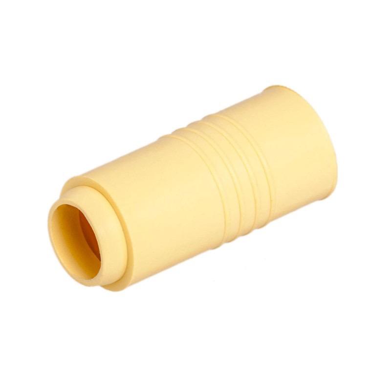

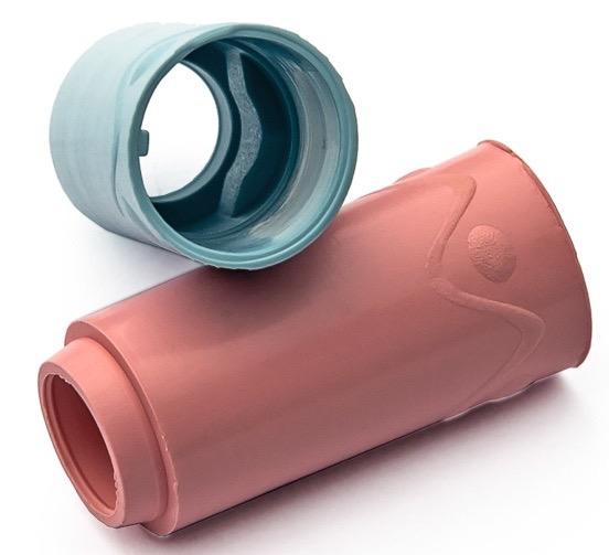

Yeah, using a macaron. The one I got has dots and a wave around it, the other ones I’ve had in the past have been smooth with 3 ridges. Maybe I’ve ordered the wrong rubber ?

The pink/blue is what I have (But it’s yellow), and the yellow is what I’m used to getting. I assume they changed design or something?
That is just to differentiate the older macarons (3 stripes) from the newer super macarons (wavy pattern).
The main difference is the additional supports next to the contact patch and the patch being slightly wider/longer on the super variant.
