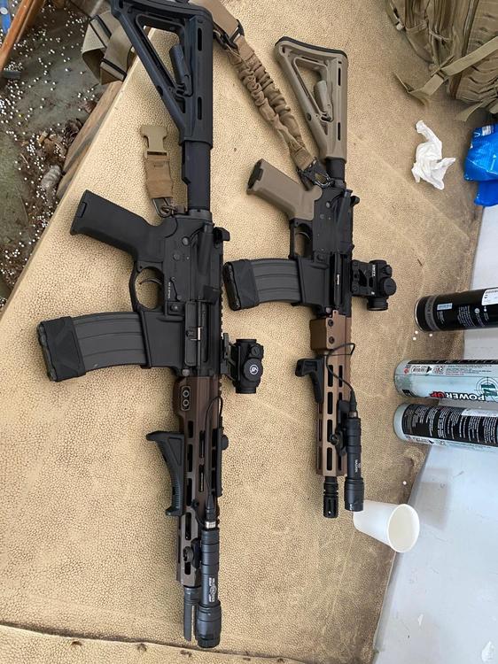

Hello guys, sorry to bring this up but im from Portugal and im about to go get my baby girl back!
the weather in Portugal is much warmer than here and i cant find the gas thar i used (Puff dino 12 without silicone ).
What are you guys using? Thanks in advance!
 PS: I own the left one! ?
