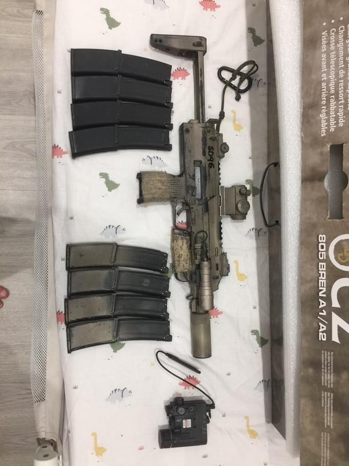

Sd96 Posted May 7, 2024 Share Posted May 7, 2024 I have one I might sell, gen 2 umarex/vfc mp7. Comes with 8 gas tight mags, aimpoint red dot sight and torch. I’m asking £550 Link to comment Share on other sites More sharing options...
