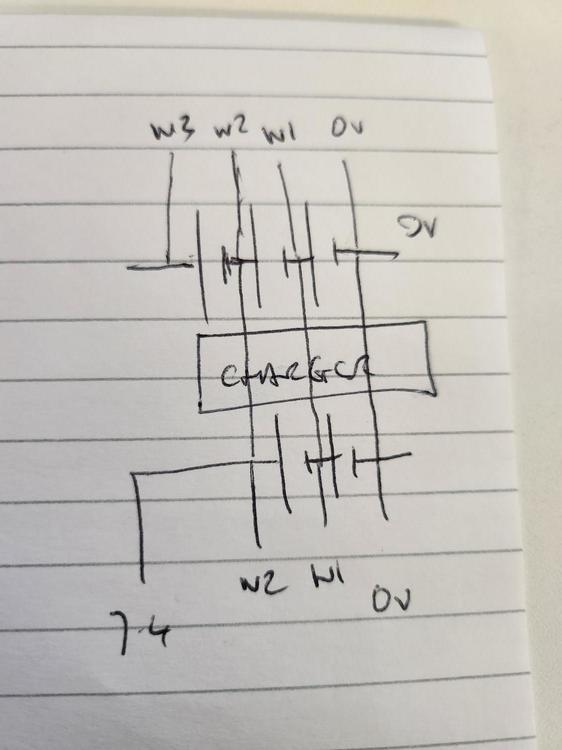

Somehow, I've manged to  charge a 7.4v lipo, whilst simultaneously discharging  a single cell of an 11.1v battery I didn't realise was connected to the charger at the same time.
I didn't think that was possible on a balance charger, but there you go.  Cell 3 is sitting at a little over 4v so I'm guessing it is screwed.

I think what happened is that I charged a 7.4v battery, not realising there was an 11.1 still connected (it was flopped over the side of the counter).
So somehow my charger has jammed 8 volts worth of angry pixies into 2 cells, whilst leaving cell 3 alone (4v).
I would have expected the charger to see these two cells were at the correct voltage though or at least move angry pixies from one battery to the other.

I don't see how a lithium cell can be 8v. It may be that the charger balancing resistors or other bits are damaged and the voltages are being incorrectly reported.
What's the voltage of the whole pack?
I'm assuming you are using a meter to measure those.
I'm sure you can see the anomaly there.
The lithium's won't be 8v. There is chemistry than prevents it.
It's possible that the balance wires are screwed up because that looks like 4 + 4+ 0 and it's being measured cumulatively.
The balance wires, 4 of them for 3s will have, from 0v, 4 8 12v on each wire moving from 0v.
0v to wire 1, 4v
Wire 1 to wire 2 4v
Wire 2 to wire 3 4v
0v to wire 3 12v.
Apologises if I'm teaching you to suck eggs, but the numbers aren't right.

The red wires have a voltage relative to each other.
The voltages you are measuring are cumulative.
Measure between each red. The 4v red is cell 1.
One of the red to red connections will be 0v

Yes the reds are on the positive of each cell.
So one red will be the pos of cell 1 4v with ref to 0v
The reds between cell 1 POS and cell 2 pos will be across cell 2.
The reds between cell 2 pos and cell 3 pos will across cell 3.
You can measure cell voltages in this manner.

Yeah just done it after using up some Google Fu.
One cell is totally dead.   Other two have a healthy voltage.
Funny how the brain works.   I knew the voltages of the cells were added together.  I just didn't twig it would be cullmulative on the red wires on the balance plug.  Just the Deans.
Not going risk pushing a charge on it.
