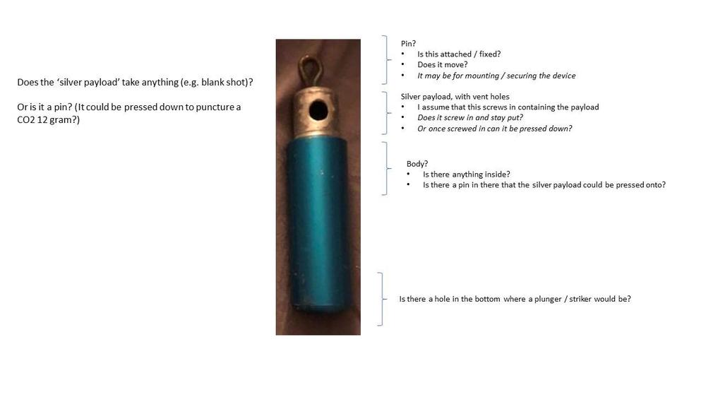

Hi,
Can anyone identify the airsoft trip wire mine on the right and explain how they work- or confirm my thoughts that there are parts missing
unlike the one on the left there is no plungers to reset the spring on the firing pin and no safety pin hole
google has failed me
any help appreciated
EDIT : PS I know the left one is a dynatex scaremonger

Can you give more pictures in other angles?
Are there signs of equivalent parts being missing or that the design does not appear to account for such parts ?
Going in blind, I’m assuming that it’s a blank firer which sets off by a striker pin on the the plunger
But devices can be many things, blanks, crow scarers, 12gram co2 cartridges etc
the holes look like the safety side vent of a blank firer.
More information is needed

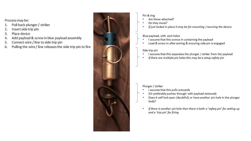

Slide1.thumb.jpeg.cc7ab6b61e3172247ebfd1c8da0ff29e.jpegSlide2.thumb.jpeg.72329d89b2459e036372aa86118f72f9.jpeg
It's a Dynatex Scaremonger Blank Firing Trip Mine according to google, they come in .209, 9mm and 12g flavours. Unfortunately I can't find much more than that. If you get it working please let us know what they're like as I'm always interested in stuff that goes boom

So to answer some of the questions raised, -rest I know that the one on the left is a dynatex scaremonger - I have owned that for years and know exactly how it works. For the benefit of @Tommikkaand his helpful images, they both take 9mm blanks placed in the screw in top (vented section) the left one is set by pulling the plunger outwards and pushing in on the central pin that passes through the plunger to lock the firing pin in the primed position (which has the effect of priming a spring loaded firing pin) the central rod going through the plunger can be very easily pulled out and this action releases the firing pin to fire the blank.
fishing line (normally) is then tied to both half’s via the rings, and secured to a fixed point with the line crossing a trail or doorway, contact with the line pulls the in and bang ‼️ grenade kills for all those with whatever blast range your site sets (10m in my case)
it’s the one on the right I am interested in identifying, it appears to work on the same principle, but I cannot see how to prime it, if I can identify it I can find out if parts are missing or broken off, such as the plunger shaped priming device.  For those asking for different angles there is nothing else to see, it’s a plain blue metallic cylinder- unlike the dynatec scaremonger it does not have a central safety pin hole, it has an almost identical spring loaded firing pin, which I can press down on, but there is no way to lock it in the primed position.
any help to identity it is great, PS I’ve searched bird scarers, security trip wires, and many other terms, involving blank firing devices lol, lots of similar things but nothing the same

The one on the left is a scaremonger, the one on the right isn’t, it’s the right one I’m interested in
I keep having thoughts that it’s a pressure mine, which would reflect you not having something to lock it as primed, but that would only work if the pin / blank can be impacted properly when stood on etc
So I think that you are right that mystery object which needs to be recognised to establish if something is missing or the priming method needs to be identified

The pressure required to “detonate” the dyntatec one (left) is very low, no more than a few pounds of pressure, and less than a centimetre of movement in the release pin to pull it out.
the other is on the same principal - spring loaded firing pin, it must be missing parts to set - which is why I need to identify it, lol 😂
