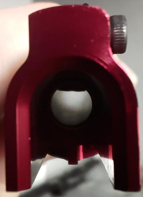

MrTea Posted October 15, 2023 Author Posted October 15, 2023 10 hours ago, Leo Greer said: I have no clue where AirsoftPro falls on the lineup of Tawain/China/HK, but they all have different specs, courtesy of the wonderful airsoft industry. It's a 1:1 copy of the stock A&K hop unit but CNC aluminium. IIRC A&K is a Chinese brand. 10 hours ago, Leo Greer said: Prommy should fit as well (I’d recommend purple), but they tend to be kinda expensive. I managed to find a Prommy purple (just in case I fuck up adjusting the ML hop rubber) and the pack of soft/hard flat nubs for £24. Will be a nice backup and if not needed just sit in my spares until next time 10 hours ago, Leo Greer said: For a nub, I usually just use a piece of 8mm tubing cut into a rectangular patch, glued to the hop arm. This creates a concave contact patch and ultimately a similar effect to an MR. Hop that works with any rubber and barrel. You can adjust the height by either sanding it or adding layers of tape. Or you can simply cut your own nub out of hard plastic using small files. It can be flat or concave, either works. Then attach it to your hop arm (maybe sand the hop arm flat), with superglue. That's a nice bit of info going forward, cheers. Leo Greer 1
Colin Allen Posted October 15, 2023 Posted October 15, 2023 12 hours ago, Leo Greer said: I have no clue where AirsoftPro falls on the lineup of Tawain/China/HK They are in the Czech Republic.
Leo Greer Posted October 15, 2023 Posted October 15, 2023 1 hour ago, Colin Allen said: They are in the Czech Republic. The question is what specs they're using. Chinese/Japanese/older units are often designed for thinner, shorter rubbers, whereas Taiwan/HK/newer units are often designed for thicker rubbers with longer lips. If it's a perfect 1-1 copy of the A&K unit that'd be awesome, and it should work better with the Prommy rubbers, Modify rubbers, and PDI rubbers, though @MrTea will be able to tell us more as he works on it. ?
Colin Allen Posted October 15, 2023 Posted October 15, 2023 5 hours ago, Leo Greer said: The question is what specs they're using. Chinese/Japanese/older units are often designed for thinner, shorter rubbers, whereas Taiwan/HK/newer units are often designed for thicker rubbers with longer lips. If it's a perfect 1-1 copy of the A&K unit that'd be awesome, and it should work better with the Prommy rubbers, Modify rubbers, and PDI rubbers, though @MrTea will be able to tell us more as he works on it. ? Ah, in that case, it definitely prefers the older style rubbers.

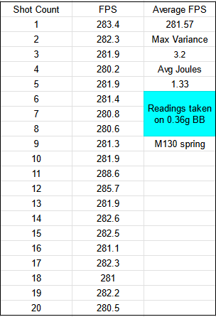

MrTea Posted May 30, 2024 Author Posted May 30, 2024 (edited) So, over the winter i've not really touched this project until a week or so ago. Previously, I had stopped working on it at the stage of finding out that Maple Leaf hop rubbers don't work too well in this gun. I've still not fixed this and so far i'm just working with the stock bucking because I know it works and, at the minute, i'm trying to boost power closer to the limit for DMRs. On an M130 spring I was getting the following: These reading were taken back in October. As a preemptive measure, I had ordered an M150 spring and dropped it into the gun a week or two ago but only just got around to testing it today to get the following: A nice bump in power bringing it closer to the limit. This translates to about 420fps on a 0.20g BB with the max joules being 1.88J. I've still got some additional headroom but i'm hoping the Maple Leaf bucking will give a slightly better seal and creep that number up a little bit more. I'm going to have a go at smoothing down the Maple Leaf bucking tomorrow and retesting it then but failing that i've got a Prommy Purple ready just in case. On a standard V2 gearbox and full cylinder I don't know if i'm able to get much more power out of this. M160 and M170 springs exist but i'm wondering at what point do the working parts fail to compress the stronger springs. Ideally, i'd like to get this right on the border of 1.88J Edited May 30, 2024 by MrTea
Leo Greer Posted June 8, 2024 Posted June 8, 2024 On 30/05/2024 at 21:05, MrTea said: On a standard V2 gearbox and full cylinder I don't know if i'm able to get much more power out of this. M160 and M170 springs exist but i'm wondering at what point do the working parts fail to compress the stronger springs. Ideally, i'd like to get this right on the border of 1.88J I run an M170 (SP150) in my V2 DMR @ 2J exactly on .48gs. I run it on XYT 18:1s and a T238 33K @ 11.1v and it has no trouble cycling. You can also pair a good high torque with something like a 20:1 set or even 32:1 if you really wanna be careful.
MrTea Posted June 8, 2024 Author Posted June 8, 2024 (edited) 7 hours ago, Leo Greer said: I run an M170 (SP150) in my V2 DMR @ 2J exactly on .48gs. I run it on XYT 18:1s and a T238 33K @ 11.1v and it has no trouble cycling. You can also pair a good high torque with something like a 20:1 set or even 32:1 if you really wanna be careful. Thanks for the insight. I've gotten a M160 spring in prep for modifying and testing the ML MR Hop 70 degree bucking but I seem to have misplaced that hop rubber... somewhere??? Not sure how i've lost it but i'm on a drive to consolidate all of my spare parts + tools into something that I can carry onto an airsoft field (due to a recent crappy experience) and work with so it may turn up in a random box when I break everything down. This is why I haven't updated the post since last week plus yet another boneyard rifle made its way to me... which I still haven't started work on. Edited June 8, 2024 by MrTea Leo Greer 1

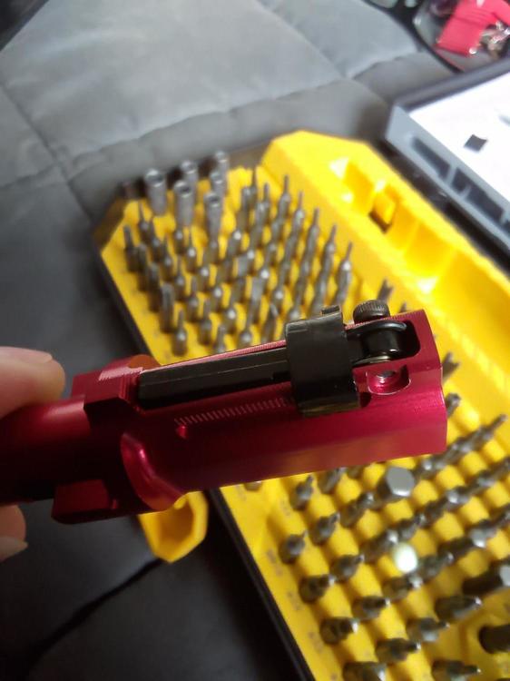

grumio Posted June 9, 2024 Posted June 9, 2024 Out of interest did you get the ambi selector working well? I'm currently working on one of these and I've got it functioning but it is extremely sloppy and awful to use.
MrTea Posted June 10, 2024 Author Posted June 10, 2024 (edited) 18 hours ago, grumio said: Out of interest did you get the ambi selector working well? I'm currently working on one of these and I've got it functioning but it is extremely sloppy and awful to use. The left side of the rifle is solid and functions great. The right side functions but I wouldn't use the right side to change which fire mode. It's somewhat loose but it does move the way I'd expect. Edited June 10, 2024 by MrTea
grumio Posted June 10, 2024 Posted June 10, 2024 2 hours ago, MrTea said: The left side of the rifle is solid and functions great. The right side functions but I wouldn't use the right side to change which fire mode. It's somewhat loose but it does move the way I'd expect. Nice thread by the way, found it really helpful just reading through. That's also funny that the right side on yours is worse, on mine the left side binds and feels coarse but the right side is really easy to to move. Is there anything you found that helped with getting it working smoothly?
MrTea Posted June 10, 2024 Author Posted June 10, 2024 4 hours ago, grumio said: Nice thread by the way, found it really helpful just reading through. That's also funny that the right side on yours is worse, on mine the left side binds and feels coarse but the right side is really easy to to move. Is there anything you found that helped with getting it working smoothly? I didn't do anything special honestly. I just re-assembled it and left it how it was. Sorry I can't help more. grumio 1

MrTea Posted June 21, 2024 Author Posted June 21, 2024 1 hour ago, Lozart said: SHS springs can be quite wide tolerance. Pick a spring brand you like and trust (*coughs* XT @ak2m4 *cough*) and stick with it. That was what I was going to do initially however it appears his XT springs don't go past M150. Up until this point, it's exactly what I was using. 1 hour ago, Lozart said: For the love of GOD don't start chasing FPS limits. Not yet. Now i'm closer to the limit, and have it chrono-ing consistently, i'm going to give it a test on 0.36g BBs to see how it's performing. Lozart 1
ak2m4 Posted June 21, 2024 Posted June 21, 2024 M160 are arriving in a few months however what's going on with that build? Never worked on a Masada personally but why so low power ? Hudson 1
Supporters Lozart Posted June 21, 2024 Supporters Posted June 21, 2024 3 minutes ago, ak2m4 said: M160 are arriving in a few months however what's going on with that build? Never worked on a Masada personally but why so low power ? I was wondering the same, my MK12 is doing 420 FPS on a M120 spring! @MrTea just to go back to basics, I assume you've checked that you're actually getting good compression with all the new cylinder/piston parts? Hudson 1
MrTea Posted June 21, 2024 Author Posted June 21, 2024 54 minutes ago, Lozart said: I was wondering the same, my MK12 is doing 420 FPS on a M120 spring! @MrTea just to go back to basics, I assume you've checked that you're actually getting good compression with all the new cylinder/piston parts? That's annoying. The air seal was perfect when I originally changed out the stock compression parts but I can definitely go back and check again when I get the time.
ak2m4 Posted June 21, 2024 Posted June 21, 2024 @MrTea what's the inner barrel length, is it 6.12mm? what's cylinder type is it?
MrTea Posted June 21, 2024 Author Posted June 21, 2024 44 minutes ago, ak2m4 said: @MrTea what's the inner barrel length, is it 6.12mm? what's cylinder type is it? 6.12mm yes, 360-ish long IIRC and a full/non-ported cylinder.
ak2m4 Posted June 21, 2024 Posted June 21, 2024 4 hours ago, MrTea said: 6.12mm yes, 360-ish long IIRC and a full/non-ported cylinder. I've never run a 6.12mm so can't comment, however I'm guessing it loses a fair amount of power. I'd love to test one and get my borescope down one. However I suspect the issue is you're using a full cylinder with a 360mm barrel, you should be using either a 4/5 or 3/4. You should be able to hit you're required power with a M120 spring. (Unless there's something else I'm missing). I've not the time to read through the whole thread, so don't know the whole story. The 6.12mm however does introduce more unknown variables.
MrTea Posted June 21, 2024 Author Posted June 21, 2024 I'll take the current setup and use the stock barrel and see what happens to the FPS. Should give an idea as to whether the barrel is causing significant FPS drops. If this turns out to not be causing large FPS drops, i'll test the airseal afterwards. Sound good? Colin Allen 1
