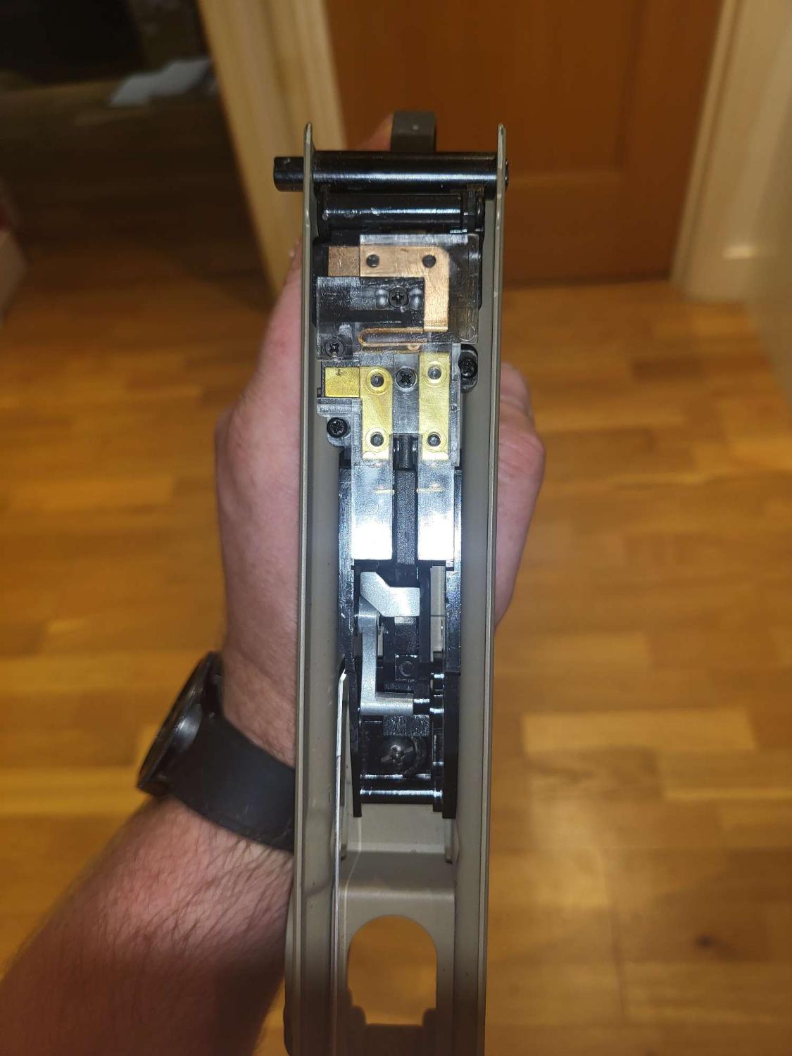

I actually have one on my desk in front of me - belongs to my neighbour after I replaced the one in his L85. I still scratch my head at the mechanics of it - some very clever people at ICS - just wish they used materials other than ABS and potmetal to put it together.
If you need me to pull it apart for pictures, let me know.

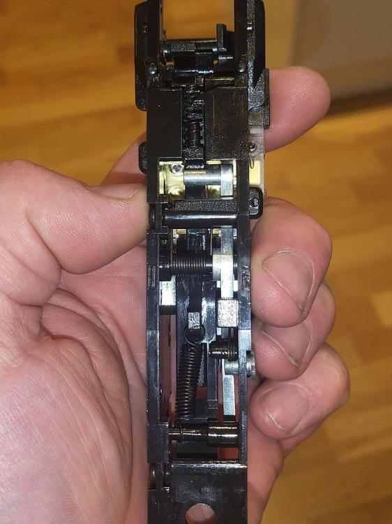

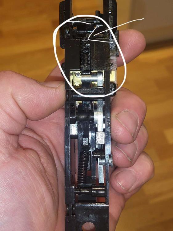

There definitely is something broken, and it’ll be a little tab on the bottom of the box at the front by the trigger.  This exact thing happened to mine, but I was fortunate enough to see the bit of plastic fall out when I got frustrated and took it all apart.
I bought a new switch assembly and did a straight swap and all was solved.
Edited by Duff Beer
Added photo for clarity

The system they use is actually very clever. It's actually a mechanical mosfet as it's very effective at protecting trigger contacts.

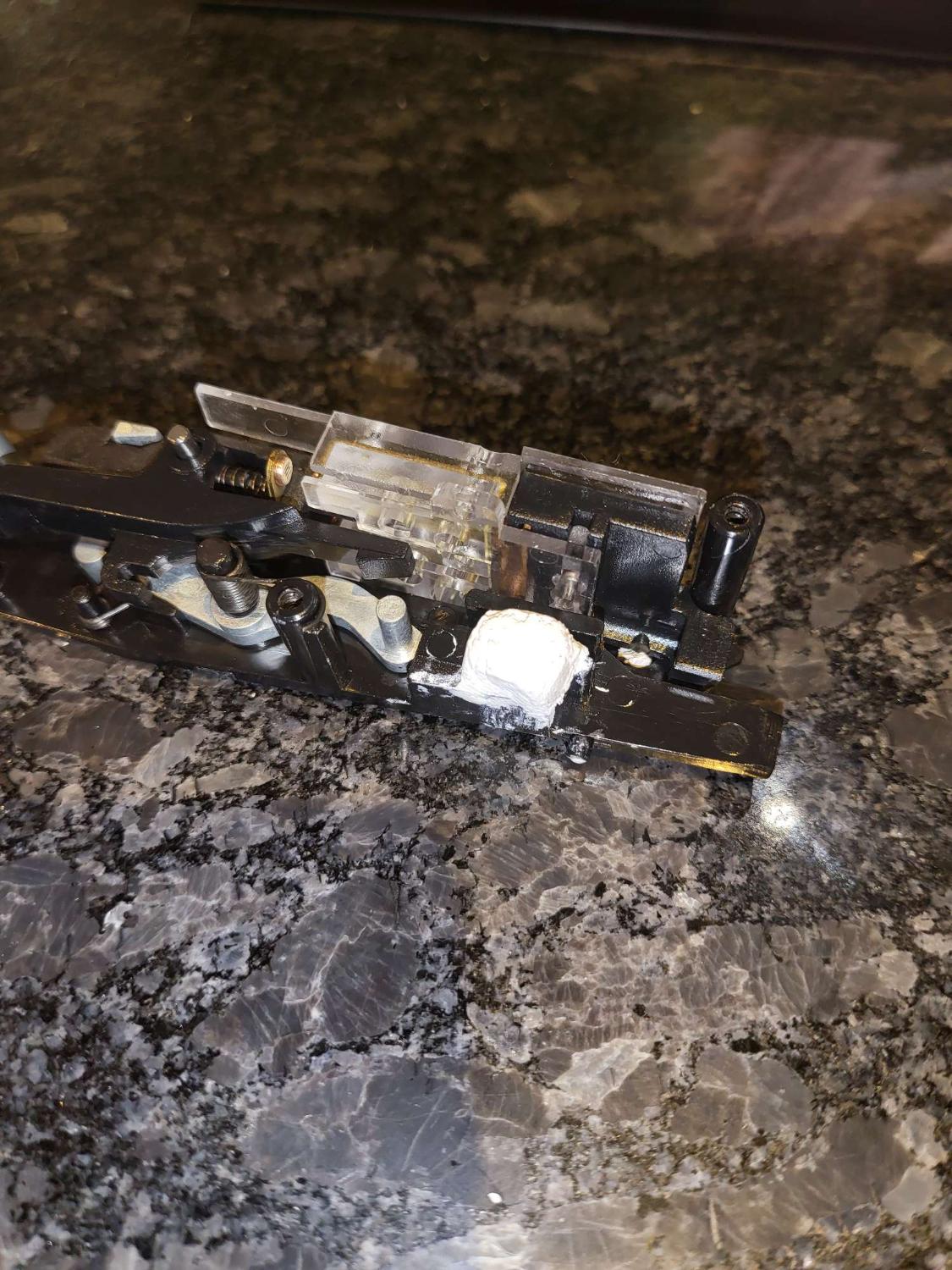

Well, new unit arrived and fitted - comparing the two it all makes sense now.  Apart from me not really knowing how that spring does its job, but never mind.
What I'm also now thinking, if I can undo the 5 screws on one side, could that plastic wall be reconstructed?  Or will all manner of springs and wizardry come flying out?

Looking at it a bit more, there is sod all material there forming the tunnel for the slider and holding that spring back. I'm wondering, if you can't remove the side panel, if I can just put the slider back in without the spring, build up some material in a way that the slider can still slide, then get the spring back in.
Any suggestions on the best thing to use to build up the missing piece of plastic?

Right  -taking that side plate off is both easy and undramatic and allows easy access to that bit that needs rebuilding.
Is this something JB Weld can handle?  Or is the plastic not likely to bond/take the strain of the spring?

Whelp.... JB weld has arrived, a nice lump has been applied to the affected area.  Little mi I dremel is coming tomorrow for me to sand it into shape l.  I'll then see about reinforcing the area once the side panel has been refixed.
