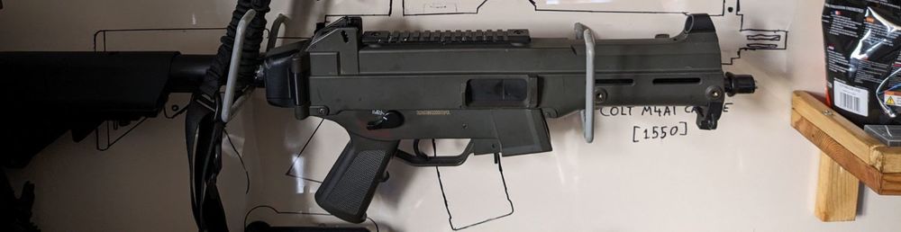

My boy has bought himself an m89 ump45 from DE and only being little (he's 12 but a small 12) and the stock on his gnu seems a bit too long.
Anyone ever shortened a stock?
It's the folding type...

I'm thinking I might be able to cut the butt plate off and reattach a bit further forward. Hmmm.. I can hear the a team music coming on....😂😂

Ahaaaa. Apparently there's a 3d printed doodad that allows you to fit an m4 stock to the hinge....might go looking for one of those.....

Well, as i cant stand threads that just die off and no one knows what happened.....this happened....
I bought the M4 conversion piece (aliexpress, was about £8 and is 3d printed) and fitted it. The M4 tube mounting screw was about 10mm too long but an M6 nut and a couple of washers and jobs a good un.
While i was doing that, i did actually cut his original stock down and with some M4 countersunk bolts, a bit of plate and some swearing, i managed to cut about 12cm off and remount the shoulder part.
I'll get some pics tonight when i get home from work but he's a happy chap again. So happy that he bought an MP5.  KIDS!!!!!
