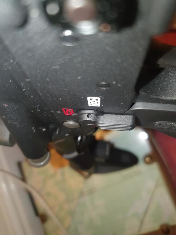

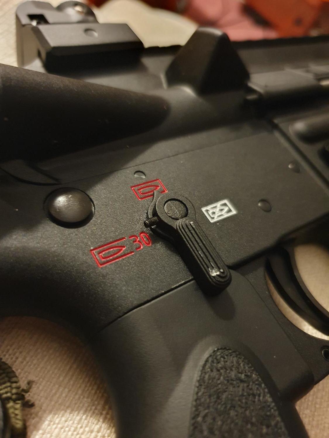

The_Roach Posted December 11, 2023 Posted December 11, 2023 (edited) Took the bad boy for its first outing. Chrono clocked at 320fps with 0.30g and I was enjoying decent, reliable, accurate firing first. As the weather degraded with heavy rains and the mags were in the cold, performance started degrading too. Inconsistent shots, a dry fire every so often, maybe just due to brand new "stiff" mags. The bolt didn't always lock back on an empty mag. However, you can hear the difference between a dry fire and an actual shot, prompting a mag change. The range was underwhelming. I might have to spend more time fiddling with the hop-up but at some point I considered feeding 0.20g to the beast. Everything else worked fine except for a runaway burst when I tried to mag dump my last rounds and it dried fired while discharging a full gas mag. The bolt literally froze. Finally, how the hell did *this* happen ? And how do I fix it ? Even my tiniest Allen key (0.7 mm) is too big for the hex recess at one end ? Edited December 11, 2023 by The_Roach
CrackCommandoUnit1972 Posted December 11, 2023 Posted December 11, 2023 320fps with .3g bbs? Isn't that way too hot for most sights or were you using it as a DMR? Looks like you need a bit of thread lock on that screw. Although i dont know how you are gonna get it back in.
RostokMcSpoons Posted December 11, 2023 Author Posted December 11, 2023 I didn't bother taking my 416 to the last game day, at around 3°C I thought the chances of having it work reliably were extremely low. All the stuff you experienced sounds like low temperature problems that would have been suffered by any GBBR, with the possible exception of an MWS
