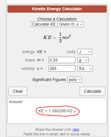

Why change it? 305fps on a .25 is exactly where you want it, surely? Much more and it'll be over the limit of 1.14J

This is the one you want to use for CQB right? It's pretty much spot on 340FPS/1.08J. I'd leave it alone!

My local cqb site has a limit of 330 fps with .20 so 1j or 295fps with .25 so I need to come down a bit but will be short stroking 4 teeth as this is solely a semi auto build which is why I wanted to know roughly what spring I'm at so I can take the roughly 60 fps I lose from the short stroking and add that with a spring upgrade to bring me between 320 and 330 on .20
