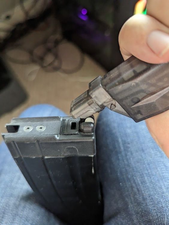

I've just bought an Umarex HK416 GBBR.  My first gas rifle, but I've had a couple of gas pistols already.
I've worked out how to load the pistol mags pretty quickly, but the rifle mag is.... harder.
I've got a cheapo M4 mag speed loader that's pretty rubbish... pressing the big button rarely outputs a BB.  Might as well go in the bin.
So, that leaves me with a couple of little pistol speed loaders.   And one adapter.
It's all a bit like herding cats
Not using the adapter means trying to use finger tips to help funnel the BBs in one at a time against decent spring pressure and through the resistant rubber lips.
Using the adapter, I found I can do it a little easier by tilting the loader at an angle.
Obviously I have it pushed firmly onto the lips ('yub yub'), I left a gap in the photo so you can see 'em.
With this approach quite a few of the BBs will go in, but there will inevitably be some more that manage to escape and ping off into the four corners of the room, or get jammed up without going in ('hurrr hurrrr'), or the adapter gets forced off (will superglue it on, if this is the best approach).
:Sigh:
Is there a trick to it, or an adapter I can buy?   I've seen people use Odin speedloaders and I'm aware there are adapters for those, but Odin's seem to be hard to source... and it's a bit 'overkill' when I have this 1 (one, count it) magazine that I need to fill ;)   (That's "at the moment".  Assuming I enjoy skirmishing with it then I'll buy at least a couple more)
Or do I just have to accept they're fiddly little bastards, and loading mid-battle just ain't going to work?
Any thoughts, as always, much appreciated!

That's pretty much it, i find that using my thumb on the hand holding the mag to press the adapter down does the job.
Needs to be angled at about 45 degrees, but this works well for me . I find that 8 pumps of the loader is 28 BB's which is what I load my mags too rather than ram them full. I take 5 mags and the speedloader out for a game and refill empty mags during any lull. My WE based L119's get a good 2 BB loads for 1 gas fill .
Edited by Nick G
Ok, thanks Nick, I guess a bit of practice and I'll be good.  I'll superglue the adapter on and get another of those speedloaders for my belt pouch.
I stopped using the little adapter when loading my mp9. The follower can be locked to the bottom of the channel and then just pop the feedlip of loader to the front face of the magazines lip. Admittedly if the follower cant be locked back in your mags that's going to make things a lot harder.

Yeah, that's the case with these VFC 416 mags, the feed lips are the only way in or out.

Not a daft question at all. Loading GBBR mags can be something of a dark art. Using a pistol loader with adapter is good. The TM M4 mag-style loader has the adapter attached, and is what I used for my MWS for a while. With either of these options, as you've discovered, the angle you hold the speedloader is key.
Now I use an Airtac adapter for my Odin and it's a gamechanger. Literally three turns and the mag's full. I know Odin's aren't cheap but it's definitely up there as the best £50 I've spent for airsoft.
Looking at the Airtac site, they do an adapter for VFC M4 GBBR mags too, so one to maybe bear in mind?
